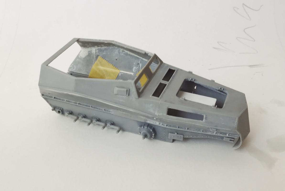

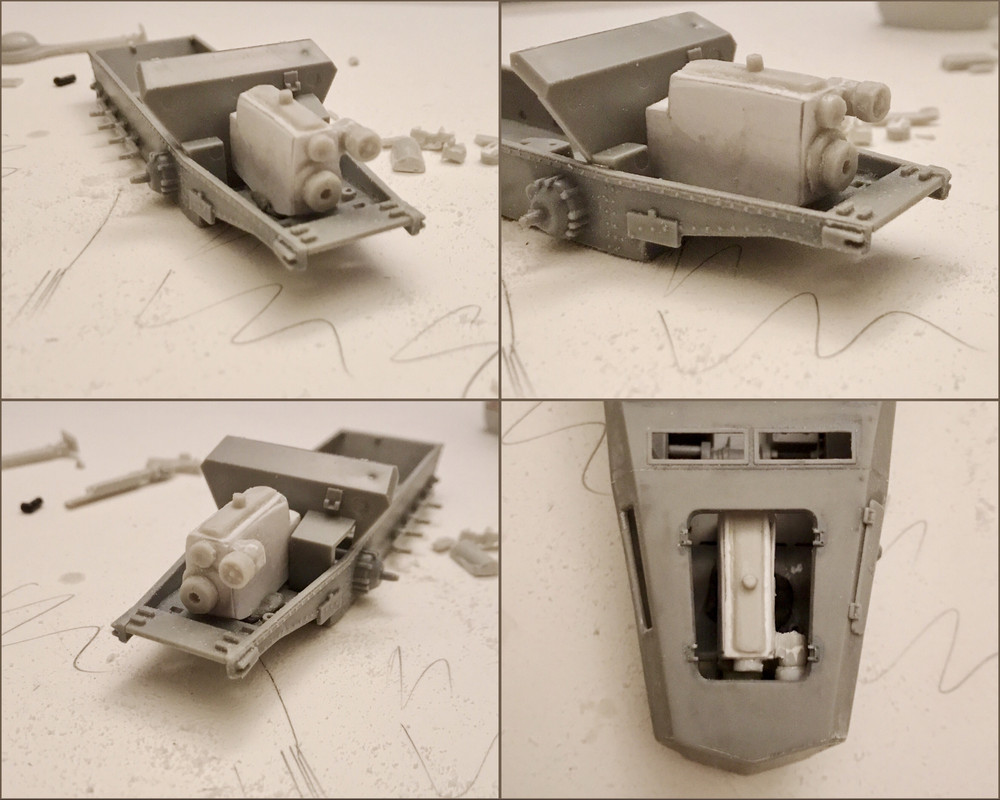

Thank you, Carlos and Ken, sincerely. I had to deal with the design effect of hard versus soft edges. I usually make a paper mock-up first, but this time I sized the plastic sheet to the kneaded eraser mock-up, which meant adjusting down the dimensions after I cut the basic structure of the engine. The hardest part wasn’t the part at the back, although that required interior tabs to lock everything in place; it was fitting the base into the different angles of shielding steel underneath the engine. I will probably add a slightly smaller piece that will act as a support underneath; in order to make the transition between angles stronger and more solid—basically I need to make three engine mounts pretty much the same way as the original! Two left and right in front and one in the back at the firewall itself.
GENERAL NOTES
I have always covered a cutting board with a sheet of Bristol board or any fairly flexible not too overly coated cardboard to avoid what happens when glue spills on the painted surface of a cutting board. I like using a cutting board for cutting only, really. I recently found my old cutting board which I have had for years, and the only marks are the slices from knife cuts. I recently saw a fella post his cutting board with the surface obliterated by a liberal splashing of Tamiya Extra Thin. Take it from me: a free public service announcement—when you glue drop a clean sheet of white Bristol Board on top of your cutting board. Cheers.

... all I did last night was lightly sand the sides.

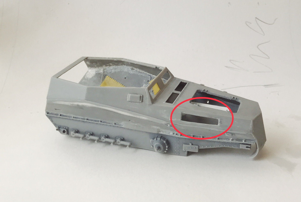

I am debating to open the other side panel, too.

Bruce, with as much work as you’re putting into the motor and plumbing I’d say definitely open up that panel. As long as it fits with your vision.

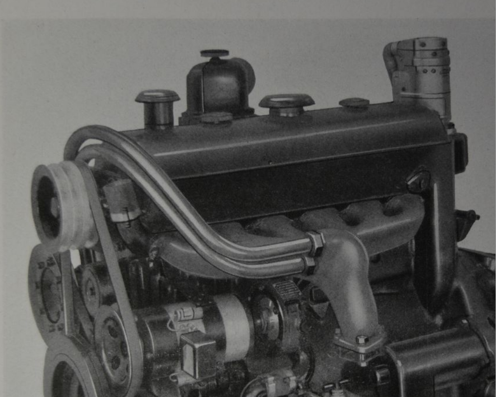

Bench time! Practically by candlelight, which is how I like it. Grind, cut, grind. Grind... cut... grind. I still have the inlet manifolds to build, and I located the small flywheel too close to the manifold on the left (it should be much lower, just underneath the manifold). There are also a couple of "heater tubes" which run from the left manifold and around the engine to the other side. I am not sure if these really are heater tubes; that was just something I read somewhere.
"heater tubes"

Bruce, that is tremendous progress and impressive work. I third the motion of opening thew side panel s that engine can be seen. After all, you are putting a remarkable amount of detail work into that; it deserves and demands to be seen.
