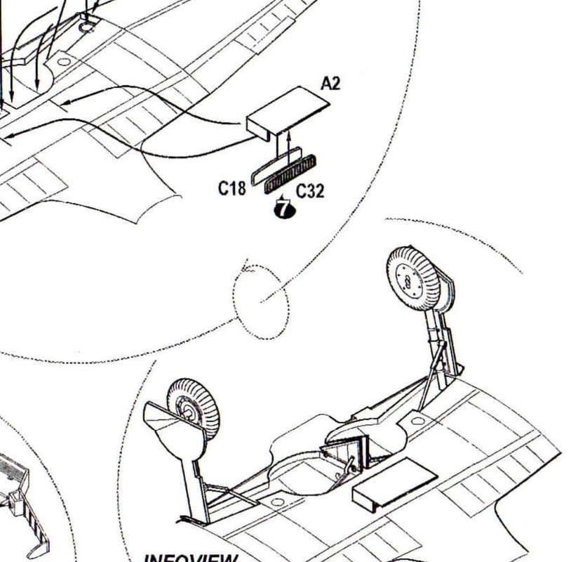

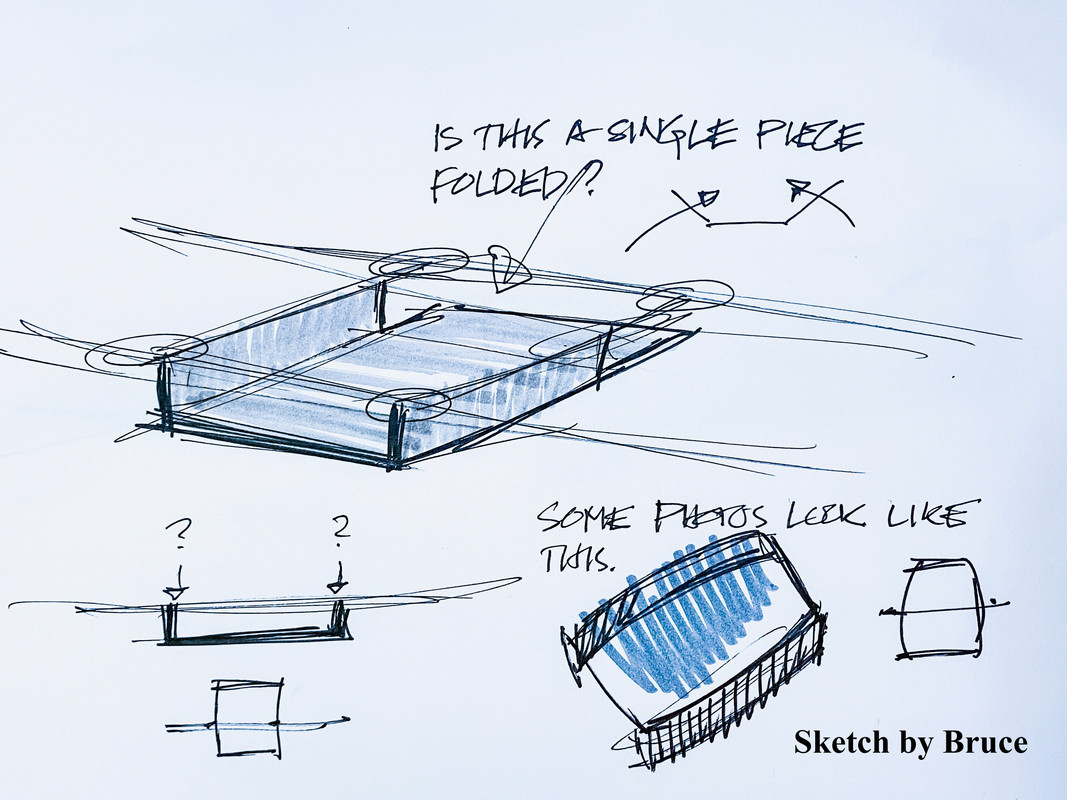

Marius and I are making joint decisions using WhatsApp; my local time is 1:00 pm, he is 9 hours ahead. First he begins with a photo to initiate a discussion; we are both well aware of the Lindberg’s limitations of detail. These are considerable. Some are alright; necessary for the scale and in keeping with the maker’s aspirations: easy to build, easy to build.
Reference photo by Marius as a back and forth discussion begins! We send photos back and forth.
Marius sends instructions from a Special Hobby kit:
Sketch by Marius:
Sketch by me:

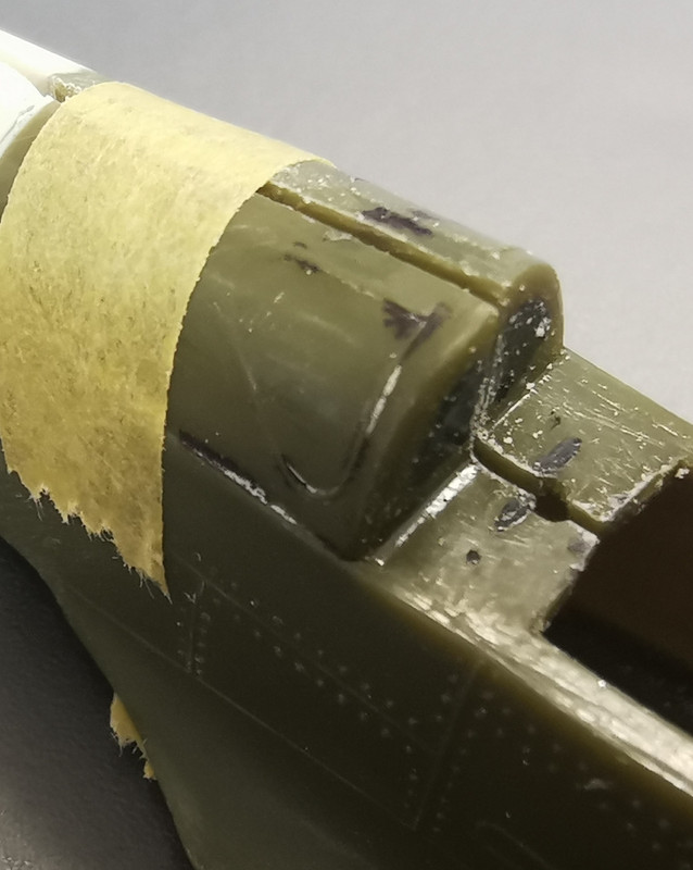

I am a bit behind for a lot of reasons. Nevertheless I am currently focusing on my biggest concern after the success of correcting the fuselage shape: small windows behind cockpit!

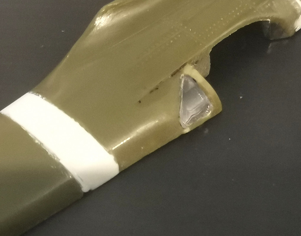

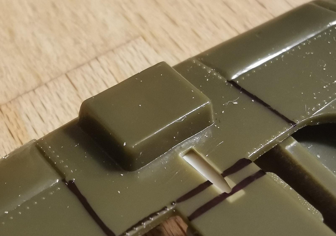

You know the fuselage halves came with no openings for side windows, only a surface in the green plastic is clearly marked as "window".

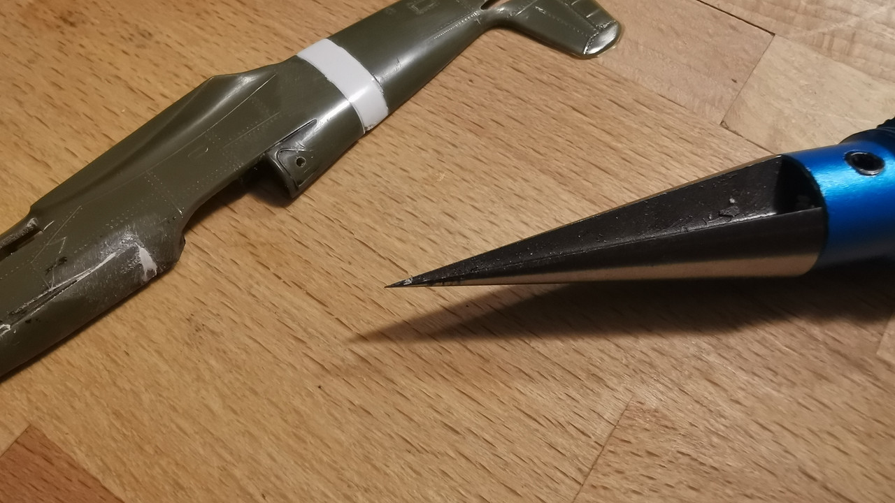

I tried to cut it out by using drills, reamer drill (?), files, scalpels and glas-fibre pen.
That was successful, but the small remaining plastic frame is now very week (see white decoloration of material)

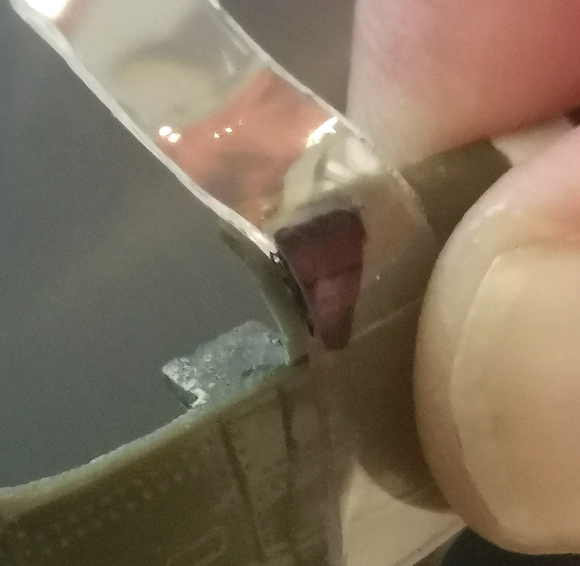

Now how to get a window matching all contours (all directions)? First trial with PS clear material with thickness of 1 mm. Used 1 mm to be able to sand it into final shape after glueing in.
It was a success regarding feasibility unfortunately the window shape is incorrect.
