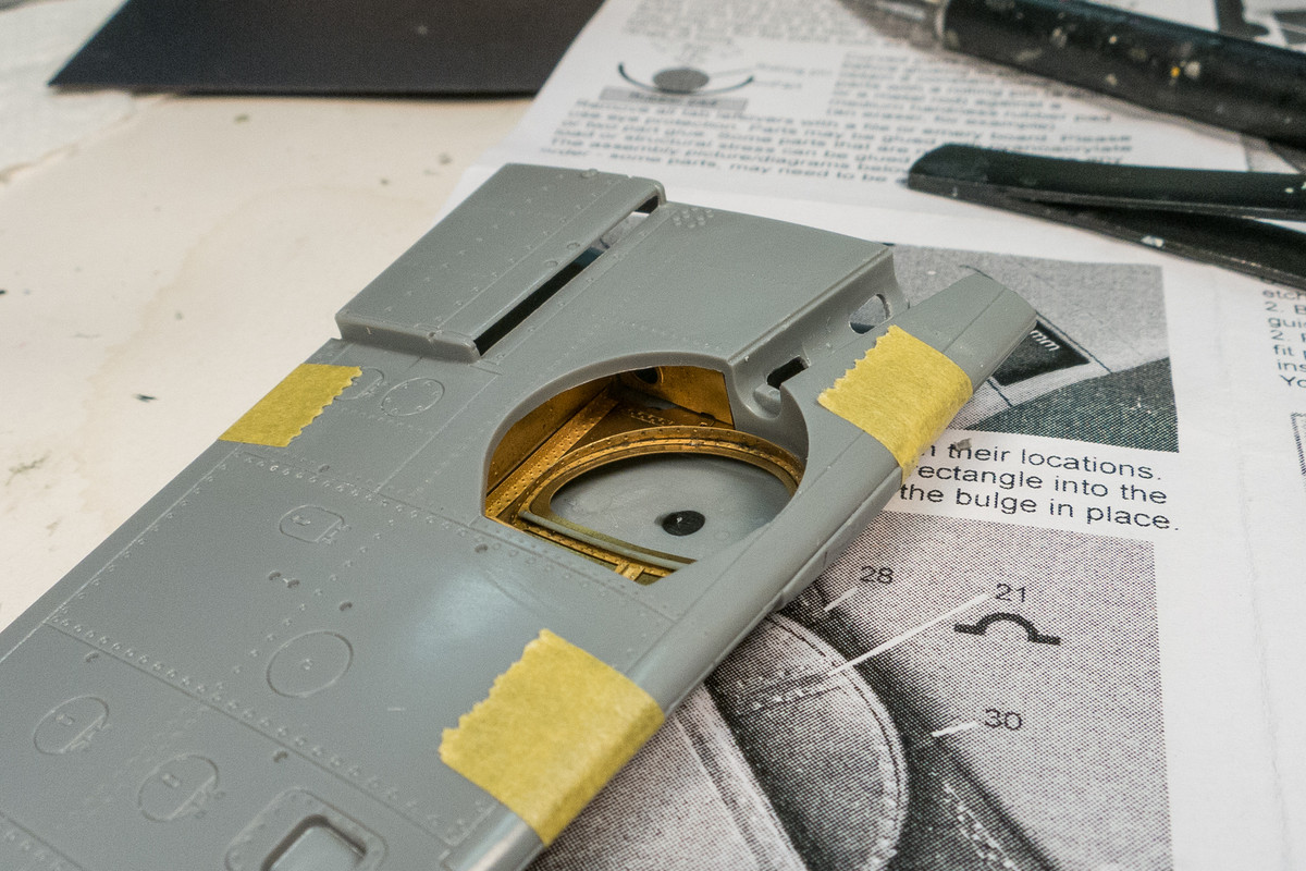

After filling the ejector pin marks on the inside, the wing bulges have been glued into place.
The wheel well roof sheets were just placed for this photo but got glued into place soon after.

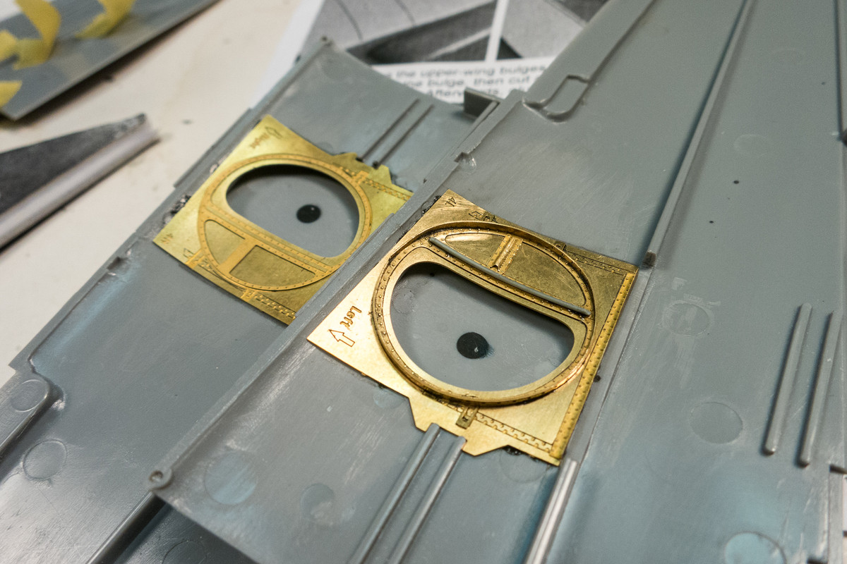

The wheel parts including the roof parts have layers of photoetch to give some 3D depth to the assembly but first I wanted to check the fit of the wheel well walls against the removals that I performed earlier.

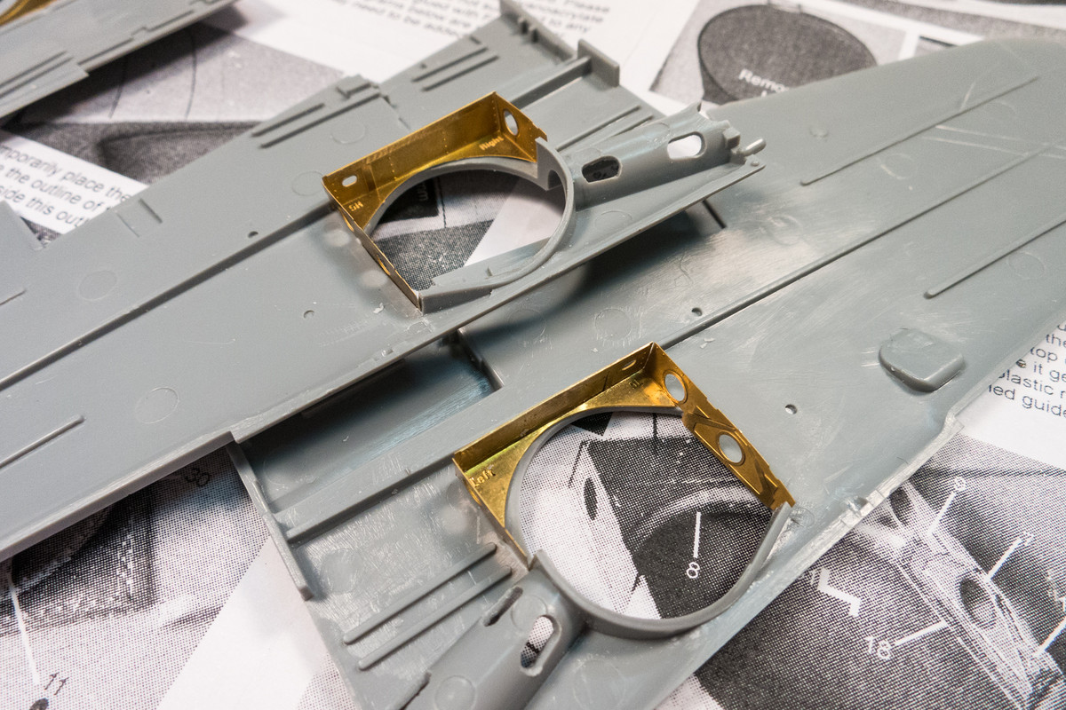

These dropped in fairly easily into the wing bottoms, with only some minor adjustments to the removal areas to accommodate the walls.
With the wheel well walls simply resting in place without glue, I check the fit.
I didn't notice any problems so I can continue adding stacking photoetch to build up the wheel wells.

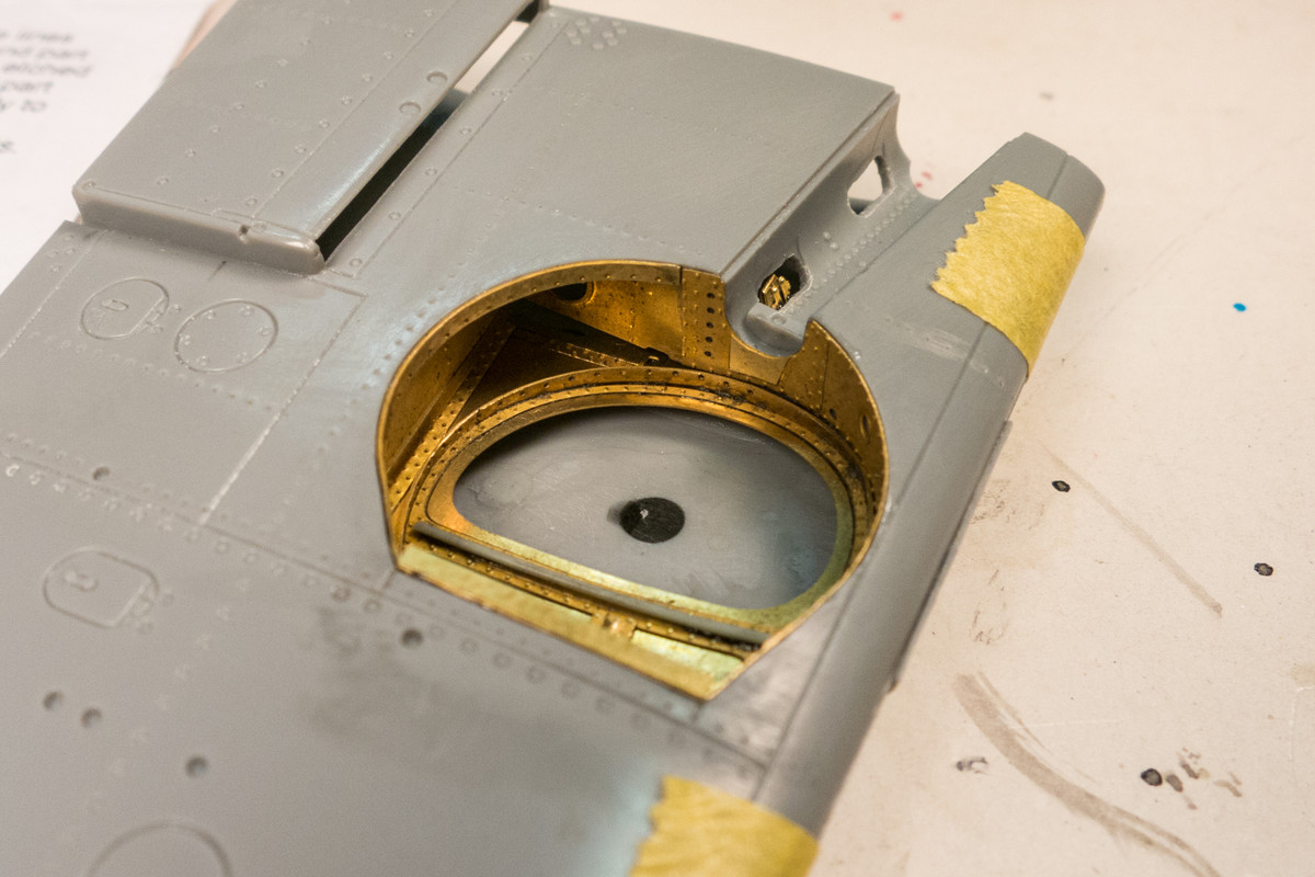

My work schedule is a lot more hectic right now and I don't have as much time after work as I used to. So progress will be spotty during the weekdays, I imagine. Started building up the detail on the roof of the wheel wells. I worked on one side so that I can show the comparison between the two.
There is much more detail to be added to the wheel well walls, which I will get to soon. But overall, this PE addition is going fairly smoothly. Everything seems to fit just where it is supposed to. I replaced one PE stringer with a piece of stretched sprue because I couldn't get the metal part to bend to the contour of the wheel well roof.

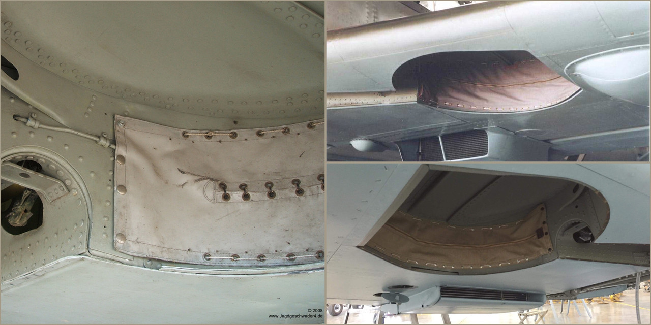

TGIF. Quick question—do all 109s feature leather wheel well covers? When I was researching a G Series these images popped up—and earlier today I remembered that there was a 1/24 109 that I was following that included these, walk around restoration images—
I have to add to the chorus of approvals for your work, John. The handling of the fine PE is top notch—and your removal of inner wing material was done with such superb finesse and control!
Re: 1/32 Hasegawa Bf109K-4 Weisse 8
Thanks guys! I hope you guys had a wonderful week! To answer Bruce's question about fabric covers one 109's... I'm not sure. I know some had it but the K-series, as far as I know, did not.

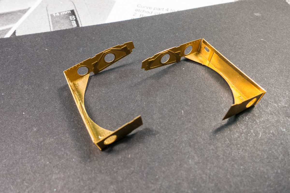

I spent today building up the detail on the port wheel well walls. There are lots of little parts with intricate bending involved so it is slow going but the fit is good and I encountered no headaches along the way.

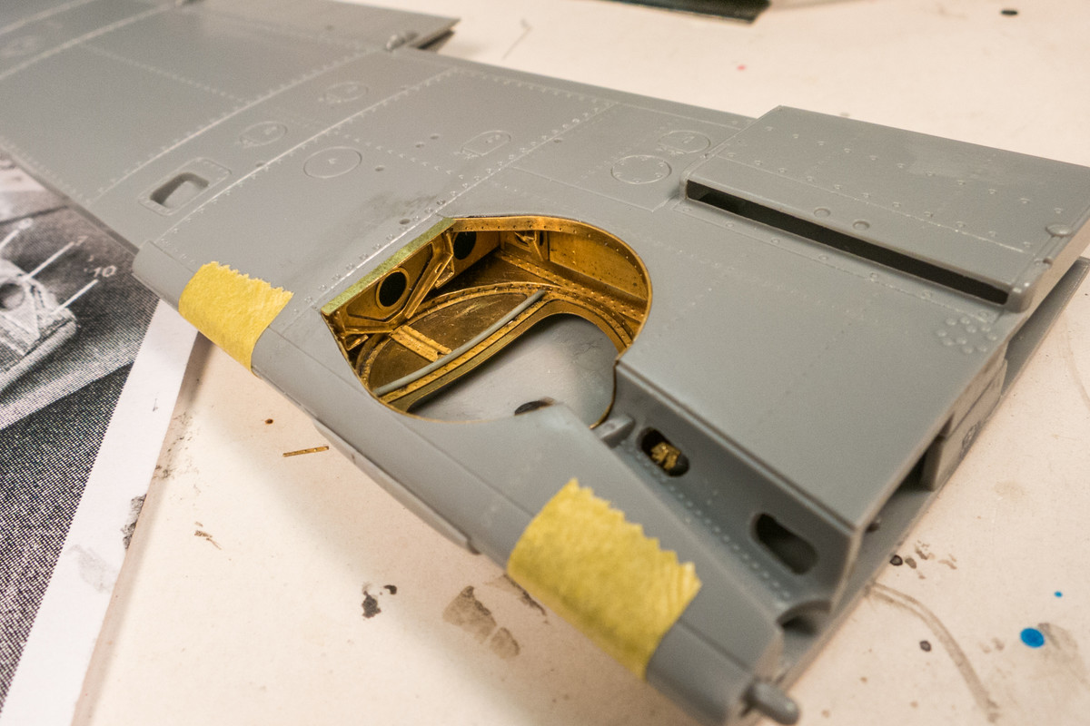

Here's what the wheel wells look like from the outside. Once I finish the other side, I may elect to prime/paint the wheel well area before gluing the wing halves together.
