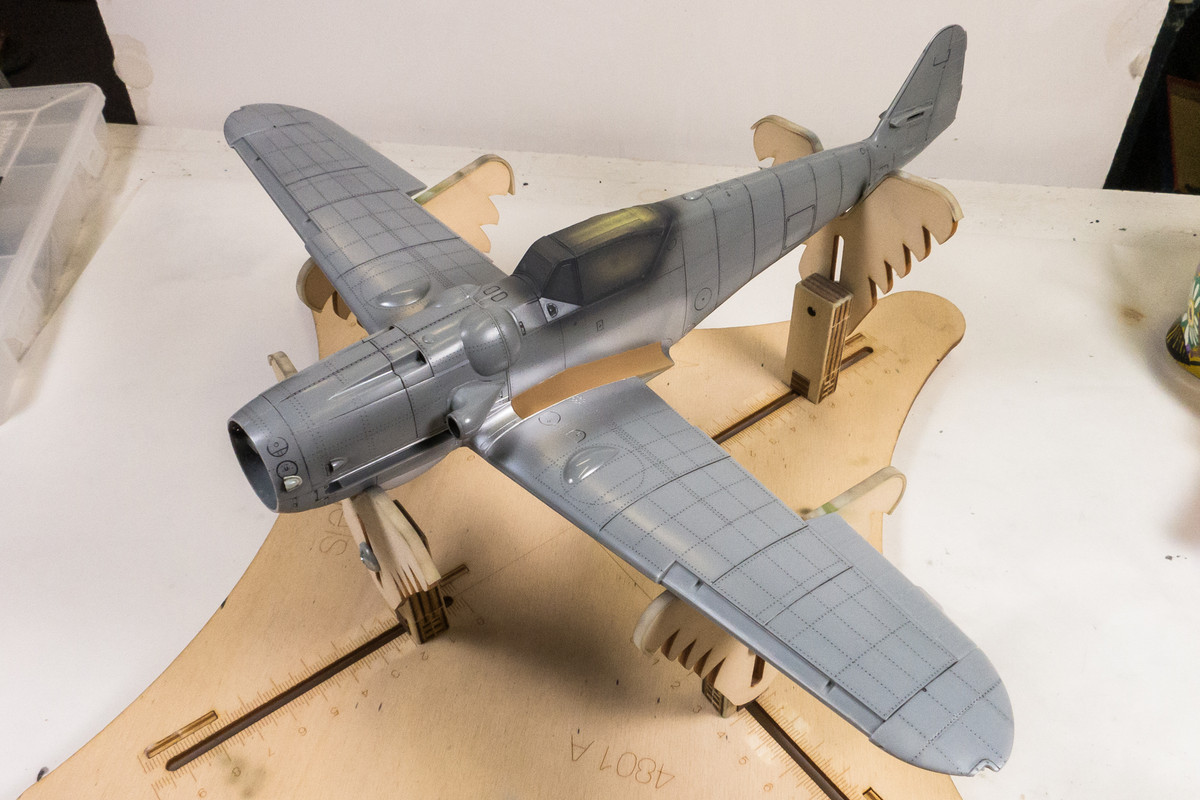

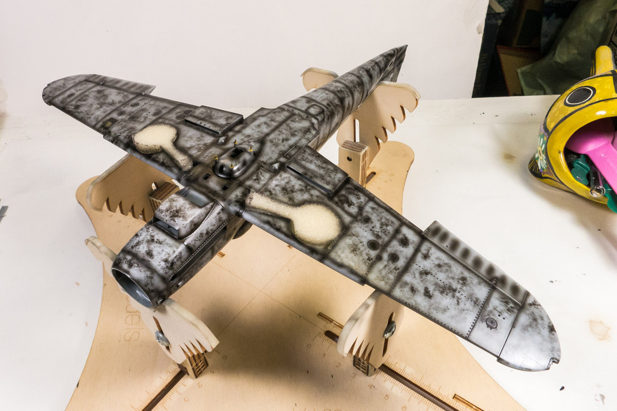

Back to work on the G-14! In preparation for painting, I've treated the wing root fairing in a sandy color as they were commonly made of wood. I've sprayed the wing root area with hairspray to do some chipping after the base camo colors are established. I've had some difficulty using this technique on AK Real Colors paints so we'll just have to see how it goes. If I don't get any chipping at this stage, that's fine as the white will cover much of this anyway.

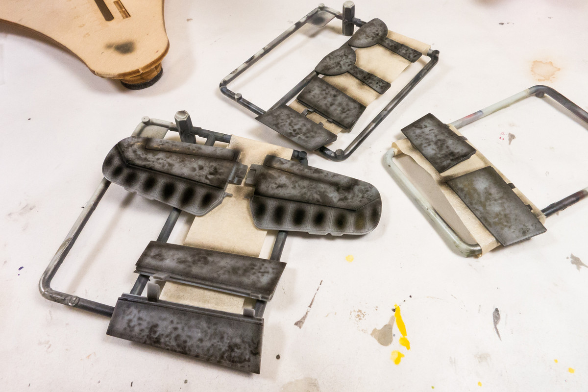

While the hairspray dries, I'm going to preshade the other external components.

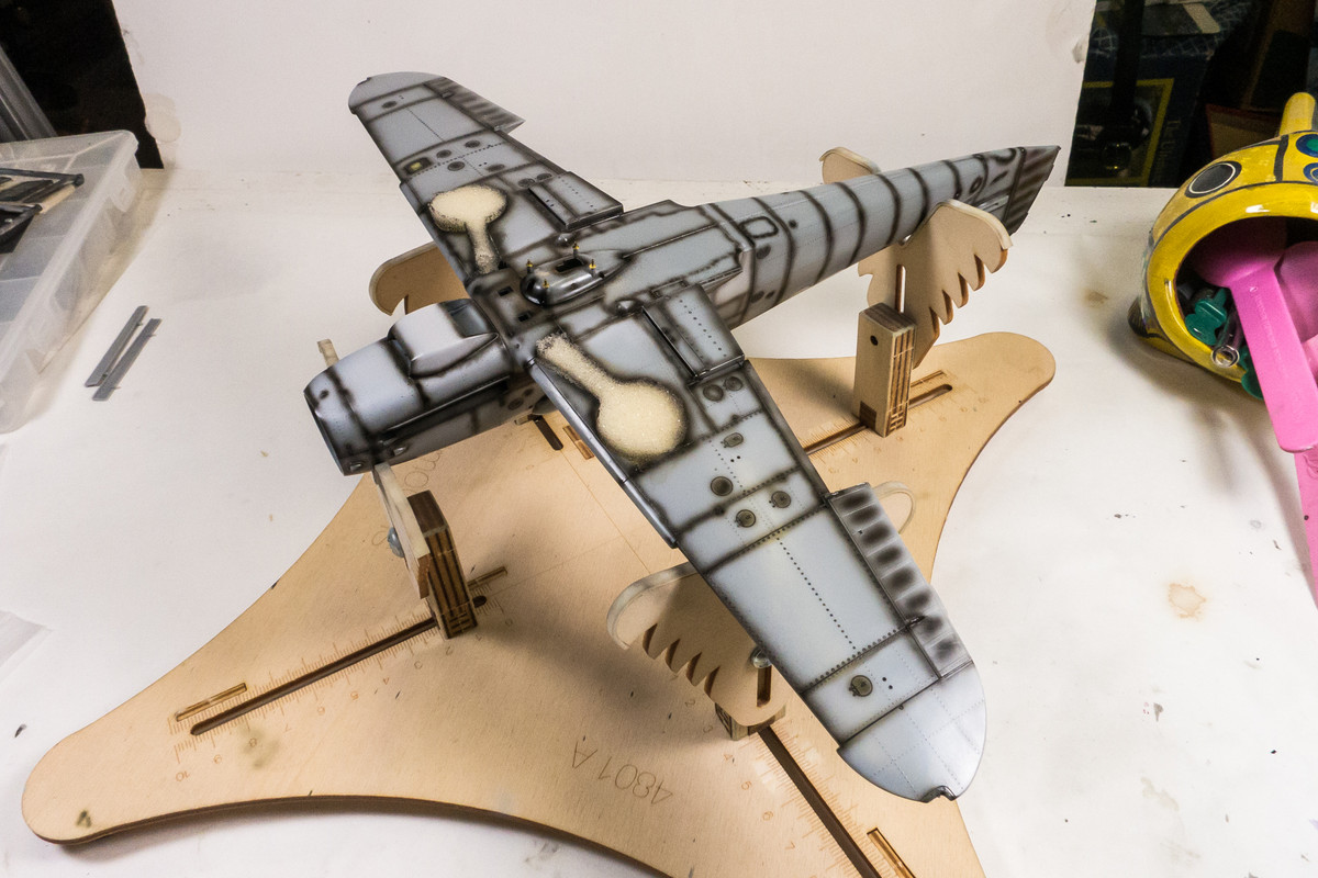

All of the preshading is black. First, the panel lines.

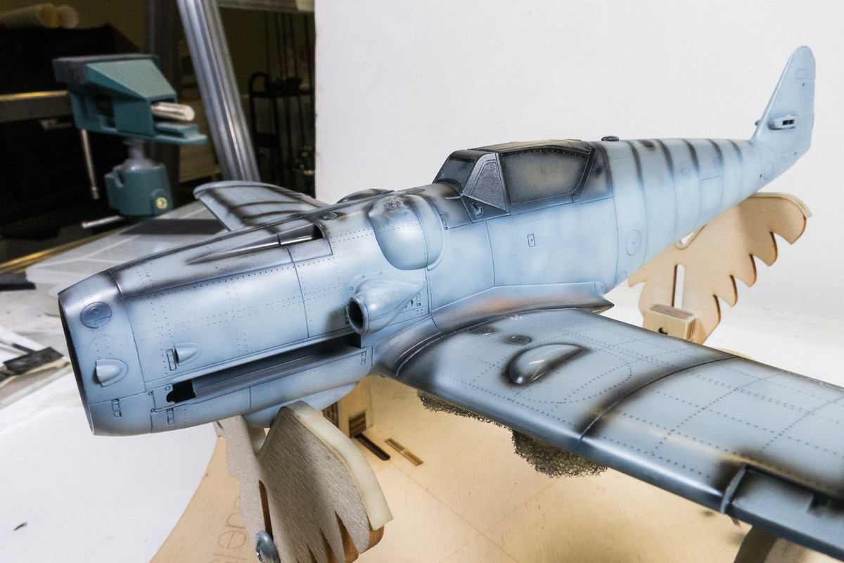

Next is the mottle to establish some tonal variation. I've decided not to mottle the upper surfaces as the white wash is going to cover it anyway. There are other ways I can establish some tonal variation in post painting.

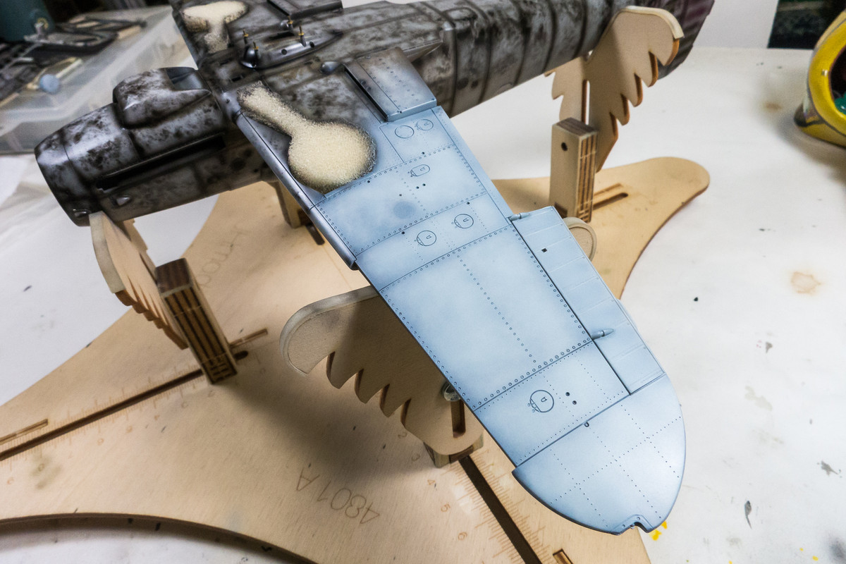

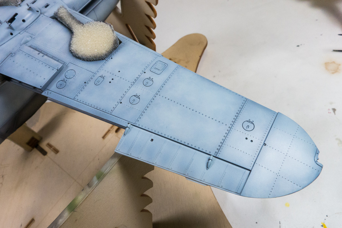

The first color to applied is RLM 76 Light Blue. I am using the AK Real Color Version 2 of this shade, thinned with Tamiya Acrylic Thinner thinned with 2 parts thinner for 1 part paint. Thin mixes are key using this preshading technique.
The color is built up slowly, layer by layer, dialing in the amount of preshading that is desired.

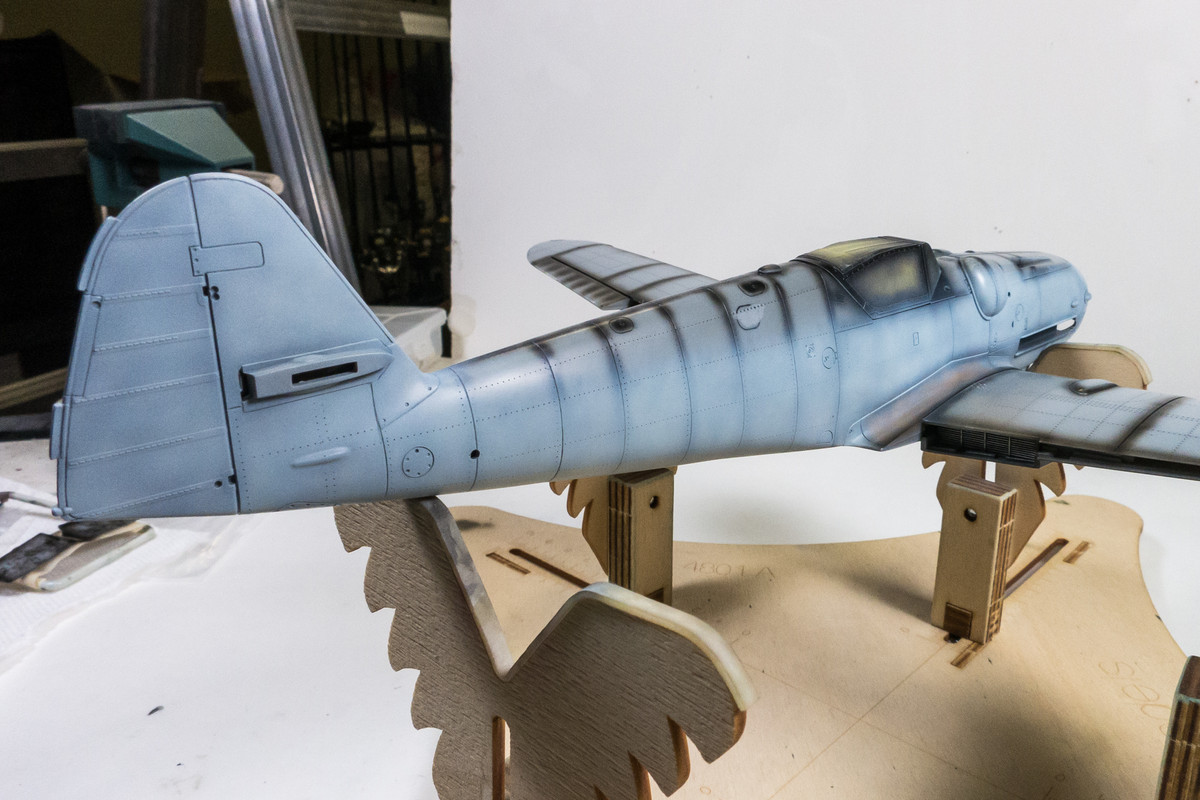

The light blue is extended up onto the fuselage sides.

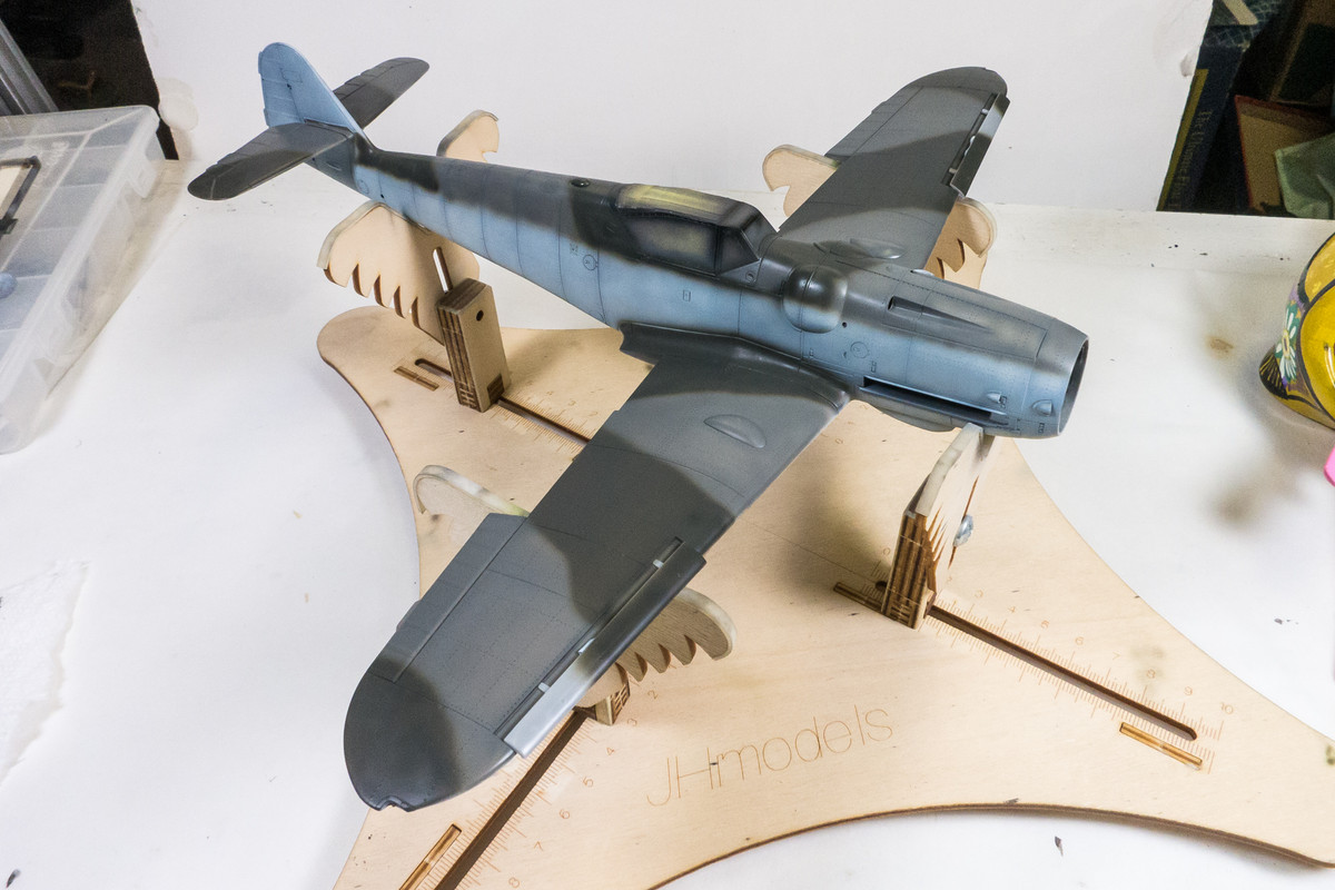

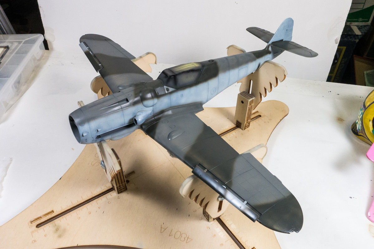

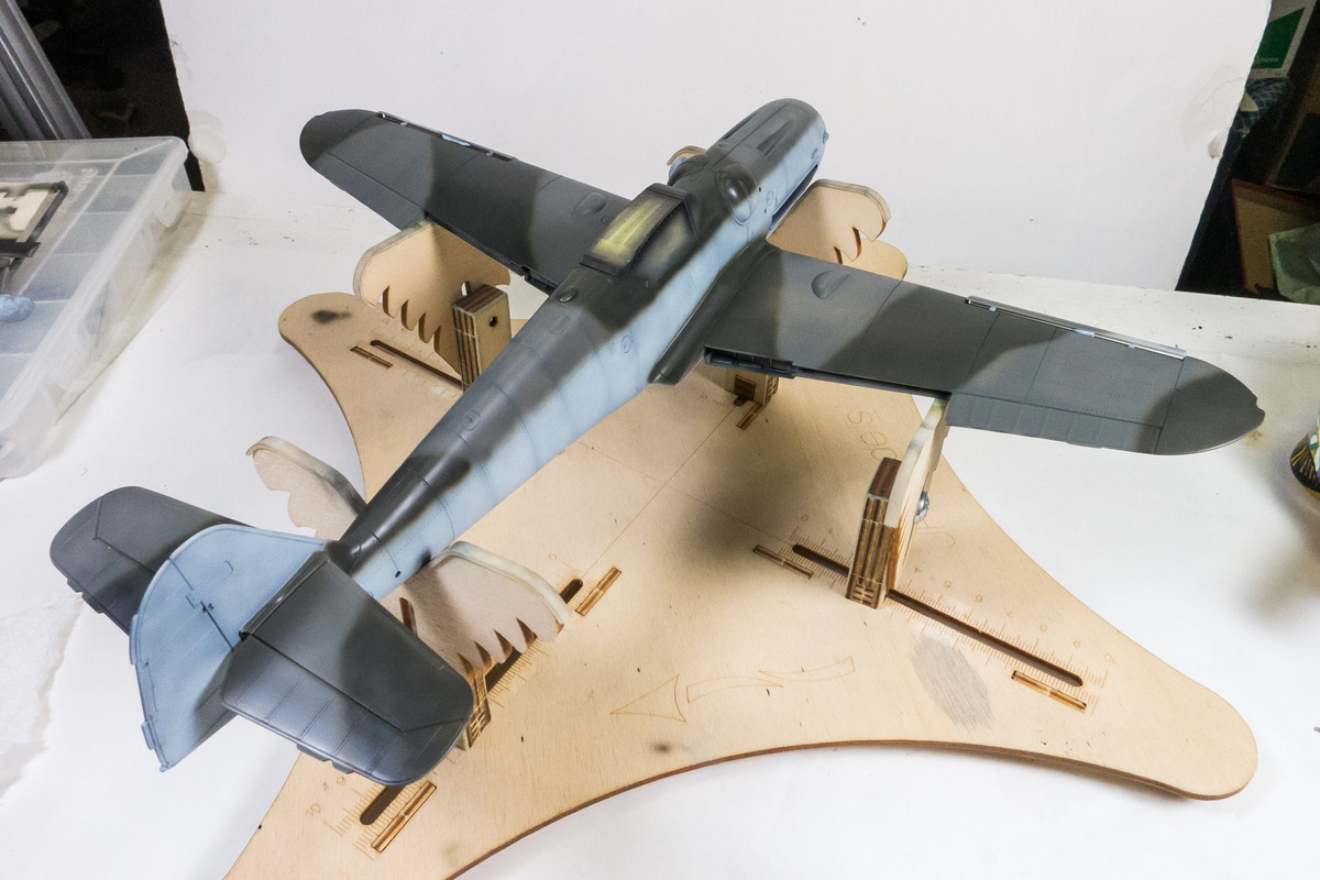

After the light blue is finished, the upper camo is painted. Again, I'm using AK Real Colors versions of RLM 74 and RLM 75 for the upper camo. Like the RLM 76, the RLM 75 is thinned 2:1. For whatever reason, the RLM 74 worked better with an even thinner 3:1 mix.
During painting, I've discovered that some of the wing joints and vertical tail joint have cracked. So I've re-glued them and will perform some clean-up before proceeding. Next will be mottling on the fuselage.

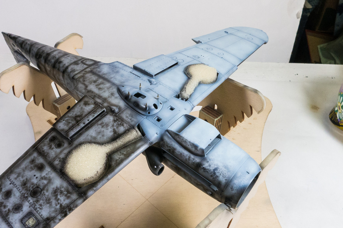

Here is the mottling applied to the fuselage sides.
I did get a little bit of hairspray chipping on the wing roots to materialize.
