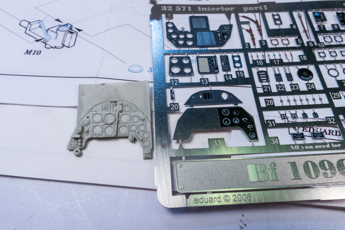

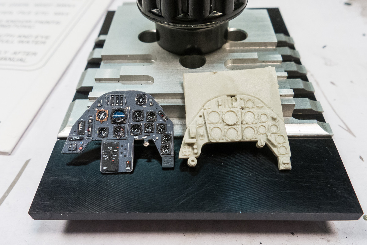

One of the intriguing things (at least for me) how the Eduard instrument panel would compare with the MDC resin. As I was looking at it, I was amazed by the resolution of the color printing. There are painted details on this thing like tiny labels above certain instruments that would be impossible to replicate. And it didn't have that odd fabric texture that you often see on Eduard pre-painted panels. Yes, the color is still off but even that looked better than the obviously purple shade I'm used to getting from Eduard. Since the G-14 is an older kit, the question has to be asked... has Eduard's quality actually declined over the years?
My preferred IP representation is PE face layered with separate instrument bezels backed by a clear acetate with the printed instruments gauges. I also like resin IP faces that you populate with instrument gauge decals. My least favorite has been the all-PE approach due to the reasons stated in the first paragraph. But since this one looked different, I was interested to see what the Eduard IP would look put together.
Due to the number of small parts, the Eduard panel took a few hours to assemble. I used Future as an adhesive, which can be a reluctant glue when you're attaching parts that aren't 100% flat. It's not complete as there are a few switches that I've not glued on yet but it gives us a good look at what the MDC panel is going up against. Obviously, the resin still has the physical advantage of 3D relief but I'm very impressed with the Eduard IP!

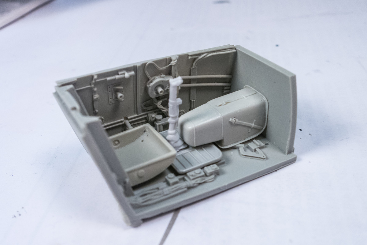

Just starting to fiddle around with the MDC cockpit. The resin here looks excellent. There is just no way that a photoetch set can match the physical oomph of quality resin.

Again that is a gorgeous resin pit! The Eduard PE IP looks good but I think the resin one will look a lot better all painted up in comparison.

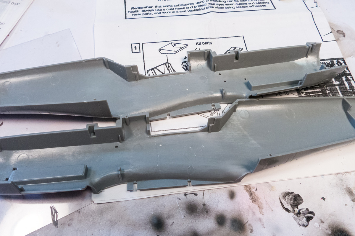

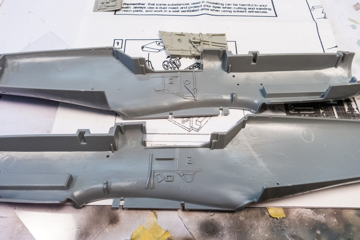

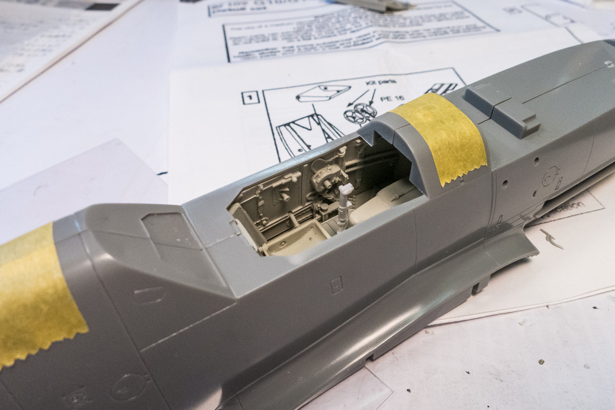

Thanks guys! I played around a little bit more with the MDC cockpit. Just getting a preliminary idea of how it might fit into the fuselage. The molded details on the insides of the kit fuselage needed to be removed before I could start dry-fitting.
The two-page instruction don't say how the cockpit tub fits into the fuselage. It simply shows where the resin sidewalls fit into the fuselage sides. I think the assumption is to glue the sidewalls into the fuselage sides and either trap the cockpit tub between the sidewalls when the fuselage comes together OR push the cockpit tub into position from the bottom after the fuselage is glued together. I'm trying to determine if there is a better way... like gluing the resin sidewalls onto the tub first and then putting the assembled cockpit into position from the bottom opening.
As far as dry-fitting goes, I'm able to fit one sidewall and the tub into the fuselage but having difficult keeping everything together and dry-fitting both sidewalls at the same time. Give it some time... I'll figure it out eventually.
