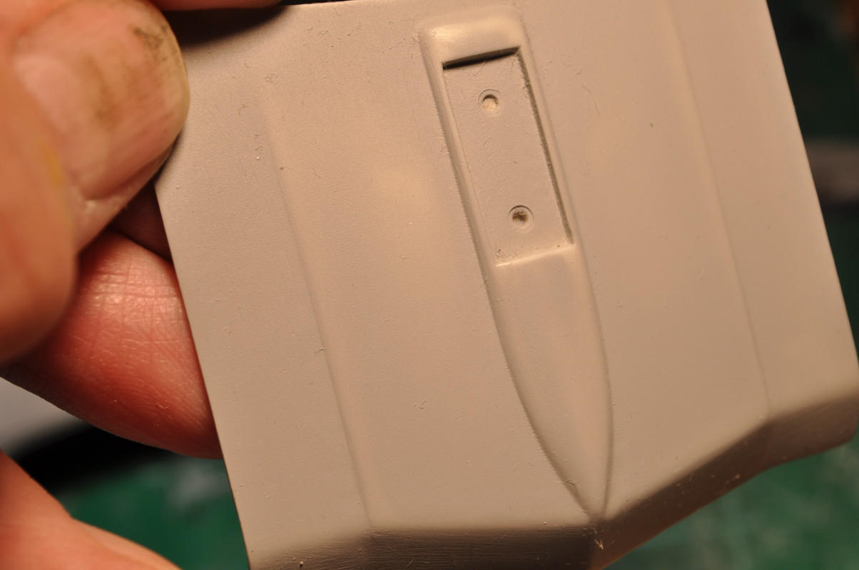

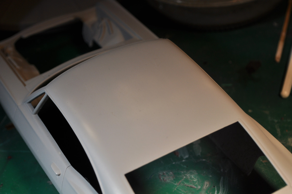

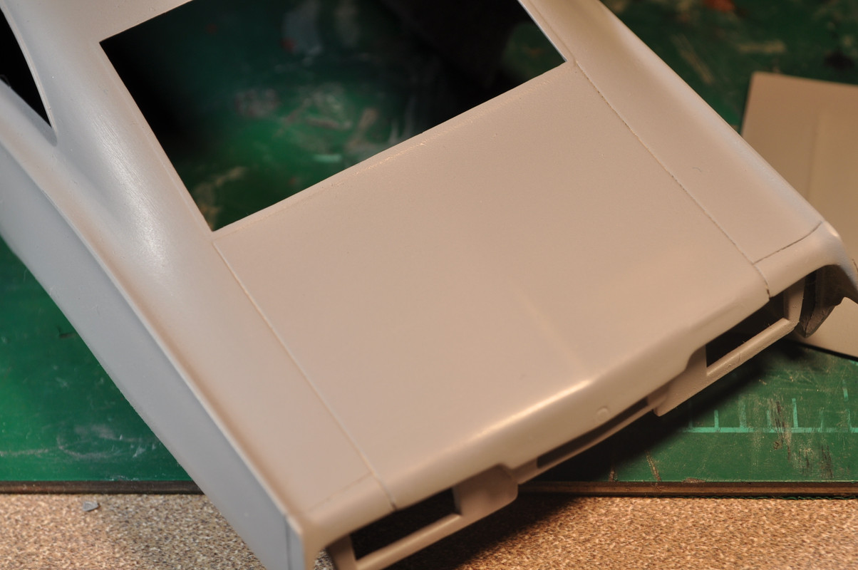

midnightprowler wrote:Looks like some kind of contamination on the plastic. Strip it with yellow can easy off oven cleaner, wash with soap and water then respray. Did you say you polished the bare plastic? Not a good idea. That may be where your contamination came from. Line on the trunk lid is a mold line. Sand it off.
I did polish the plastic. I’ll see what tomorrow brings.

Thanks for the advice, gentlemen! I had used the Novus products on parts of the body and hood. With light sanding, I was able to remove the offending areas and clean them. I did not strip the hood or body...yet. I am pretty happy with the results. I decanted some of the primer and used the airbrush. It was a much smoother coat than from the can.

FWIW, don't polish bare plastic if you're painting. Simply wash in Dawn liquid detergent and water, let dry, do your sanding and defect work then prime and paint.

midnightprowler wrote:FWIW, don't polish bare plastic if you're painting. Simply wash in Dawn liquid detergent and water, let dry, do your sanding and defect work then prime and paint.
Yeah, that seems obvious...now. I went ahead and stripped the hood with 99% ISO, 0000 steel wool and the fine grit sand paper. I believe the body will be okay.
