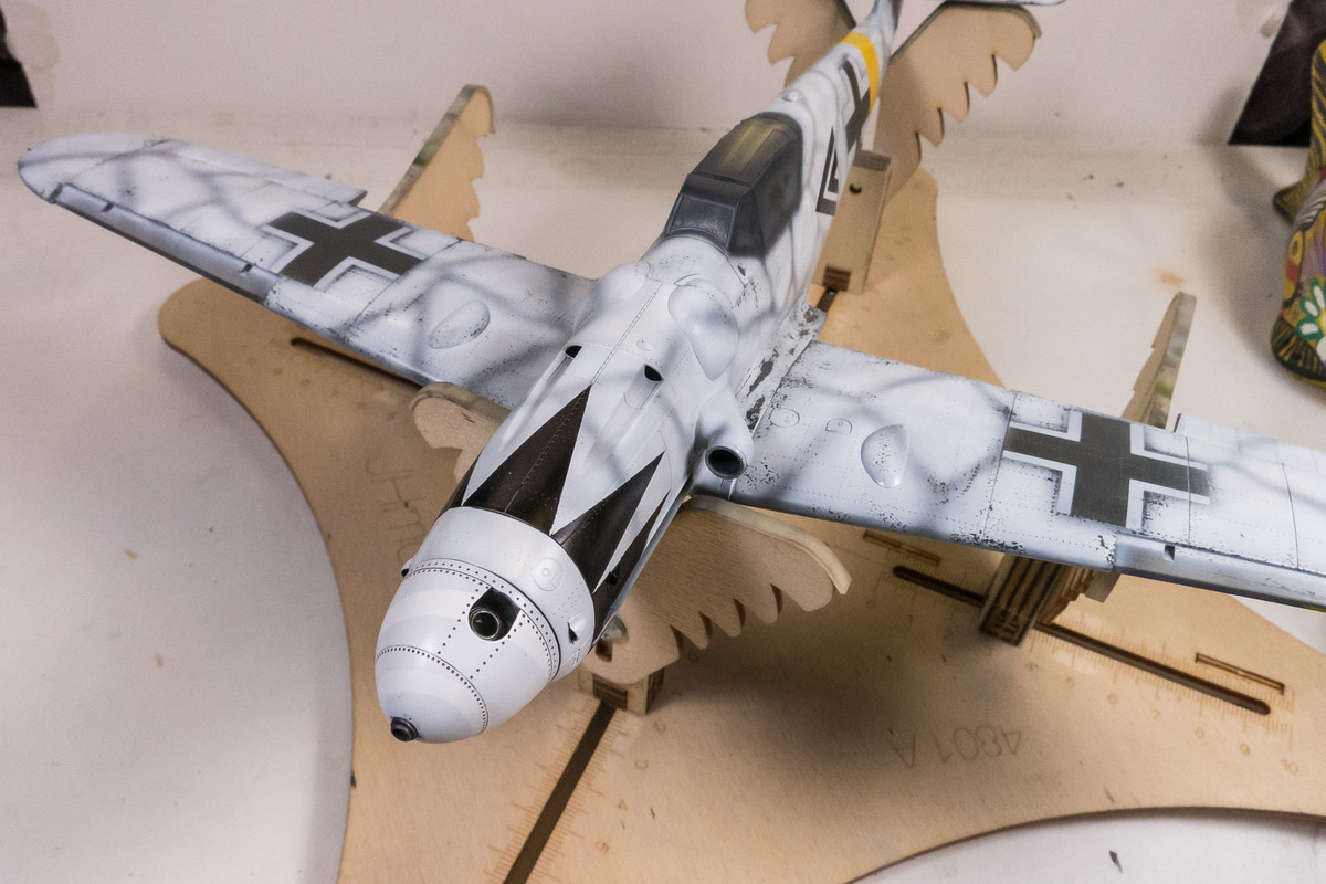

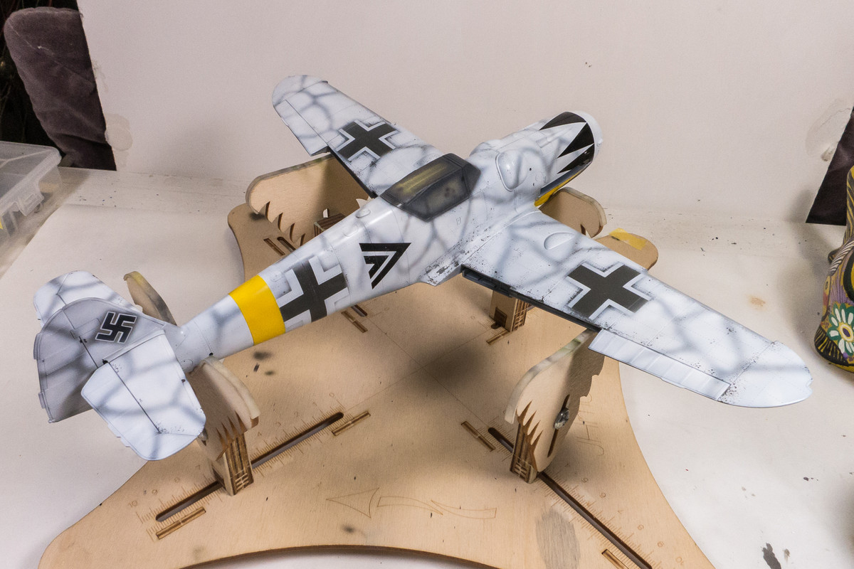

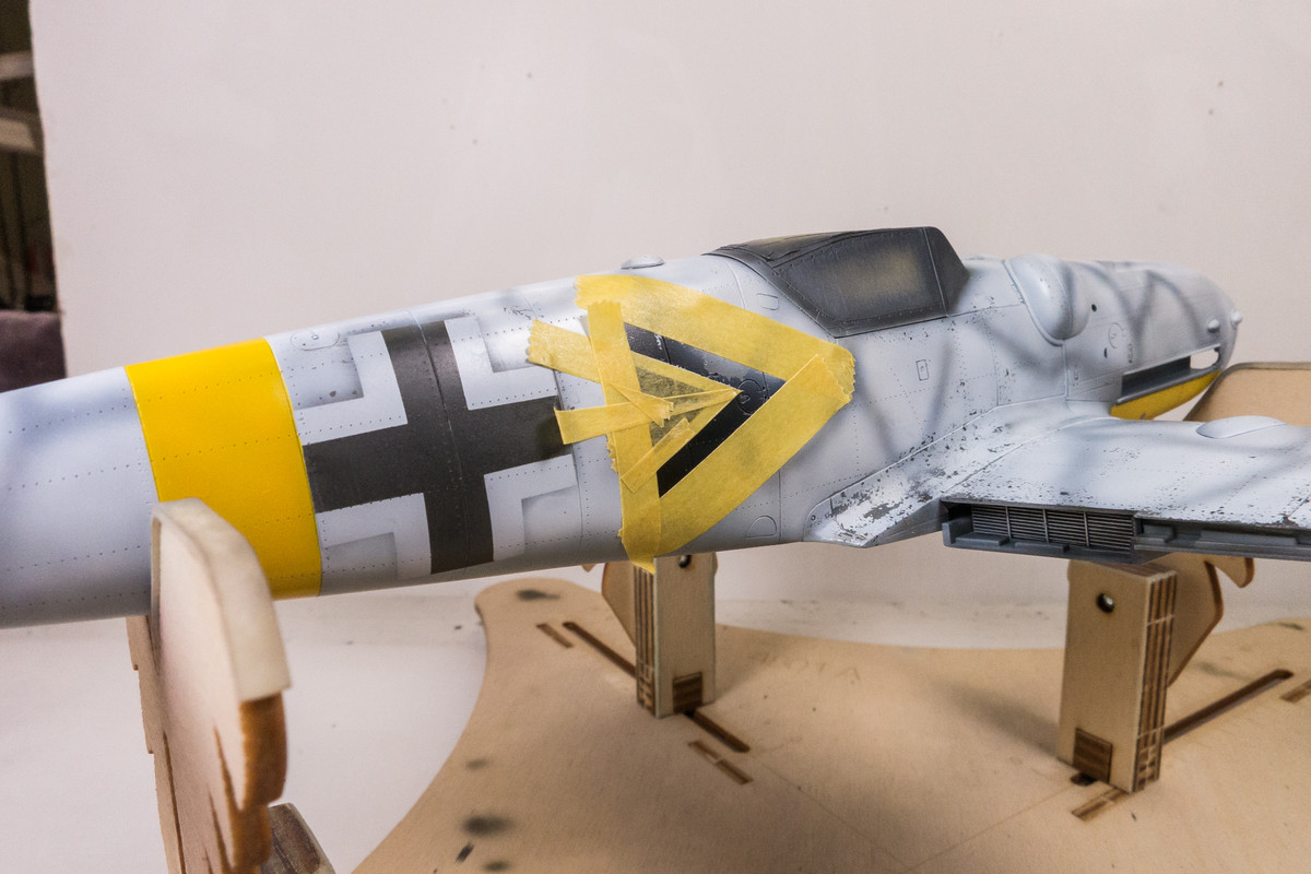

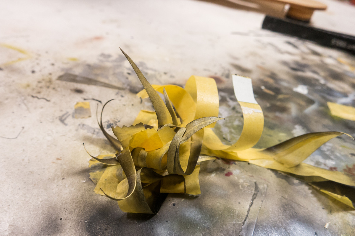

Here's a sample of the paint repairs that I'm performing at various locations. Since this one runs into a hard-edged marking, there are more steps involved.
First I remove the compromised white paint layer with tacky tape. Honestly, if I were to really try, I could probably remove most of the upper fuselage paint this way but I don't want to start completely over. Understanding that there are no more adhesive masks to be applied in this area, I TRY to constrain the removals to a small area. The area is scrubbed with Micromesh to reduce the hard edges of the chips.
The darker base color is sprayed onto the repair area. I am using the lighter RLM 75 color because this shade sprays smoother than the RLM 74.
The white is then sprayed over the RLM 74.
Once this is dry, I mask off the black chevron. I can also cut another mask using the Silhouette Portrait but the Oramask is very tacky and I'm afraid of lifting more paint so I choose to use Tamiya yellow tape for this.
One area repaired! There is a bit of black overspray above the chevron that I need to take care of but it looks good otherwise.
In addition to paint repairing various areas, I want to get the black tulip around the nose as well. I know that the extensive masking required for the tulip will probably lift more paint but I'm hoping for the best.
After spraying the black, I removed the tape as carefully as possible.
A bit of paint lifting on the engine cowling but thankfully, it is well away from the black tulip.
Better results than expected, paint lifting-wise. I'll let this dry completely before I perform the touch-ups necessary.
Look at that spot on the port wing.
Like I said, two steps forward, one step back...

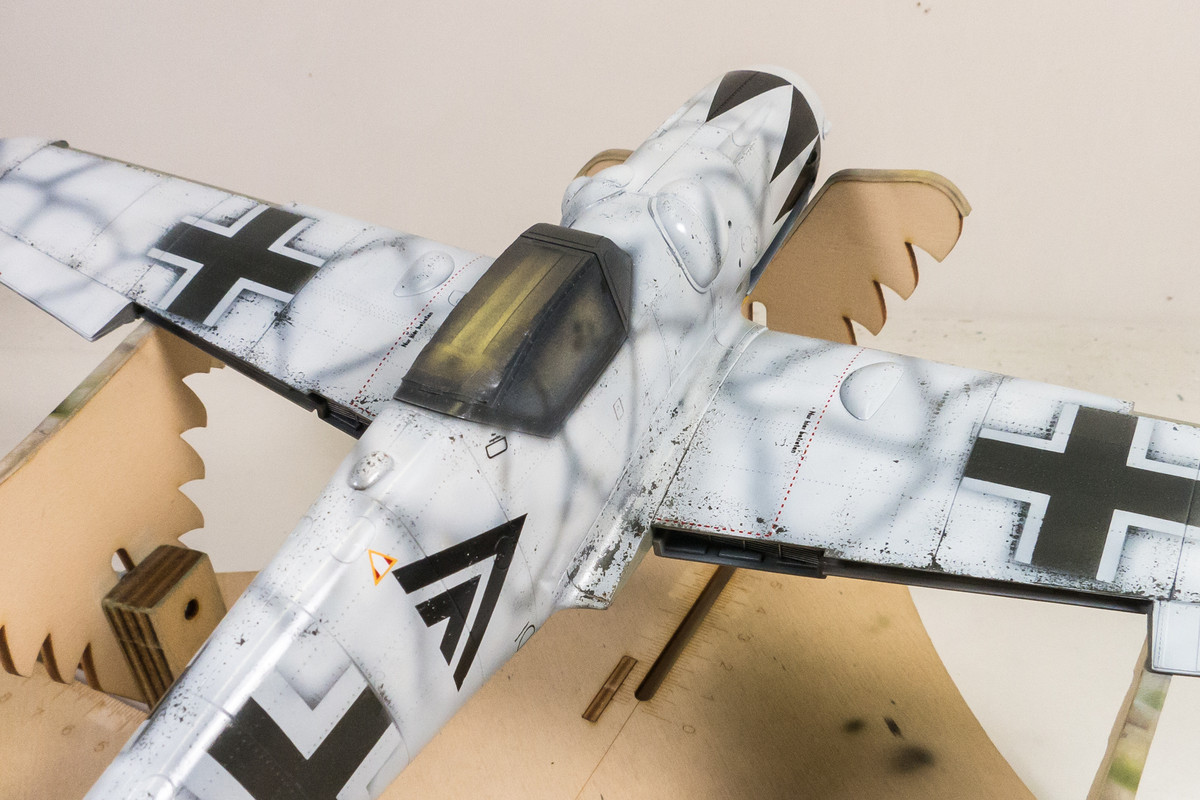

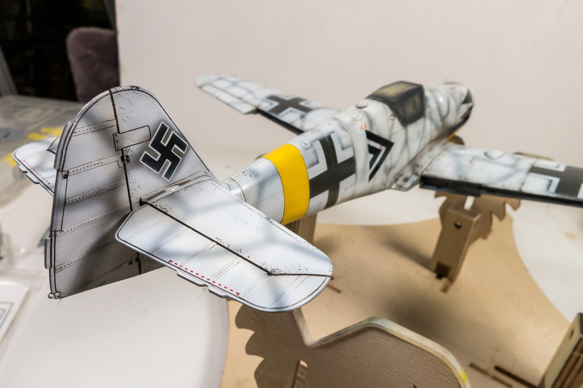

Some paint repairs have been made including the one by the black tulip and the one on the port wing. Other areas have popped up but they are getting smaller and less.
Popped the painted spinner onto the front to give us an idea of where we are headed.

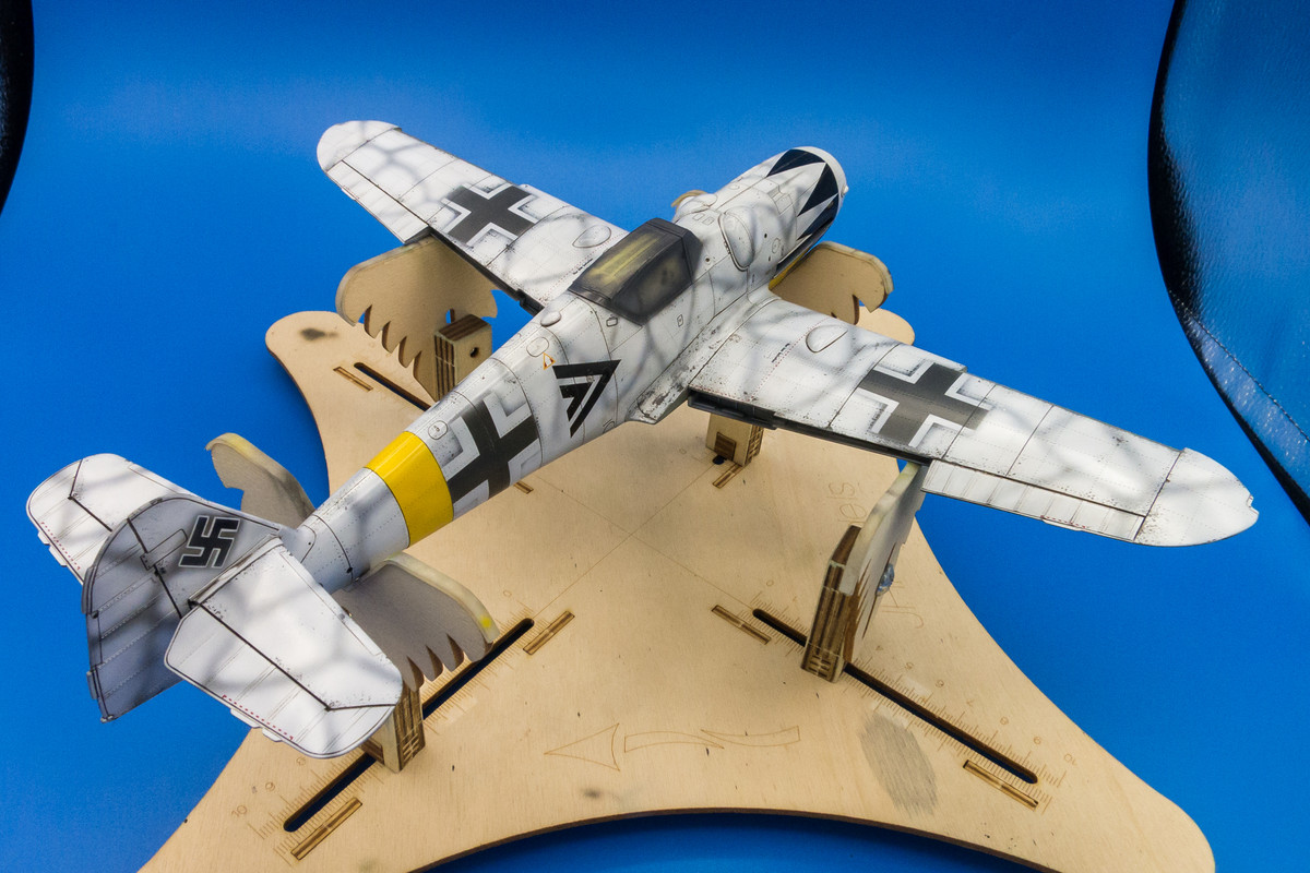

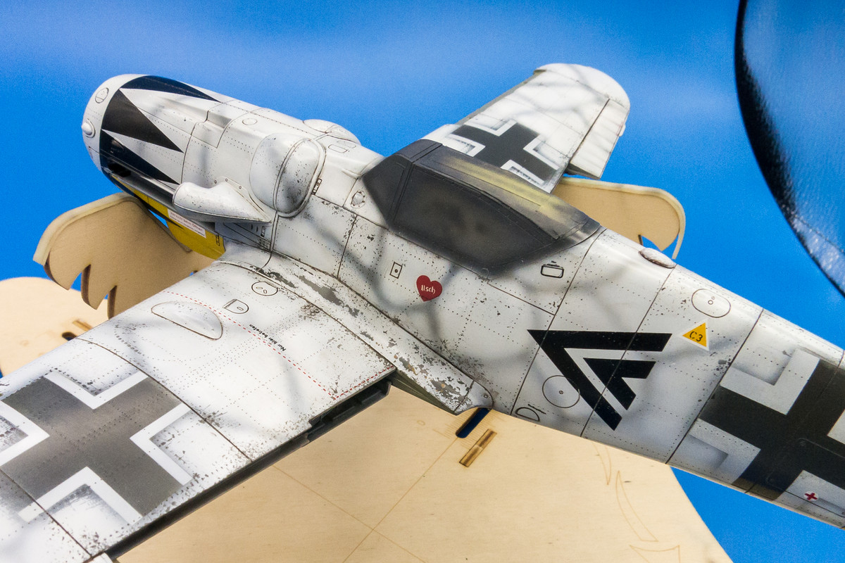

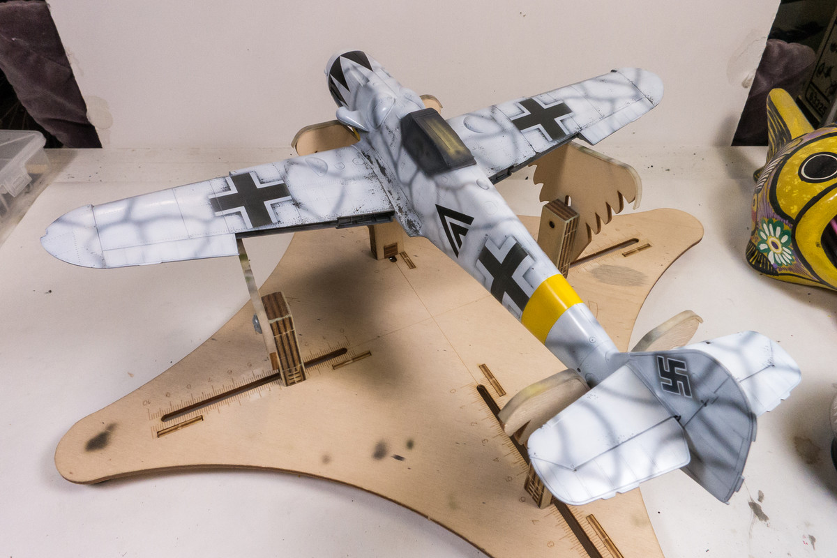

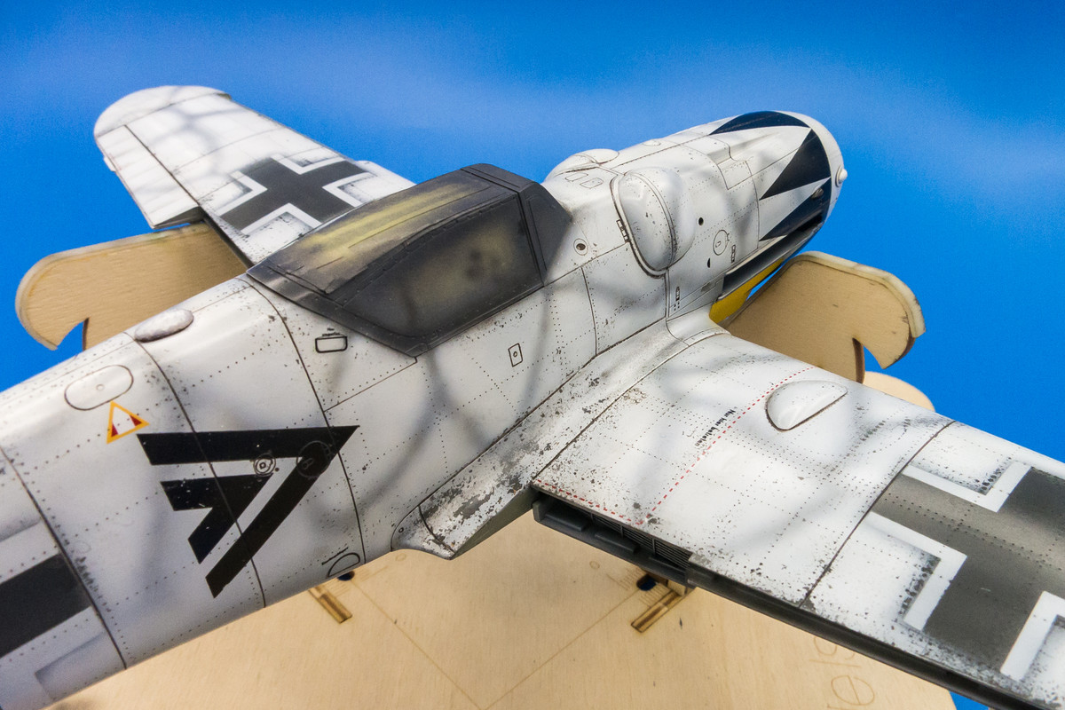

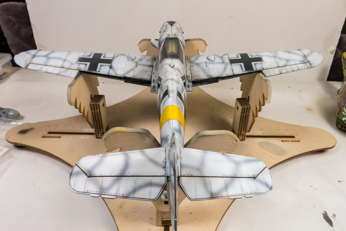

Work on the G-14 continues! The decals have been applied. I've tried to avoid the Hasegawa decals as much as I can since they are a bit thickish. Luckily, I have lots spares from the multiple Revell 109G-6 and G-10 kits that I've built and also some Eaglecals as well.
After the decals, the model is given another light gloss coat and then a pastel wash using a brown color.
Re: 1/32 Hasegawa Bf109G-14 Hartmann
Beautiful weathering. You're capturing the look of a aircraft operating in cold weather and muddy conditions perfectly.

And there you have it! It looks as if there were never any problems to start with. That turned out truly remarkable John.
