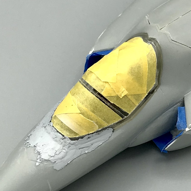

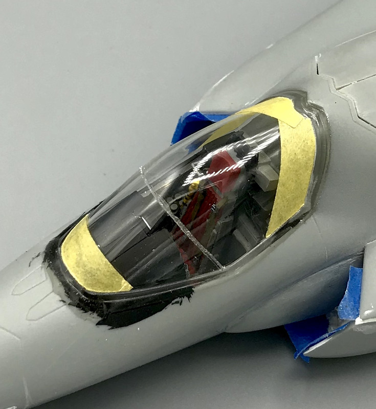

The kit provides a single clear piece bubble canopy. But the actual X-35 had a two piece canopy, with a bow frame separating the windscreen and a side opening hood. So this is how I set about correcting that. I was not sure about the exact location of where to modify , so I had to wait until I had glued the canopy in place for a solid reference point. I used Epoxy for this to insure that canopy would not move and let that dry overnite. Of course this provides a rock solid attachment, and it did not fog the Future dipped clear part. Then after looking at photos, I found good reference points with the IP top and used them to guide me in scribing a split line into the canopy.
Then I finished masking the canopy to match the framing in photos. One side has a wider frame than the other. I also had to putty the front of the canopy to eliminate a step
And then I cleaned up the filler work

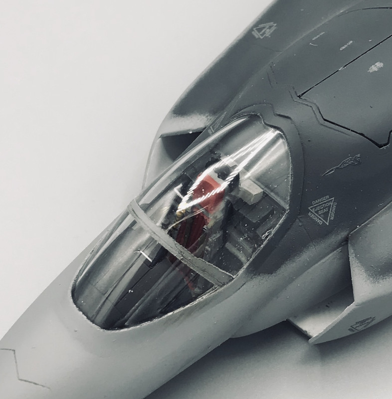

I then built up several layers of primer and paint to create something of a raised frame. In hindsight I should have used some black in a layer somewhere to lessen the chance of translucency. The primer and paint worked pretty well, but not 100% perfect.
The end result...
Tomorrow I should have this all finished...
Re: X-35A, Revell, 1/48
Ahhhhhh - Now it makes sense! Great stuff Carlos, This is really coming on!

Glad you like it. I figured that it would be much easier to explain with photos after it was all done.
Well, I was close. Sort of. Looks good.
