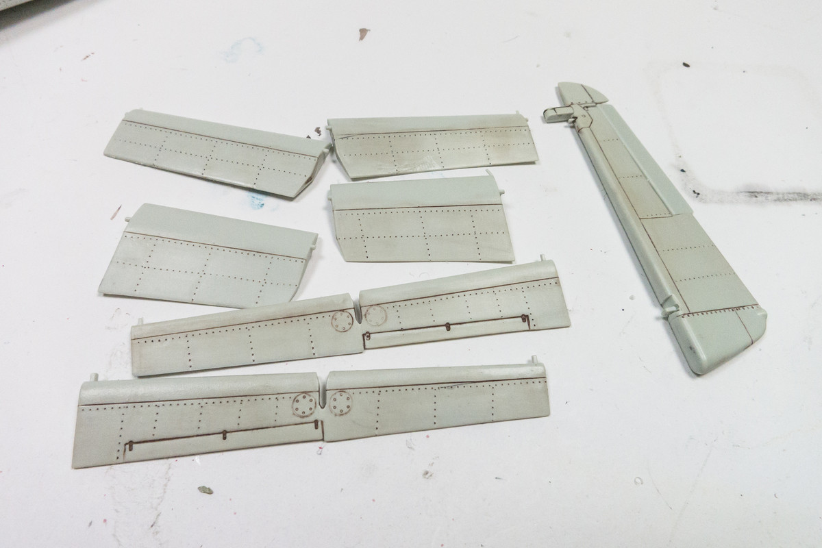

Thanks guys! Committing to those small things is one of those double-edged knife things. I do think the result is a better model but sometimes you get sucked into a ever-deepening hole!
My analysis of the photos of Red 10 leads me to believe that it had the older style enclosed tail light while the Revell kit depicts the later exposed bulb tail light.
The fuselage/wing assembly is in good shape but the engine nacelles need a lot of cleaning up.

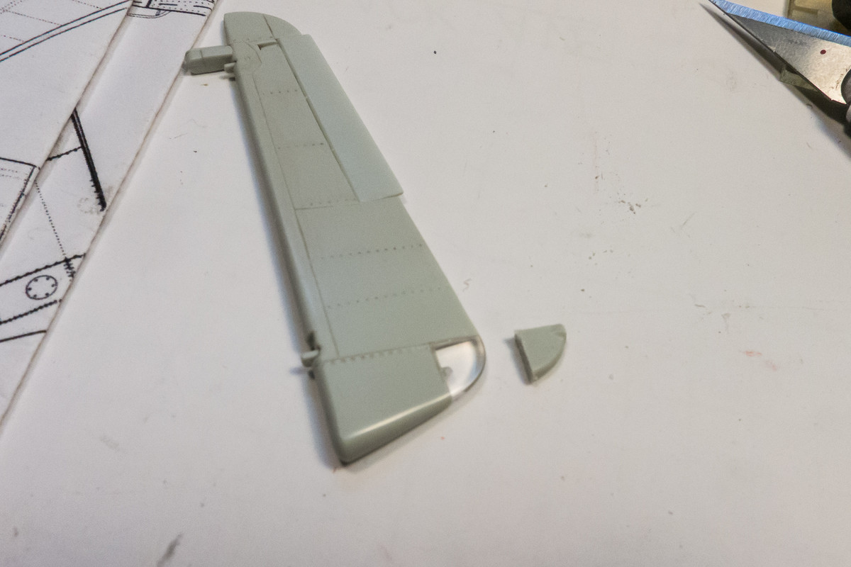

While putty dries, I replaced the tail light. First, I found a suitable piece of clear plastic. This was one of those greeting card holders you get with a bouquet of flowers.
The existing tail light is cut out with a razor saw.

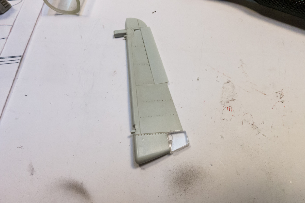

The replacement piece of plastic is glued into place with UV-activated clear epoxy. A partially drilled hole serves as the bulb.
New tail light after sanding and polishing.
