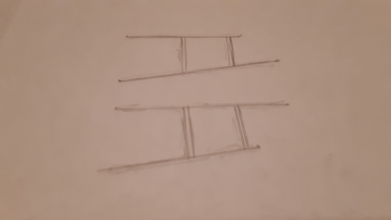

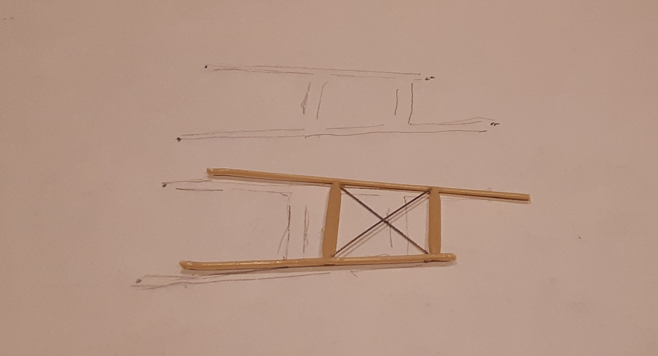

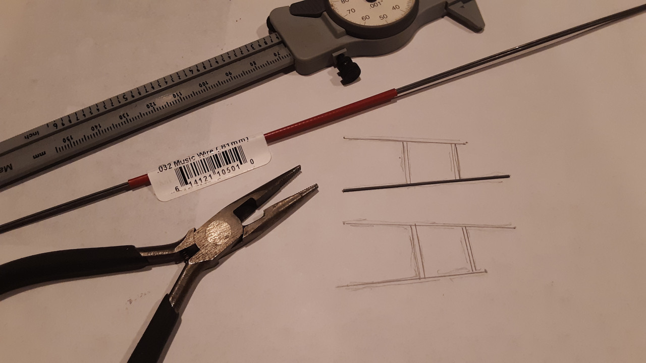

Finally started scratch building the airframe for the DH2. I will use .032 inch (0.8 mm) piano wire for the frame, reshaped .080 x .080 inch styrene for the spars and high E guitar string for the wires.

Are those metal wire/rod? Are you going to solder them?

Stikpusher, I will use epoxy glue, maybe a longer cure time as it turns out to be a stronger bond. I used metal because it was thinner, straight and stronger.
