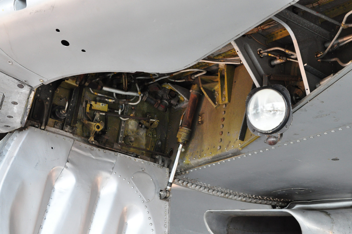

I’m thinking about the gear bays too.
I was just gonna spray them interior green, but I started looking at colorized photos of old P-51B’s and I found these:
That’s kinda cool looking. Chromate on some surfaces and bare metal on other surfaces in there. I think that would look really nice in my model’s gear bays. And I figure if I can mask and airbrush paint on a 1:72 ejector seat, I can mask in there pretty good. And hey- if I screw it up there’s always Windex. So I’m feeling pretty good about that.

Kenny the back wall of the gear bay is the main wing spar. That is zinc chromate. After that some bays were painted some left nmf.

Thanks buddy! I appreciate it. And you know, that’s really cool just from the perspective of being an artist looking at something a fella engineered. I don’t know why but the idea of using the wing spar as the rear “wall” of a gear bay is just hella cool and sexy. Personally, I love it. It affords cool opportunities for artistic license when modeling them.

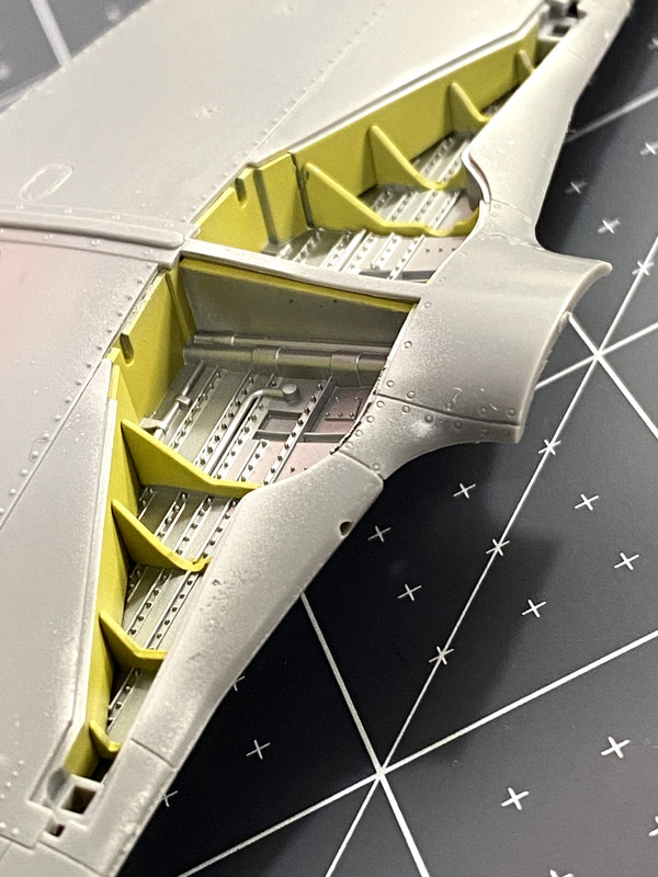

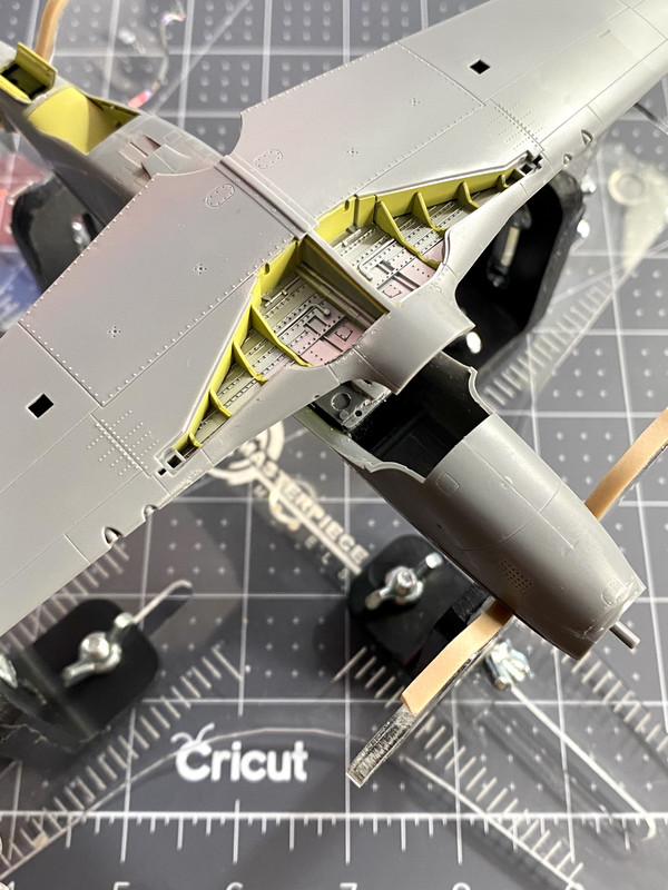

I got the main paint on the gear bays first thing this morning, and fused the top half of the wings down. I really like how this looks. I’d laid down the metal in there days ago. Held up to masking just fine. In the end this will be weathered, and I may end up dry brushing a bit of zinc chromate on the small, thin strips that run horizontally in there. Or I may not. I’ll noodle that.
And like I said about artistic license, it’s a great stock gear bay. Beats the Hell out of the barren corrugated squares in Tamiya’s Corsair kit. For an older kit, it’s detailed pretty good.
That said, the Vector resin set I have for this kit beats the kit bay hands-down in the detail department.
BUT- one modeler’s issue I have is looking at kit parts with a snobbish bent, buying resin replacement parts, aaaaand then totally screwing the proverbial “pooch” when it’s GO!-time. So my goal here with this build is to try and make as much of the kit it’s self look as nice as I can with good painting and detailing. See if I can make a *mostly* stock model look really good with competent painting and other things that proper time and attention can afford.
And on that note, if your Stang happens to have an interior green gear bay, you can totally go nuts in there with different shades. I’d prime the “floor” area with High Speed Silver, and the back spar and ribs in black, and then use a darker, dark-gray leaning interior green for the ribs, a light-gray leaning interior green for the floor over the metallic, and then maybe a slightly brownish shade for the spar, or Hell, do the spar Chromate. All kinds of fun is possible in there.
Here’s some pics:
