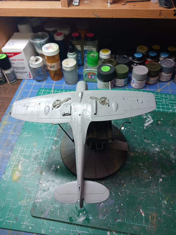

RAF Medium Grey 2 painted on undersides of Clipped wing Spitfire..

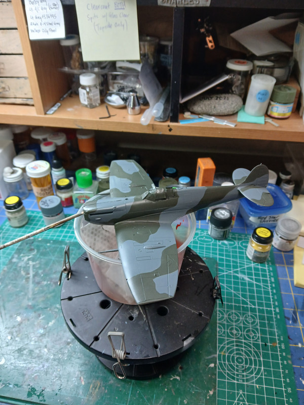

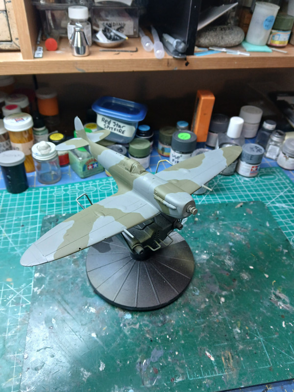

Re: 1/48 scale Spitfire Mk.Vb ‘Red Star’ Dual Build
Camo is on Clipped Wing Spitfire. Used Tamiya XF-82 RAF Ocean Grey 2 and Model Master 4849 RAF Dark Green.
- Posts: 13591
Camo is on 'Red Star' Spitfire. Used Tamiya XF-82 RAF Ocean Grey 2 and LifeColor UA91 Dark Green FS34079. Although LifeColor's Dark Green FS34079 is lighter shade than Model Master RAF Dark Green FS34079. I'm satisfied with LifeColor choice for the 'Red Star' Spitfire.
