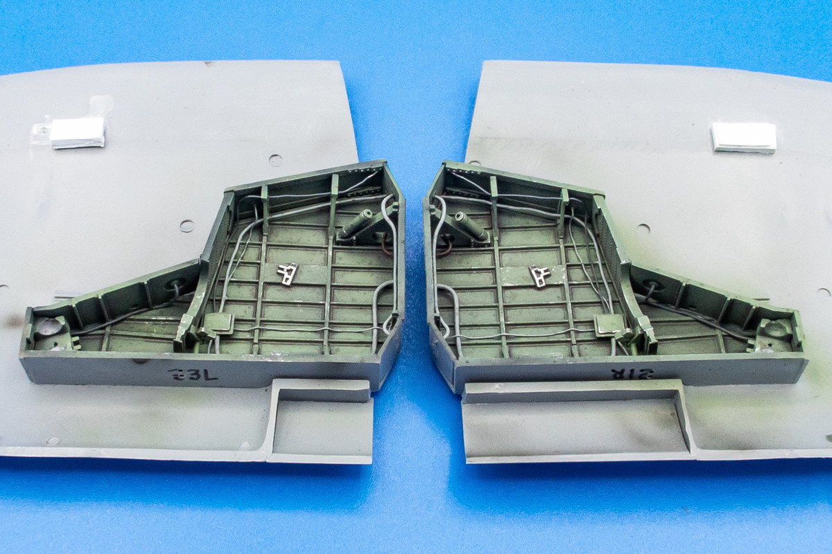

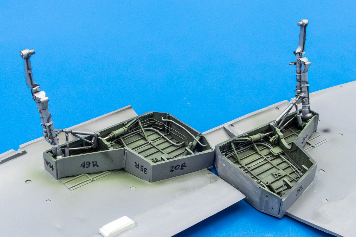

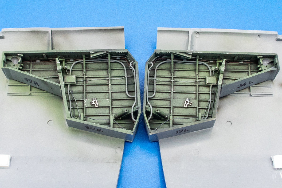

The wheel wells were given a dark brown pastel wash. This took much longer than normal because of all of the stuff in the wheel wells that I had to work around. Extra attention was making sure to eradicate any telltale stains and to repair any paint damaged by the wash operation. A flat coat was applied to seal the deal and I temporarily mounted some of the landing gear components in place for these pics.
Weathering is not quite done on the wheel wells but they are close to being finished.

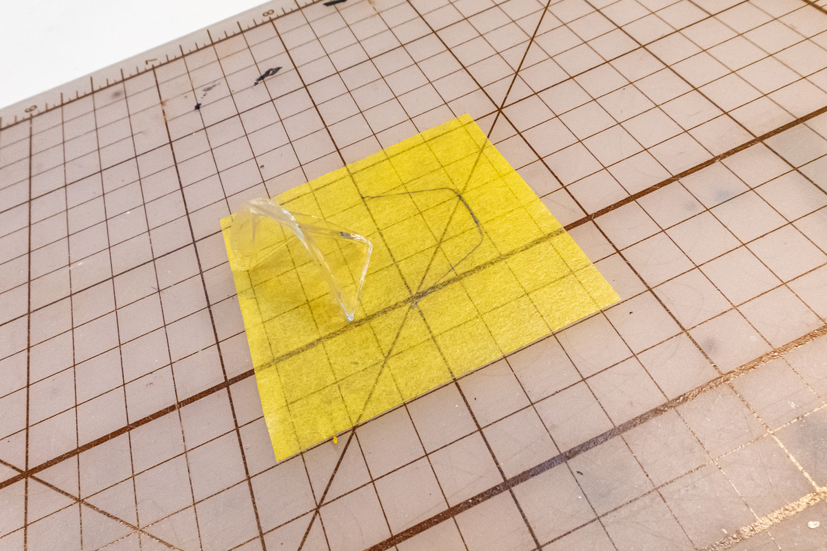

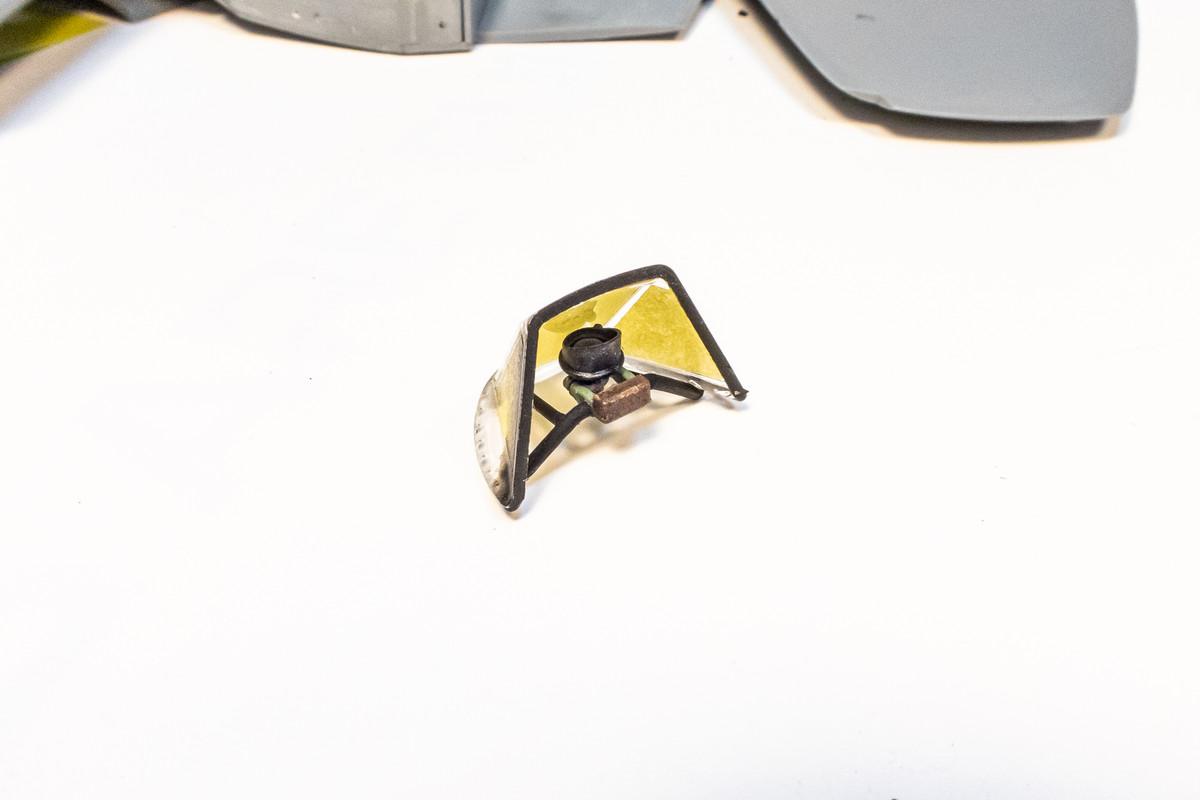

I used the windscreen to manually trace a mask that can be used to help seal the cockpit prior to painting.

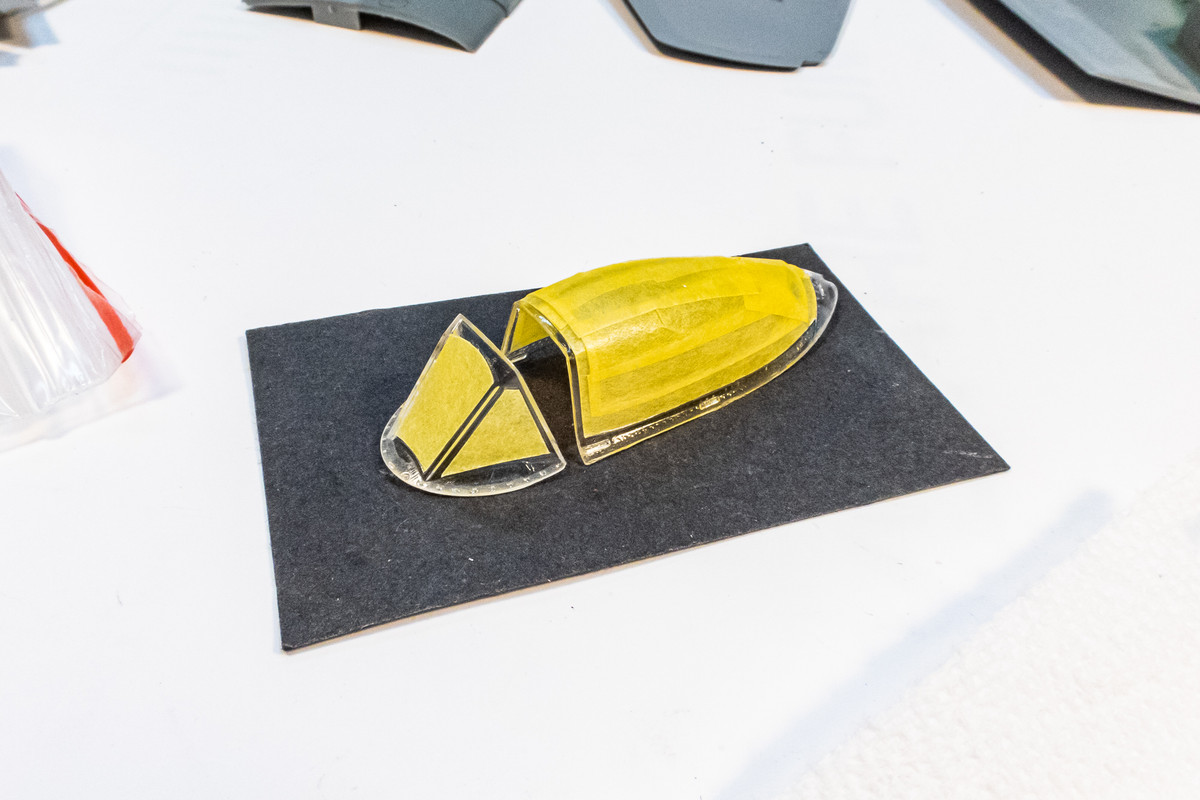

The clear parts have been masked. The Special Hobby kit comes with masks but they are of the black vinyl variety ala Montex, which I do not trust. I much prefer the yellow Tamiya-style tape that Eduard uses for its masks. So I used the kit mask as a template and cut new masks on a Tamiya Tape sheet using the Silhouette Portrait Cutter.

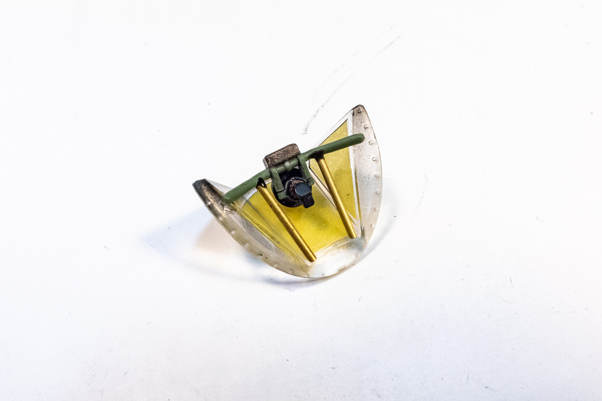

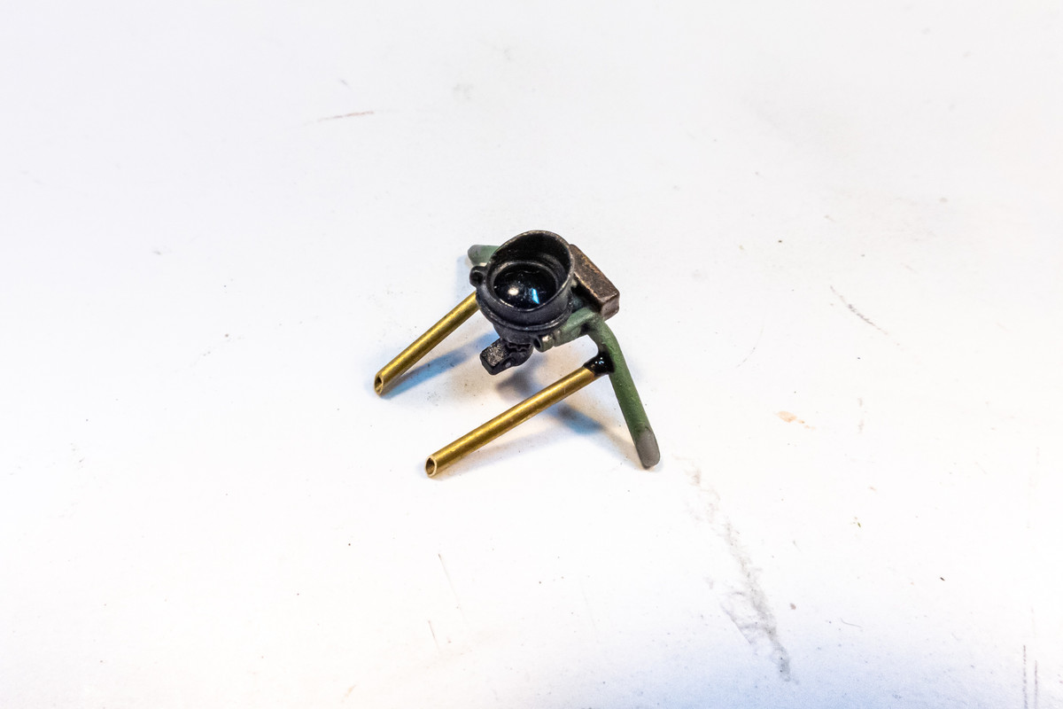

I had trouble getting the gun sight mount to fit within the windscreen. This is probably my doing... the resin part had both of its forward pointing braces broken off and I cut off the braces from the plastic part to replace. Most likely the orientation was wrong. Anyways, I snapped off those braces and replaced them with sections of brass tubing, which were sized and placed AFTER the gun sight mount was temporarily glued with PVA glue.
The gun sight assembly was then removed and the glue joints reinforced with CA glue.
I repainted the arms black to help hide the glue joint and glued the gun sight back into the windshield permanently. I've elected not to paint the interior frames of the canopy and windshield but have masked painted the exposed edge of the windshield black.

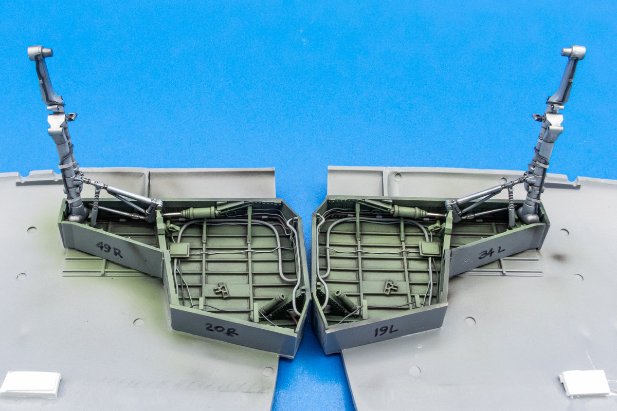

Additional weathering has been applied to the wheel wells. First, I gave it some light chipping by dry-brushing Testors Silver along exposed edges and bolt heads. And then a watered-down mix of brown pastel wash was splattered into the wheel well. Subtlety is the key here and any obviously big spots of wash are wiped away.
That gunsight is a beautiful piece of work.

Thanks guys! The Type I Mark III gun sight is resin and has some nice detail on it but it's hard to see because of the angles.

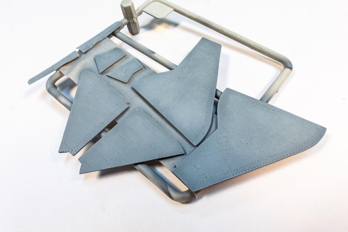

The outsides of the flaps and landing gear covers have been painted, given a brown pastel wash and then sealed with a flat coat. Not sure how I am going to weather the undersides of this Tempest so I'm holding off on weathering these for now. I can flip the gear covers over and paint the interior sides and weather them if I need something to work on.

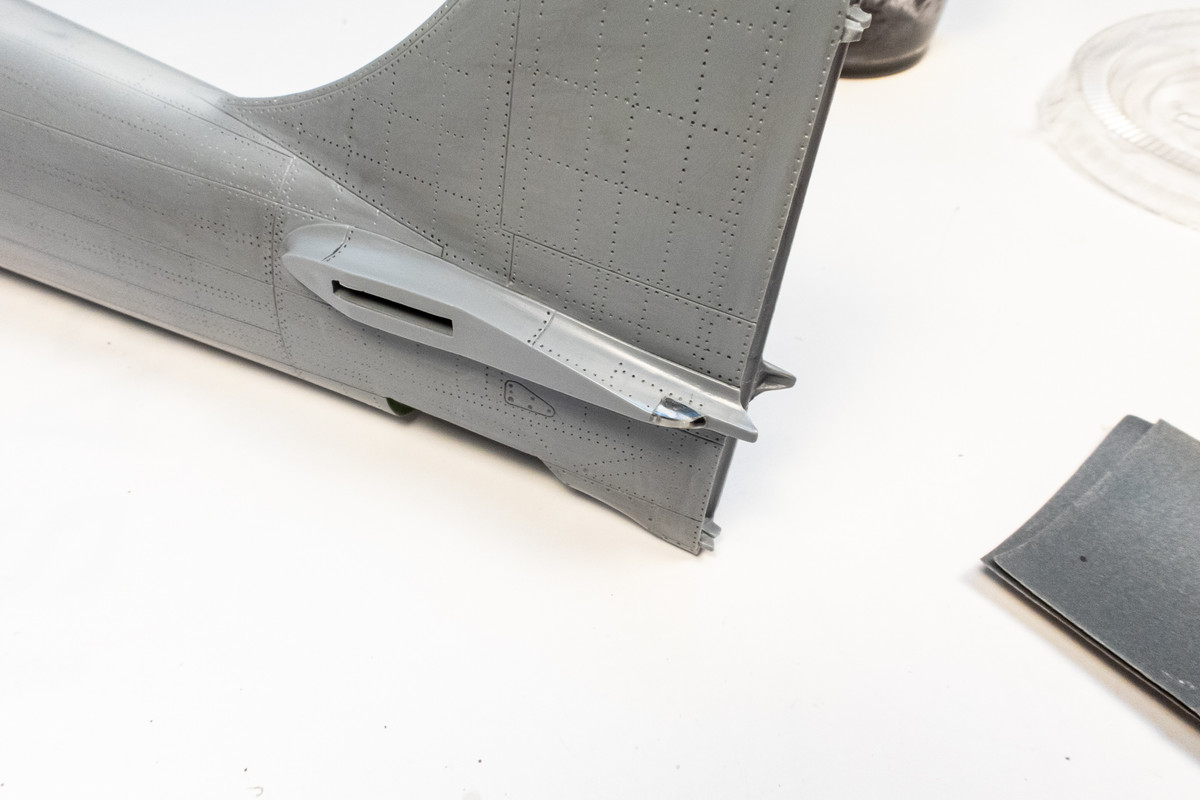

The clear lamps on the tail were glued into place. Not the greatest fit here so I had to do some sanding and get them flush. Obviously, these will have to be masked prior to painting.

The lights on the tail are very interesting. Never knew about that
