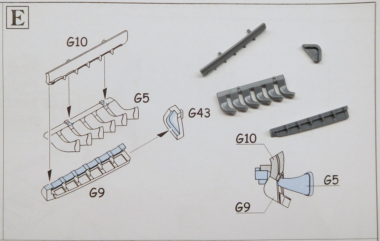

So after a busy work week, including a brief worktrip to Sweden, I have had some time to continue the work on both IX:s.
While Eduars 1/48 kit looks wonderfully sharp, I am not 100% if I like it so much. .
As earlier also mentioned, this kit is slightly over engineerd. I don't mind challenges, but to need to something complex that just disappears totally inside the build, I don't really like it.. As en example the exhaust pipe consruction... In total 4 pieces and on top of that somehow tricky to align the pieces correctly while cementing them..
But you cannot complain then again with the details.. Look at the detail of this exhaust pipes... Quality you usually only see in aftermarket stuff..
Posts: 5621
Re: Karis Spitfires
There is just something of the port side exhaust pipe construction.
It just does not really "sit" correctly where it is supposed to sit, in the "engine room".
The starboard side is perfect, nothing to complain there..
Even the instruction regarding the starboard is not correct regarding the "triangular" end piece (G43). I can't understand how Eduard is thinking here, the angle of the starboard exhaust piece nr G9 does not "let" you glue G43 in that way...
:headbang:
I wonder, has any SPAMmer built Eduards 1/48 Spitfire before and would have noticed the same ?

That does seem a overly complicated way of doing things I agree - but that detail is wonderful. :hmm: Do you have to assemble the exhausts before paint or can you do them afterwards?
Posts: 5621
Re: Karis Spitfires
I can assemble the exhausts afterwards, as long as I don't glue the "bonnet". So that's fine, but yes, the details are great, but. neeh, not this Eduard is not really my cup of tea to be honest... :sad:
(there are other issues as well, some due to me and some due to Eduard ) :headslap:

The other chief complaint I have is the exhausts. The kit parts are very nicely cast, and look great. They look better than some resin replacements I’ve seen over the years. However, the mounting structure is a veritable Rubiks cube of parts. Once you figure out how it goes together, you get an “a-ha!” moment, and from then on you have it. But getting to that point can create some small amount of angst.
To top it off, the exhausts must be mounted during the assembly process, and cannot be mounted afterwards. This makes painting and weathering them a bit of a pain.
Happily, there is an alternative for both issues. Ultracast provides a gorgeous one piece resin replacement part that is truly drop fit, and gets around the cowl problem outlined above. And they also make a replacement exhaust set that is very nice, and allows for the exhausts to be fitted after painting, which is a huge plus. They make both the bulged and flat cowling part, as well as fishtail and round exhausts. You can check out all of their 1/48 Spitfire accessories on their website''

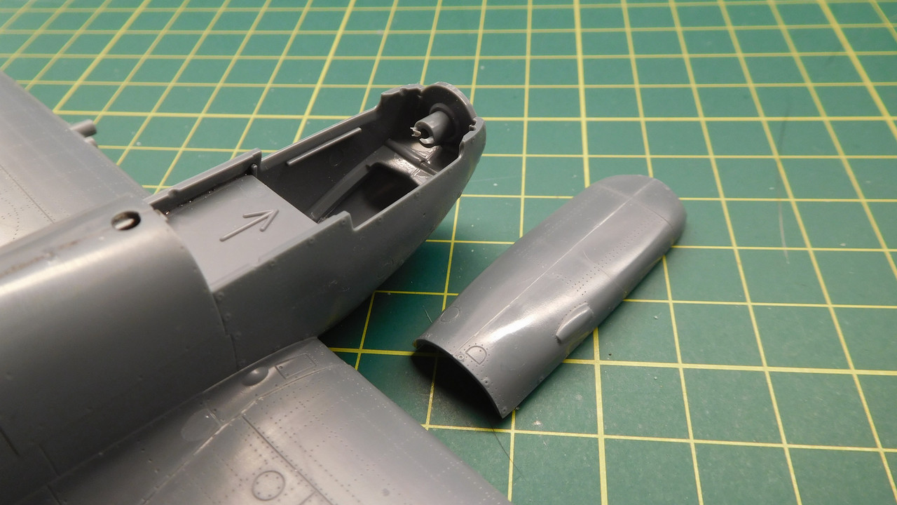

I do not know Jon personally the way Stuart does but his words crop up in reviews and discussion of Spitfires. I read what Stuart excerpted as a fascinating look into the difficulties of working with the extremely accurate bias found with Eduard’s kits. Personally when I feast my eyes on your photo of the exhaust and cowling, I am really excited, I am sure you are, too. I feel it. It feels right. Extraordinary achievement. It’s extraordinary work being done, Kari. Your work is so clean and sharp! I would like to see what does not work as well. To me the photo you posted is amazing. The only issue may be some side to side compression of the cowling. It may help to start with what surrounds the top of these inserts?
Posts: 5621
Re: Karis Spitfires
Thanks Bruce for your kind work.
just briefly, the cowling was just dry fitted there. It will not be cemented before all paintwork has been done and the exhausts also.
Here I disagree a little bit with Jon, who say the exhausts must be mounted during the assembly. No need, can be done very late in build, as I will do.
The cowling needs to be slightly "pressed" into place, but then the fit and alignment will be good !
