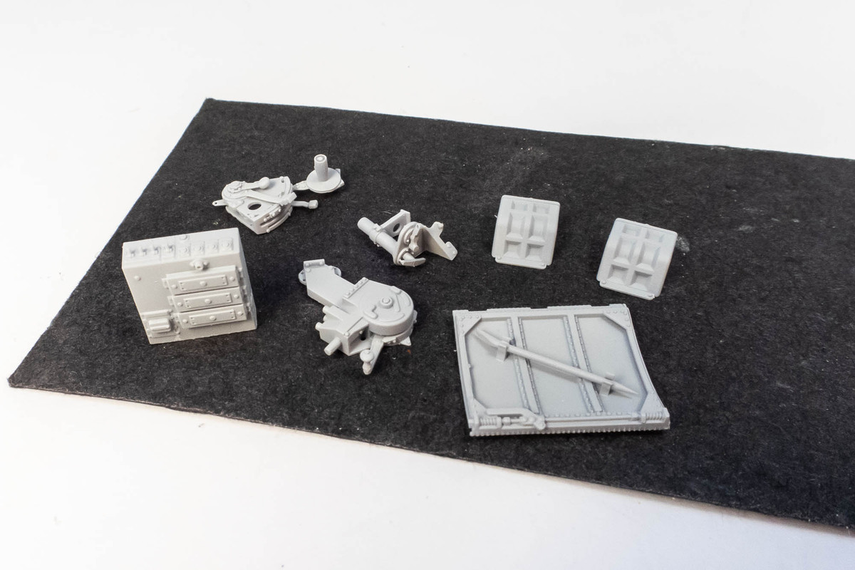

A rectangular box can be a relatively simple thing to scratchbuild but I personally have trouble getting square corners on boxes. When I saw that Mathieu at Laminar Flow Design was developing a set of XIV-specific cockpit details including the control panel, I decided to wait for it to save me some work. It took a while but I finally got it...

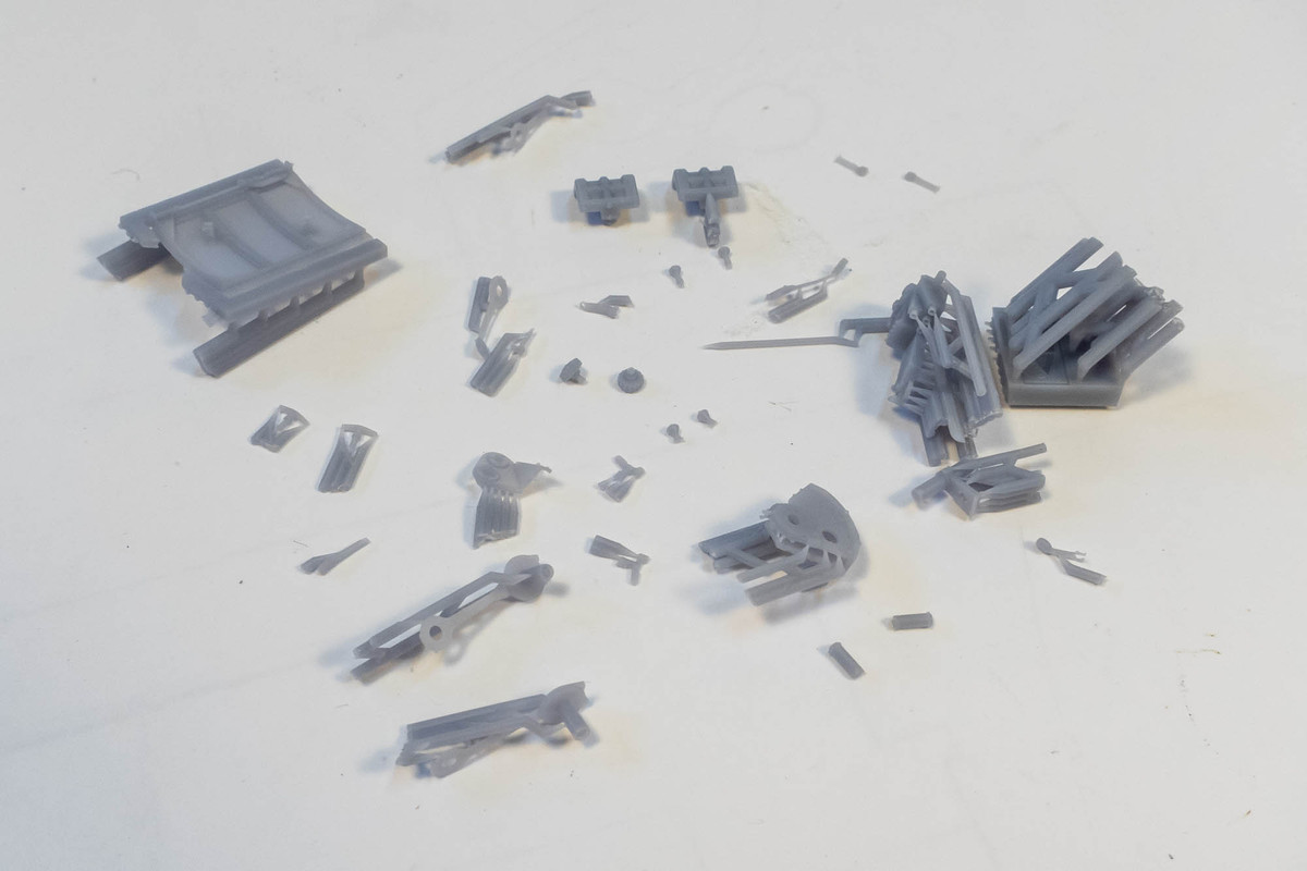

Like his other 3D-printed products, Mathieu incorporates a protective crate around the printed parts. He graciously include an entire spare set and I found that the spare set was definitely needed.
Here are the parts still attached to the base but with the protective walls removed. Many of these parts are super tiny and lots of patience and care needs to be taken when removing the parts for use.
I tried to be careful but I still managed to lose and/or break a few parts. Mathieu includes two copies of the especially small or fragile parts in each set so sometimes I had four copies to work with.
After the parts were freed completely from their printed supports, I glued together the sub-assemblies. These included the pilot door and crowbar, throttle quadrant, landing gear control quadrant, cylinder priming pump. The control panel, waffle-style foot guards, canopy crank and a small trim wheel are stand alone items.

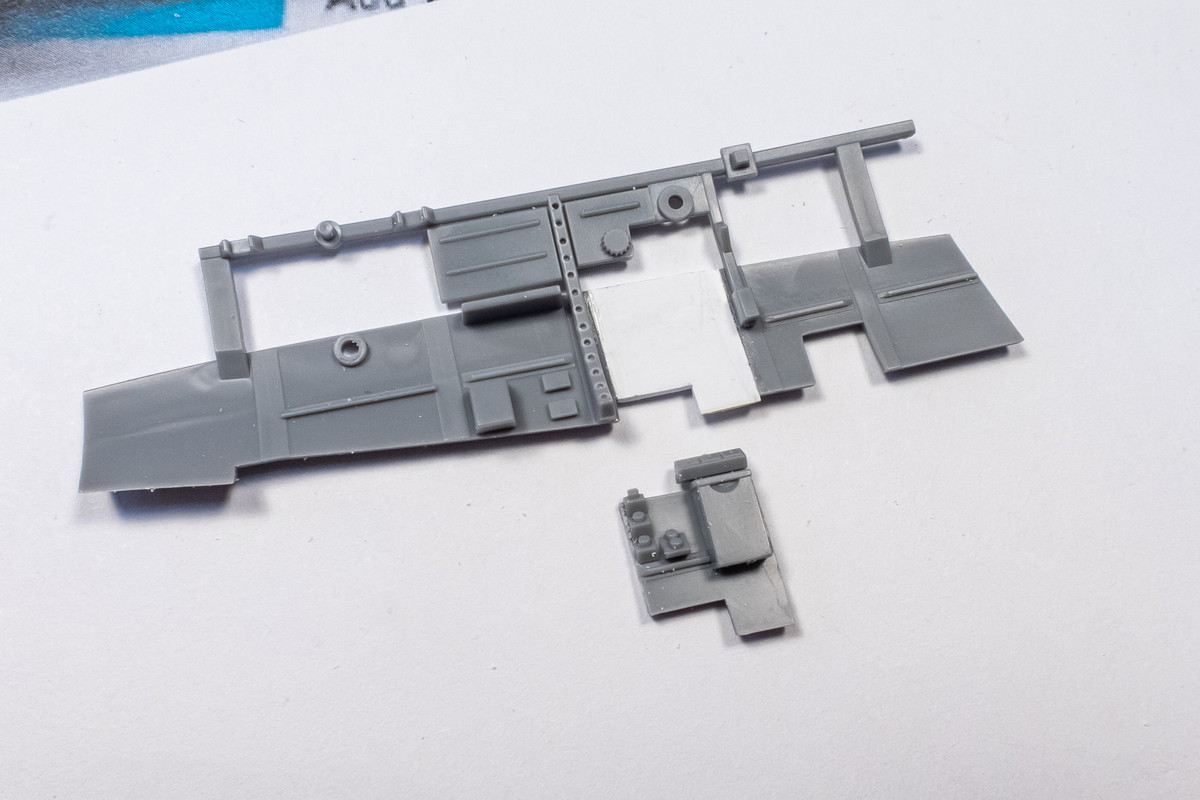

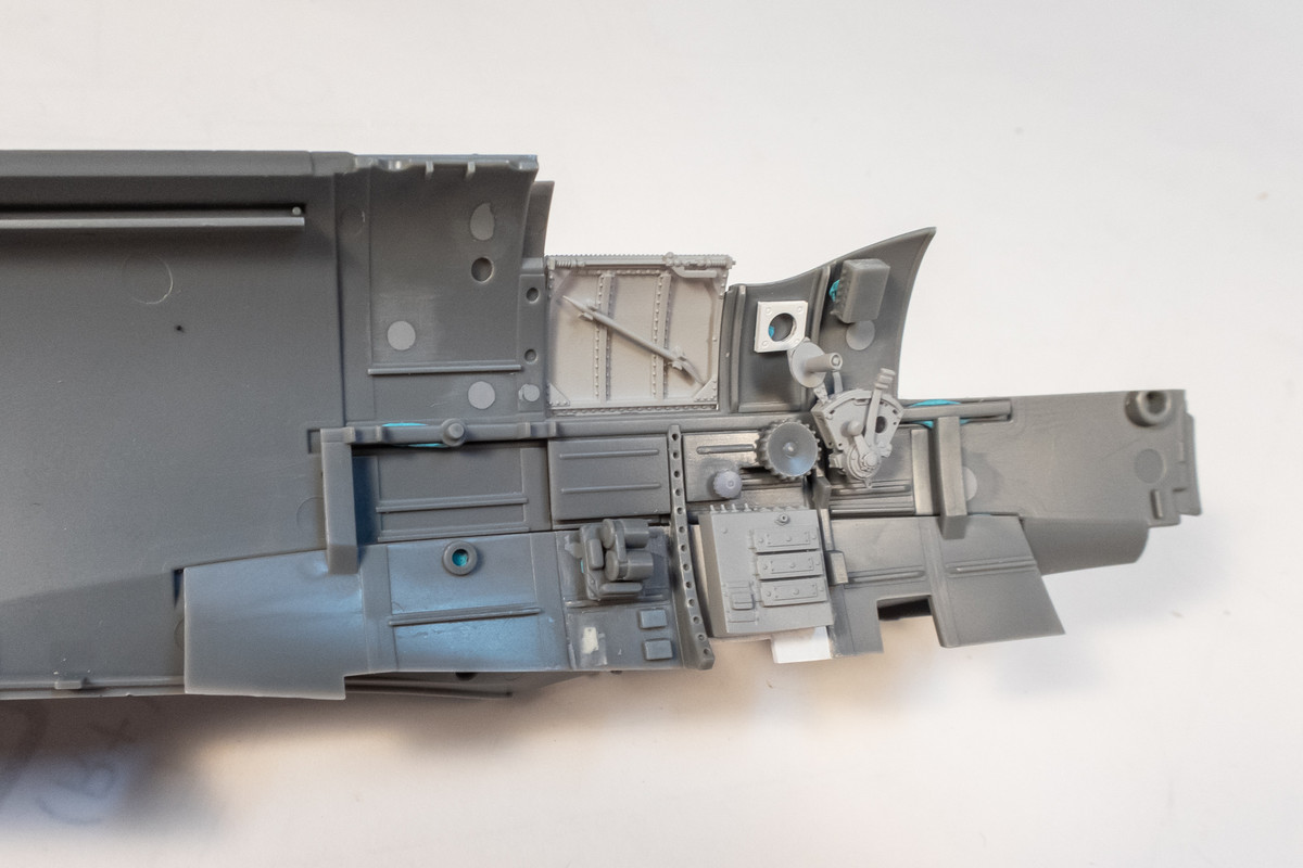

I started modifying the Tamiya kit parts to accommodate the LFD upgrades.  The biggest change is the big electrical box that needs to be added to the port sidewall.  Some surgery is needed on the kit part to make room for the electrical box.
After making most of the necessary modifications like moving the voltage regulator, making a jackplate for the gun camera film footage indicator out of sheet styrene and filling in ejector pin marks, I've tacked the rest of the port sidewall components into place just to get a feel for the wiring that I'll be adding later.
There is a big fuel tank directly behind the seat, which will block the view off from the seat bulkhead to the rear. This will limit visibility into the rear bottom area of the cockpit so I'm not going to bother with trying to replicate the flying control linkage wires that run under the pilot, which I was previously considering.

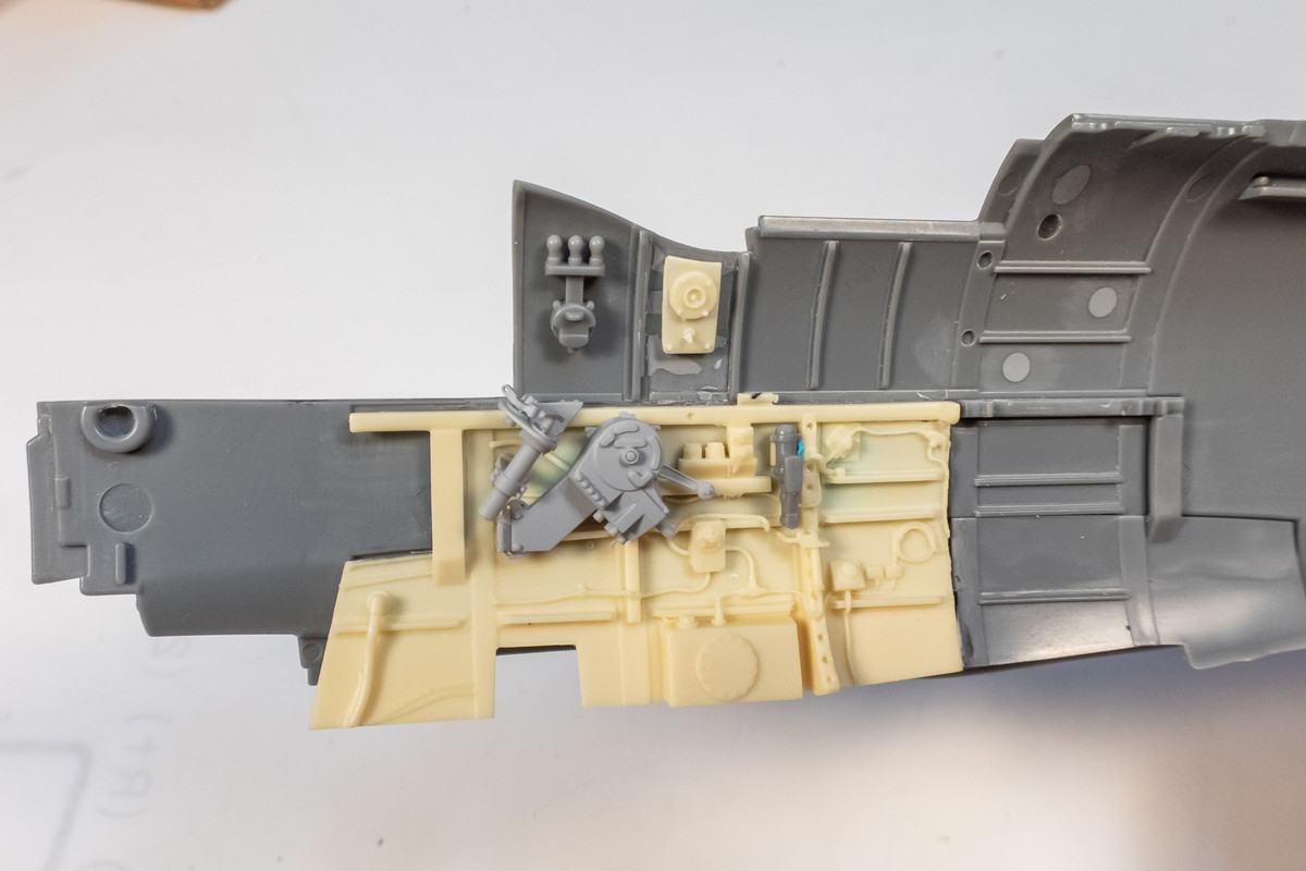

I've done similar modifications to the starboard side, which features a resin sidewall replacement from Barracuda.
My plan is to separate the cockpit into subassemblies... the port and starboard sides as presented above, the instrument panel/cockpit floor and the seat/rear bulkhead. Once these subassemblies are assembled and painted separately, I'll put them together as the fuselage halves come together.
