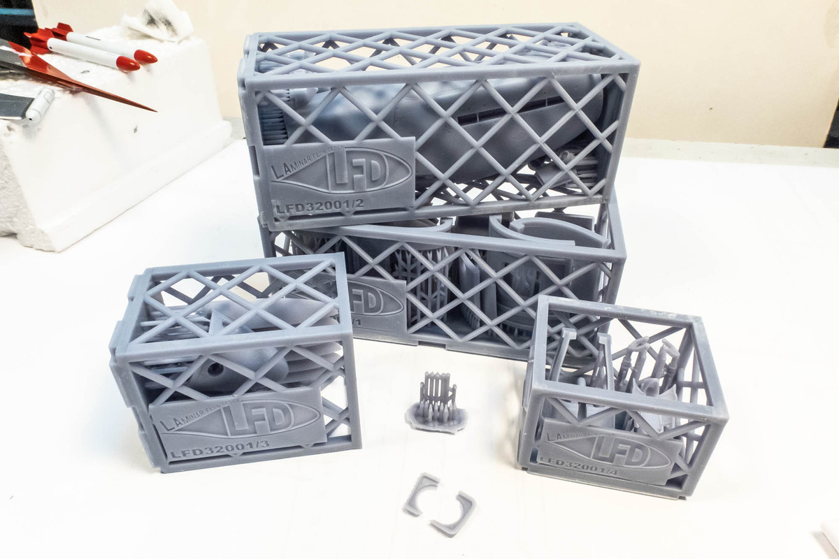

It packs a lot of stuff into a very small space, thanks to very clever production design. The parts are digitally printed within four separate cages to protect them during shipment. The four cages are designed to fit perfectly in the box.
To my surprise, I found some loose parts in my box.

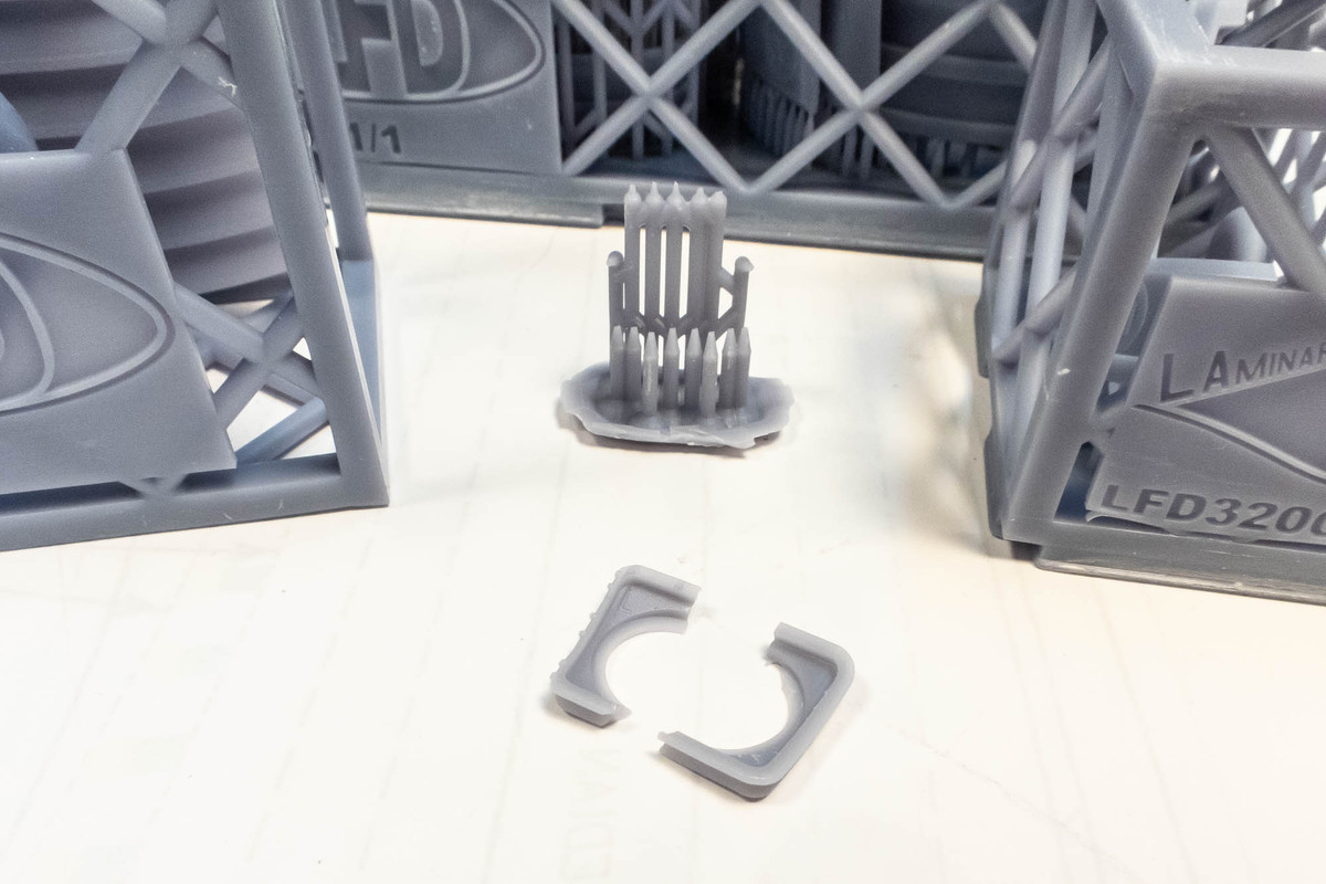

Strange... it appears to be one of the camera fairings for the FR variant.
But when I peek into Cage #4, I can make out two camera fairings intact.
Unless there are more than two of these fairings in this set, I believe that the broken fairing and its support base got tangled up into this shipment during the packing phase. I'll contact Matthieu to inquire but I'm not too worried about it because my initial plans are for the fighter variant and I won't need the camera fairings anyway.

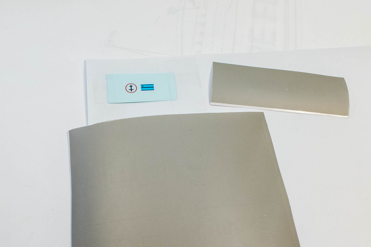

As an initial step, I wanted to see if I could fabricate the specific markings for this aircraft using a combination of custom cut masks for the larger markings and custom decals for the small squadron badge beneath the exhausts and the squadron leader flag under the windshield. The masks were created in AutoCAD and cut with a Silhouette Portrait and the decals were mocked up in Powerpoint and printed onto decal paper (Microscale).
Due to the lack of opacity of the printed decal, I had to paint a white box as a background for the squadron leader flag.
