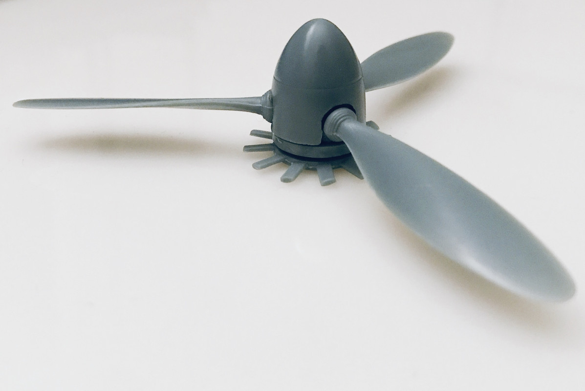

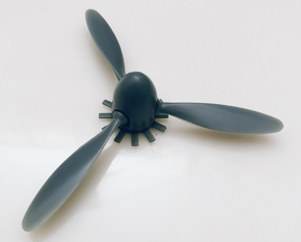

John—Definitely! I did want Henri to know why I wanted the A-5 propeller, though—and gave him the name of the kit, too. He has so much integrity with his work that I wanted to ask him for advice. Also I asked him because I have no idea if the number of blades in the A-5 fan is the same as the A-1’s fan, etc.
PCM Kit propeller

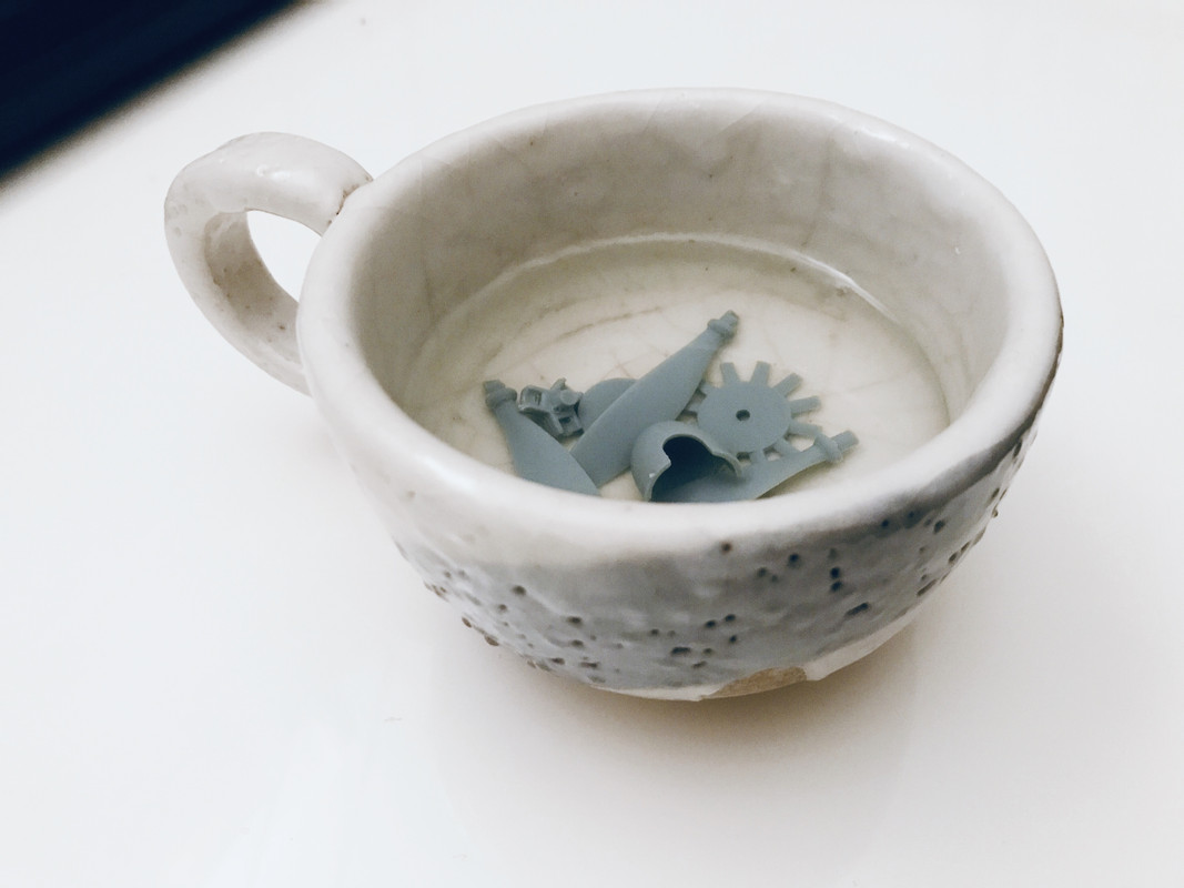

Spa time for the propeller assembly
Seam removal on both sides of each blade
PCM Kit propeller
That resin stuff from Henri looks ace!
But man, that cup...

That cup is somebody's Japanese ceramic project—not mine—rescued from an art studio I worked at. Nobody wanted it then and nobody wants it now... but I have a soft spot for strays, runts and ugly ceramics so it has a home.
Bro, I love mismatched dishes, old dishes, eclectic ceramics rescued from wherever.... that’s awesome.
And I like that prop and spinner, too. Also, mental note- check blades for seams and sand them if there are! I haven’t thought to do that before but that’s a good idea!

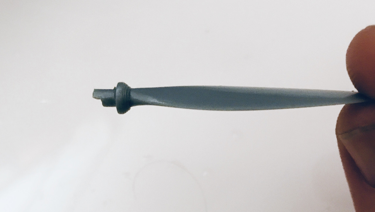

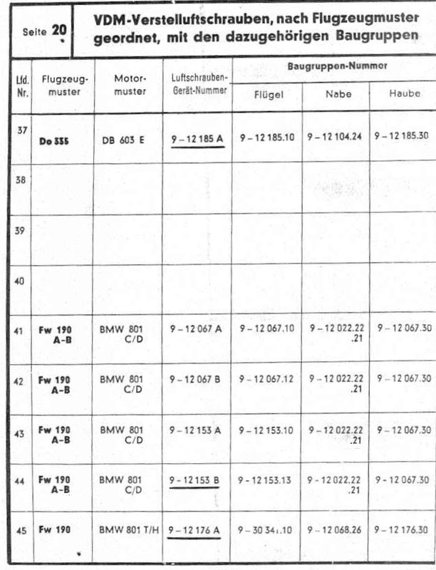

Reshaping airscrews by thinning blades goes hand in hand with seam removal. I used the thinnest square file to do the removal of the seam at the stepped edge of the VDM9 base. I am going to go with this being VDM9 metal blades for the moment. Maybe a sanding stick would be better. The flat needle file was efficient, though.
VDM9 on A-4
VDM types for the 190

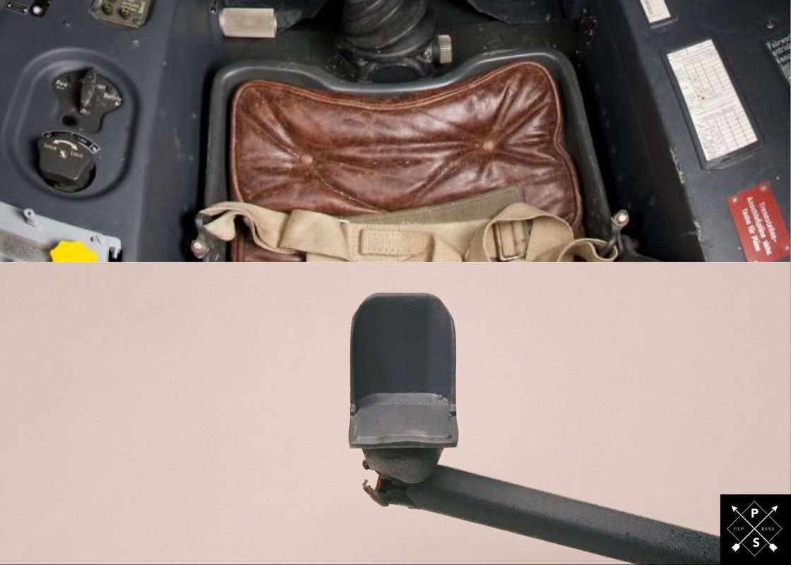

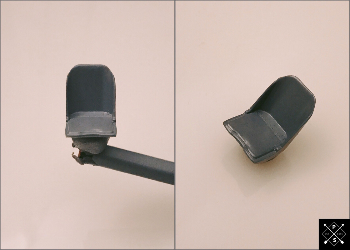

Color mix: Model Master Enamel RLM66 (#2079) + MM Enamel RLM21 (#2143)

Looks great!The schwartz(Grau)!
