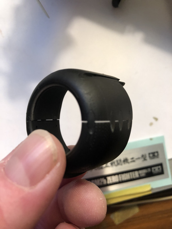

Have a look at the cowling:
It doesn’t fit flush. I wouldn’t normally sweat this because with some Tamiya Extra Thin I could have that squared-away no problem. But I wanted to have the cowling removable, and when I fit it over the frames, those minuscule gaps grow by about half a millimeter.

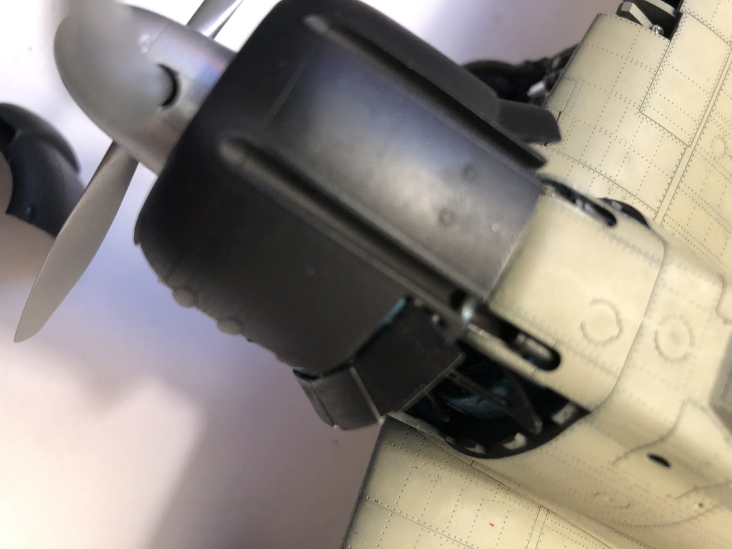

Furthermore, the cowling doesn’t fit 100% without some gentle coaxing, and it seems to me that it’s sitting about a half millimeter too far forward:
That’s easily corrected by gently nudging it back and talking sweet to it, but it exacerbated the gap problem even worse when the bottom of the cowling is added.
Now, I’m pretty sure I could jam that SOB together around the engine, and glue it up with no gaps or crookedness, but I didn’t put all that work in to super-detailing that engine to entomb it under a cowling.
I’m pretty sure this is my fault, although I’ll be damned if I can figure out how. For one thing, the arms that mount the engine and firewall to the airframe are indeed installed correctly, they mated-up beautifully aside from a small issue with the join from the firewall to the airframe (which I was actually able to correct fairly well), and from what I can tell, none of that brass I put in there is interfering.

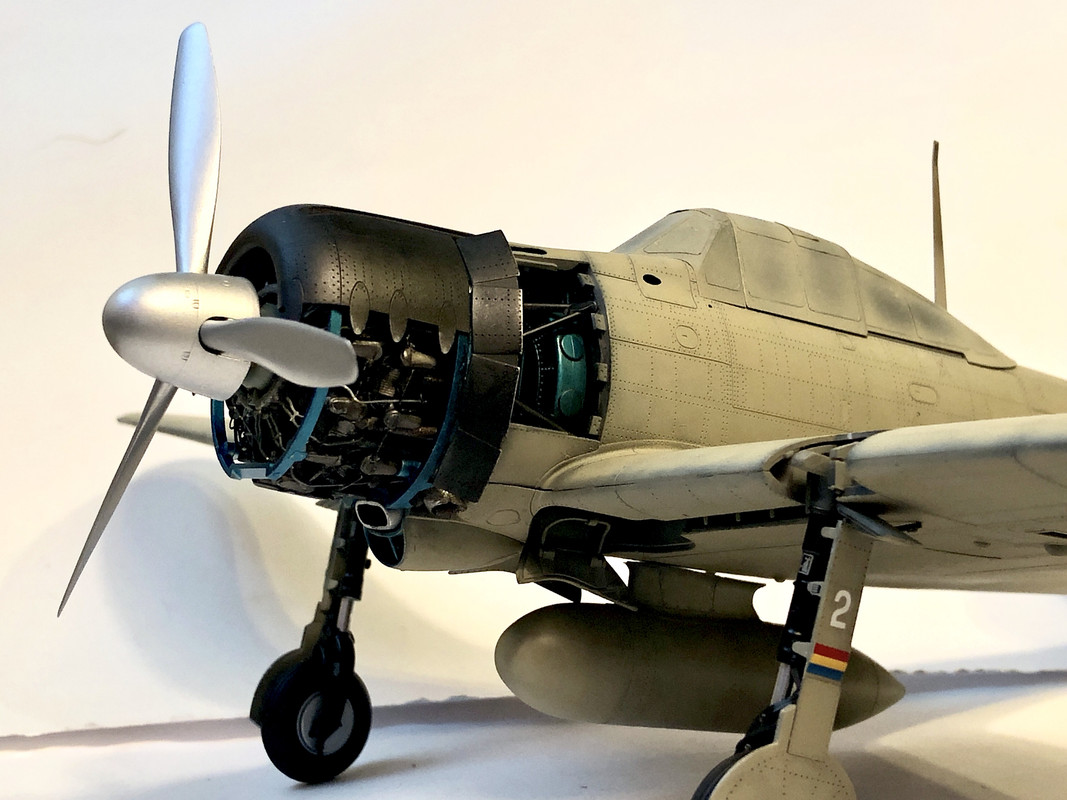

Oh well, I’m disinclined to worry about because frankly, this photo here, which was a one-off which I ended up really liking:
made my vision come to life in physical form. Seeing this photo after I took it sealed it for me- “This is rad! This is what I wanted to accomplish. I feel good about this work.” I sad to myself.
So I’m disinclined to worry about the cowling problem, and I’m leaning toward displaying the model this way once she’s all finished because it’s quite compelling to me.

Just a thought, but a little fine tuning work with some needle files on the contact points would probably clean up the fit issues.
While I did address the inside of the cowling parts, I did not address the actual contact points themselves where the cowling goes together. And Carlos, check this out— the brass details set comes with fiddly bits which represent those so really, I’ve got nothing to lose by getting in there and fine ruining them like you say because if I screw up, I can replace them with brass. I’ll give it a shot on your recommendation. I’m in no hurry to get this bird to the finish line. I’ve been having so much fun just working on it doing my best one subassembly or one painting job at a time. Why not.
I would display it like that too the bottom of that radial engine sticking out gives it a lot of viewing interest.
Right!? I mean come on! Why keep the engine detail a surprise? Let it all hang out! I’m still doing gentle sanding and filing here and there as I have time, to help straighten the cowling out, and to get a better fit for like a bonus, but as to the final display- It’ll be bottom-off. I love the way it looks this way.

Also depending on the size of your cojones I would be tempted to heat some water up not boiling but hot water and heat one half slightly to correct the mismatch. By fitting the one to the other you correct the problem without removing plastic. It takes several tries to do this... in order to heat the plastic all the way through so that it reforms. I have a feeling that’s possibly a part that was pulled a little too fast from the mold. I would try to get the pieces in alignment before proceeding.
But damn that photo with the cowl off makes my day! Bravo, Banzai Ken!
