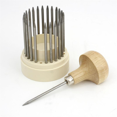

If you need to make circular rivets like I did on the leading edge of this 190D-9 wing...
I would recommend getting a set of jeweler's beading or setting tools...
Should be able to find a set on Ebay for $15 or less.

I have a feeling that the MDC punch is simply a re-labeled jewelry tool.

I second your “more than a feeling.” Thank you thank you thank you so much!
