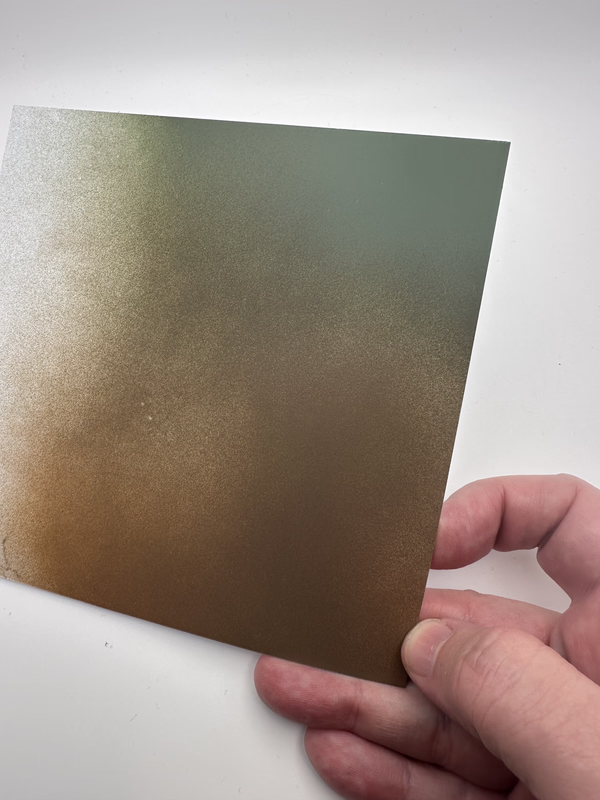

Thanks, Tom! I learned this from watching your work, Tom! I would see in the background of your projects that you would list your colors in a palette form with notes and I thought, "Okay, that's the right way to do this, if you're going use a system." I don't think I have it quite to your level yet, but I really want to thank you for the idea. I took a quick photo of my palette for the project:
The mix for the Olive Drab ANA 41 is Tamiya X18 (semi gloss) and XF4, which is totally an idea from Carlos, so thank you Carlos. I also have Gunze H7 for the red on the ring which is gloss and not shown here! The brown is Tamiya XF 52 Flat Earth which is as close as I can get to Humbrol's Brown Bess, whose number I cannot for the life of me recall. Help? Somebody? Anyway that's discontinued since the earth cooled but I would love to have it come back into the fold. I think once you get the mix right you need to be a little less than perfect with the application. Oops. I also noted XF-10 for Tamiya as well for the PC10 doped color which is pretty much the entire aircraft.

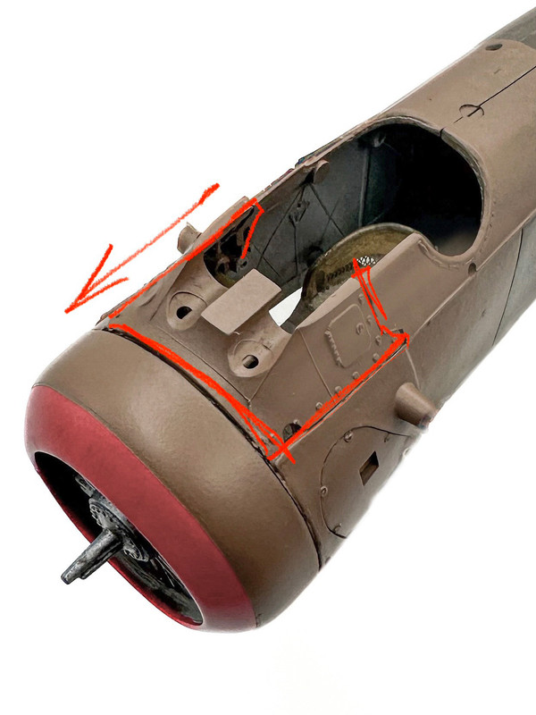

Literally had 15 minutes when my neighbors left and last light was coming down so I rushed outside and hit the PC10 mix on the cowling and exterior cockpit area, blending into what was already established months ago! FYI this is only held together with dots of PVA glue and tape. I'm using this to determine how I'm going to tighten the seams as well as get a feel for the final look. Almost all the cowling body fit gaps can be sorted by positioning the machine gun's deck forward; this leaves a gap on the camel's hump, but looking at reference I think I'll be able to hide that more easily there.
Addressing visible seams
Here what I've outlined in red will be the piece that I'll push forward to tighten the gap next to the cowling. It's far easier for me to hide the gap at the camel's hump than for me to fill the area at the cowling by using sprue and putty. See the image below of an actual camel for the bit of separation and braces that held the cowling in place. Want to keep that bit of separation without having to rescribe that area later and here's the way I'm planning to do it.

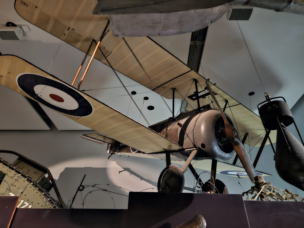

Photo Marius took of an existing Sopwith Camel! It's close! It's close!

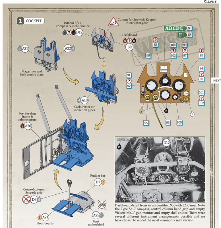

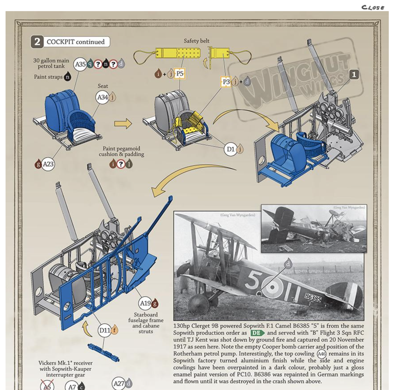

Here's a closer view of the actual aircraft!
Now it's time to complete the cockpit!

That is some excellent reference for the cockpit Bruce! :hmm: Looking forward to your work here. :wink:
Posts: 11579
Thanks, Carlos!! Looks like I'm going to break out the strip styrene and the cutter to make some spars and a deck. It looks a bit like a ship inside here so I'm going with that for now. Fabulous reference. I"m going to have to look back at the Tom's Modelworks PE to see what goodies are provided and how to make 'em. Thanks again for following along.
