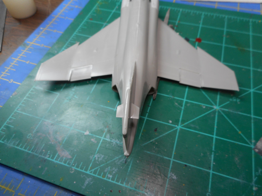

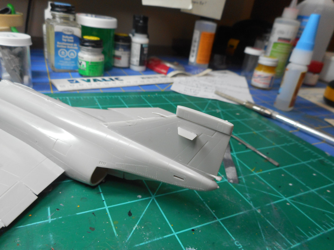

After a few days of deciding how to approach this dilemma, I finally made my decision on how to proceed with the tail fin. I chose to cut out the hole that I overlooked to cut before buttoning up the fuselage.
First, under bright LED lighting, I used tape as a guide around the fin hole where it revealed under a bright LED lighting. I taped the bottom, then top and sides. Next I carefully drilled several holes in a straight line. Next I carefully cut across with a #11 blade. Sanding I used a 320 grit strip of Testors sandpaper; top and bottom. Then I used 3 different files until I was satisfied the fin will fit through the hole. Last, I used liquid glue to hold it in place. All is left is a little Perfect Putty to fill in the very minimal gaps around the fin.
I pretty happy with the results. I'm actually surprised at myself I can do this little surgery.

Good recover Mav…
Re: British phantom FGR.2 "Firebirds"
You fixed the problem very well.
- Handiabled
- Master Member
- Posts: 591
- Joined: Sat Mar 15, 2014 7:13 am
Nice save!
Well done!
