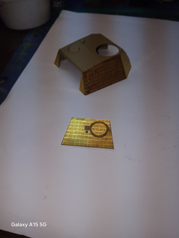

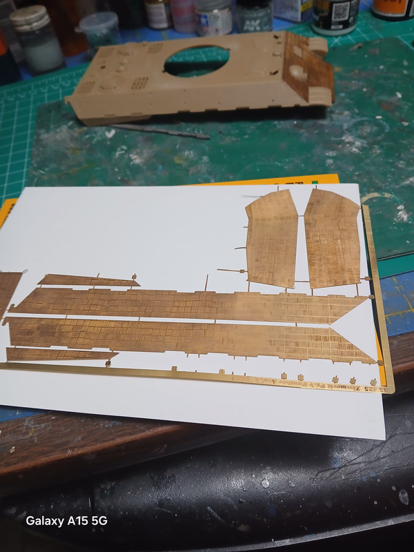

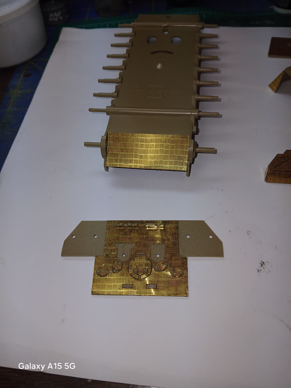

Im in need of advice/suggestion with applying the length of PE Zimmerit ony Panther kit.
The PE Zimmerit - the long ones...
There are notches for various stowage of sorts. The PE Zimmerit does not have holes/notches for them.
I'm not sure if I'm to apply the Zimmerit PE then drill the holes from.the inside(?)

I’d say to mark the areas on the PE Zimm where the external fittings go, based upon locations on the original kit base. Remove any locating pins off the parts and place them on the PE in the appropriate locations.

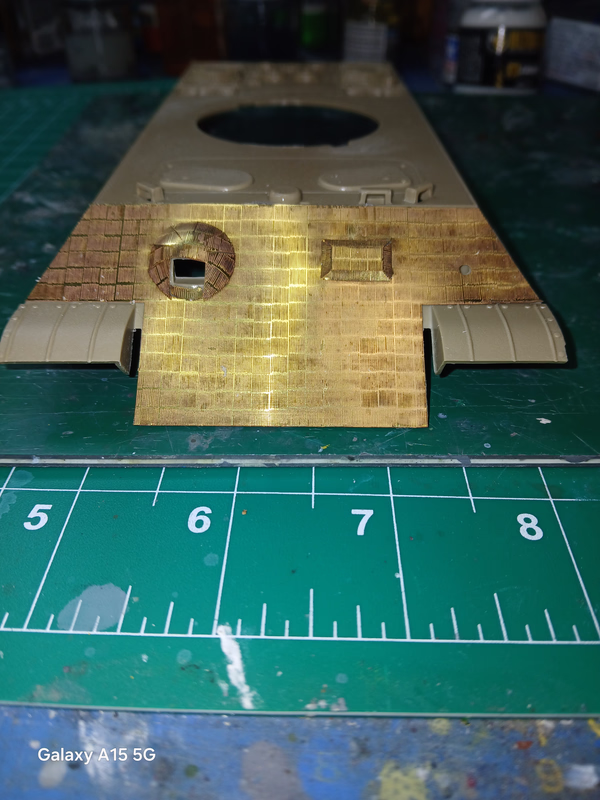

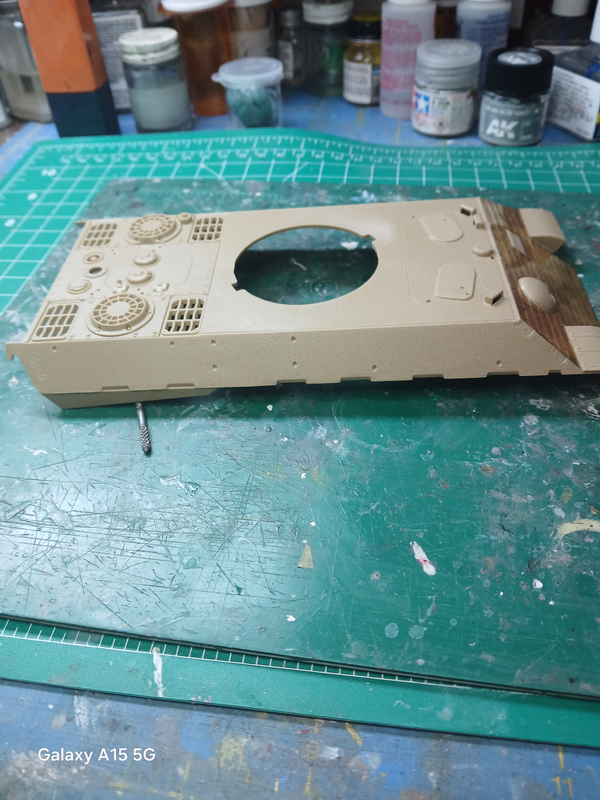

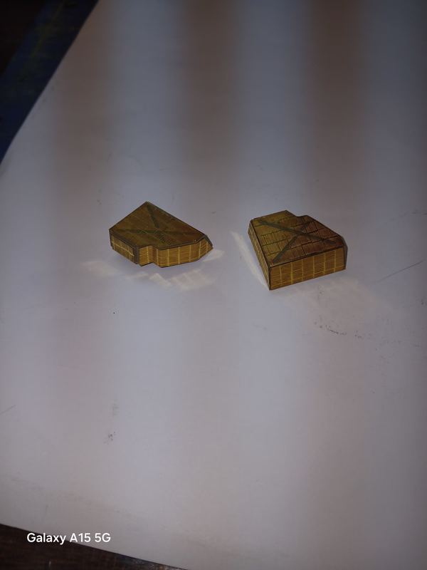

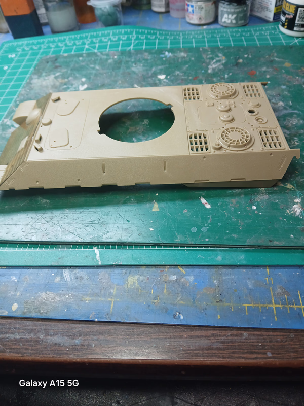

Progress pics of the PE Zimmerit that's been done off and on these past 2 months
I will admit, I use Gorilla CA glue on the difficult fiddly spots. Used an old paint brush to brush in small.areas.
All is left is main gun barrel mantle and sides of tank body.

Looks pretty good Tom. The glacis plate ball MG mount looks a bit funky, but the rest looks the part.
Re: Panzerkampfwagen V Panther Ausf. A
Yeah. Had to find a steel ball or marble to do that. I found a marble at work and used it. Instructs you to roll the ball around the PE MG amount to shape. Did the best I could.

Once all the PE Zimmerit are on, is there something I need to prep the PE for paint?
Posts: 21526
BlackSheep214 wrote: ↑Tue Nov 18, 2025 6:13 pm Once all the PE Zimmerit are on, is there something I need to prep the PE for paint?
Maybe hit it with some lacquer thinner first to remove any possible coatings on it. Then it’s gonna need a serious primer coat like Tamiya.
