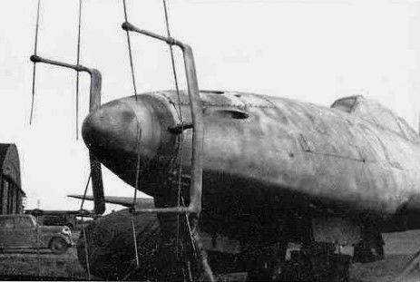

Great idea with the premade wire bundles. I'm excited to see what you do with the gear bay. Have you thought about depicting some of the panel line putty cracked are falling off? Or are you going to leave all the panel lines open? I know from a modeling standpoint showing panel lines is more interesting than putty but worn putty could also be a good compromise with visual and historic. I personally would show all the panel lines open to have more surface detail.

John—are you thinking the nose area will have visible rivets? That seems possible, at least. The rest of the aircraft seems smooth with fine yet visible layers of putty and a thin, patchy paint job...

Thanks guys! I will be depicting all panel lines and rivets. It would be very difficult to depict uneven putty application and I'm afraid it would simply result in what would look like sloppy modeling. Plus you probably would be hard to see such effects on a mottled camo. The reason I am adding panel lines and rivets is not necessarily to reflect real world conditions but as a concession to the visual impact of a scale model. I want to convey size/weight/complexity and one of the ways I can do that is to add surface detail to the model.
