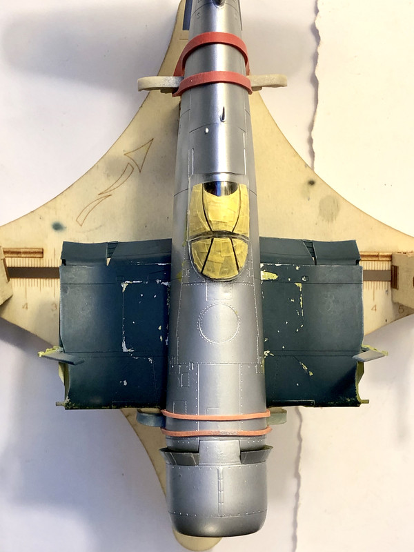

I am still trying to work out how I will do the chipped zinc Chromate primer bit without sealing this layer and using hairspray. I’m considering:
1. Applying the Zinc Chromate with a sponge to get me the chipped to bare metal look I’m after
2. Fill-in some areas in the chipping zones with Zinc Chromate so that I can chip and scour down to primer only AND chip all the way down to bare metal
3. Smooth that all out with the microfiber pads going from 3,200 to 12,000
4. Then seal with Mr. Hobby Super Clear
5. Then apply hairspray
7. Apply shading and basecoats
8. Chip and scuff down to primer in selected areas and chip and scour down to bare metal and chipped primer in other areas.
Doing it this way eliminates the need for Mr. Surfacer -the AS-12 is my “primer”-, it eliminates the need to seal the bare metal, it eliminates the need for hairspray under the Zinc Chromate, and will theoretically get the job done in fewer layers. I paint in layers but layered multilevel chipping to primer and bare metal needs an unwieldy amount of layers, seems to me. I dislike that.. Combining the model’s primer X bare metal X chipped Zinc Chromate into one layer of AS-12 with the Zinc Chromate applied with a sponge on top eliminates a lot of layers. We’ll see. I’m still testing this out on Reggie and Doug. In the meantime, I like looking at my Corsair in this state because as of now BIG HOG is sure looking pretty. Thanks again for that recommendation of AS-12!

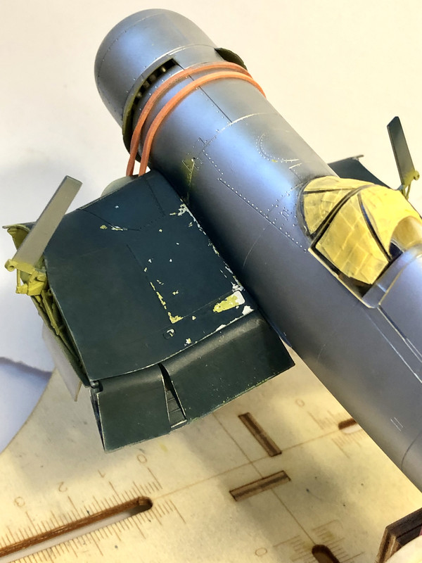

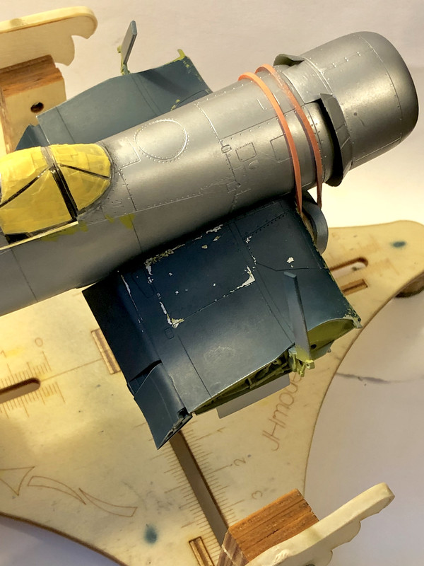

Thank you, Stewart. And I take back every mean thing I ever said about NAVY Blue/Gloss Sea Blue. That NAVY Blue looks lovey all chipped up and scuffed. I just had to adjust how I painted it.
I’m happier with that weathering than I was with my previous attempt at a Corsair. For one thing, his was a much more organized, disciplined approach and it paid off. For another thing, that AS-12 is a magnificent chipping base. It shows so well but it doesn’t try to take center stage and steal the show. I’m oping it’ll look nice with the wings folded. Just a little visual interest in there among the shadows. I think it will.

You hit the nail on the head, my man, and thank you for that comment. Seriously. It feels really good to hear a modeler I admire and respect echo a sentiment I’ve been holding tightly on to.
And I’m not going to lie- it wasn’t easy. It got sketchy and scary for a moment. Applying unthinned Tamiya paint with a sponge leaves a noticeable texture in the paint being applied. Thank goodness I was in Wall-to-wall conference calls this afternoon and had time to gently smooth and polish all of that with my microfiber pads. And I’m pleased with how the AS-12 held up under that without benefit of primer. I’m calling this experiment a success- the bare metal and “chipped” zinc Chromate encompass one layer themselves instead of a layer of Mr. Surfacer, Bare Metal, Clear, Zinc Chromate, and then more clear. It was worth the effort, 110%. And it wouldn’t have happened had it not been for your recommendation of AS-12 and you saying to me “Your work deserves better.” Thank you my friend. Thank you so much. I owe you a lot. A whole lot.
