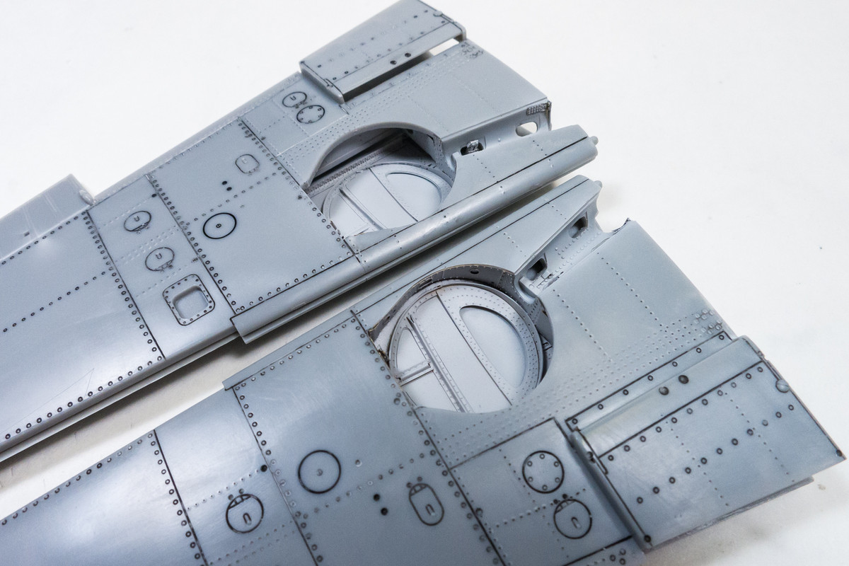

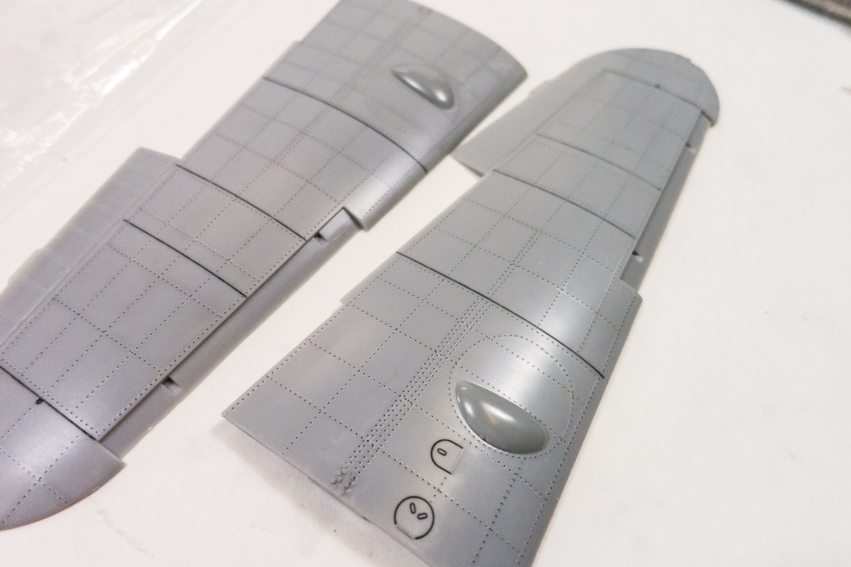

Some preliminary removals were in order... the raised wheel well detail on the inside surface of the top wing and the wheel well walls from the wing bottoms. The removals are described in detail on the RB Productions instruction sheet, which is very detailed but the details in the photos, which are probably copies of copies of copies, are sometimes difficult to discern.

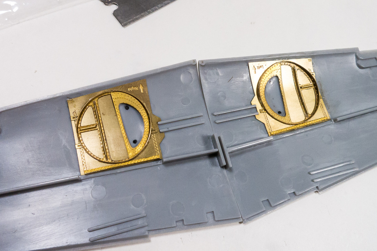

A bending tool like this Small Shops Bug isn't absolutely necessary but is very useful in making folding easier and more uniform.
Some bends take a little creativity and for this tricky u-bend, I used a strand of stiff plastic from a hairbrush to form the "u" around.
The roof of the wheel well features several layers of brass to help increase the visual depth of the enhancement set.
It usually takes a few iterations of fitting and shaving plastic to get these things into place properly. The main thing is to take your time and not force the brass since the pieces are quite thin and delicate.

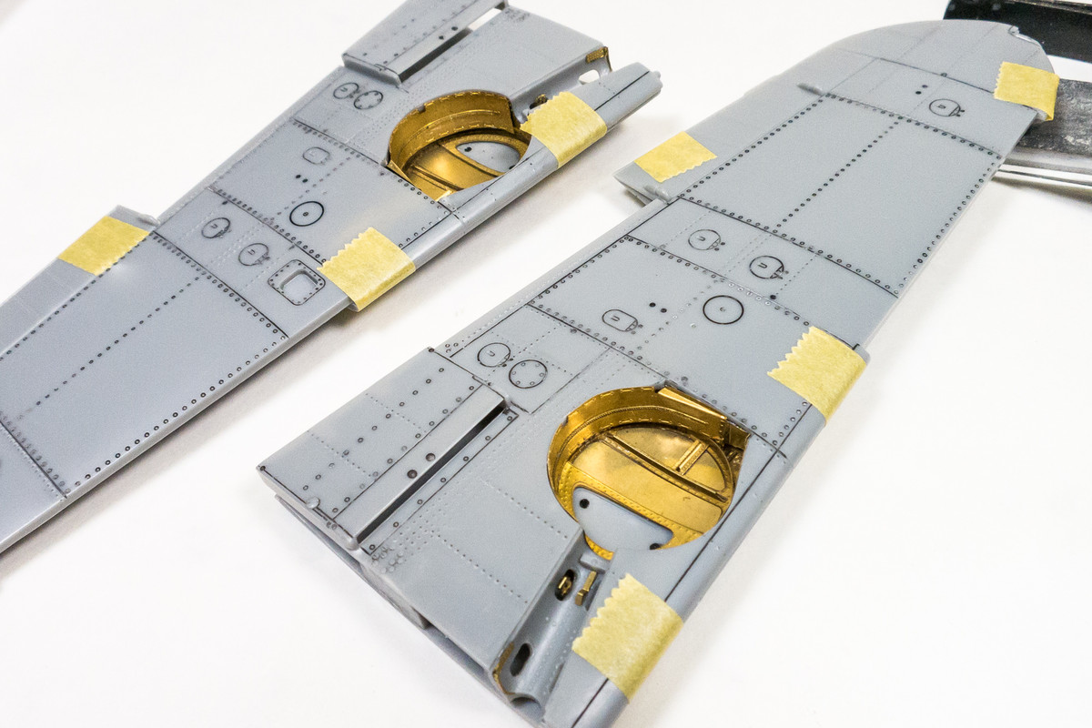

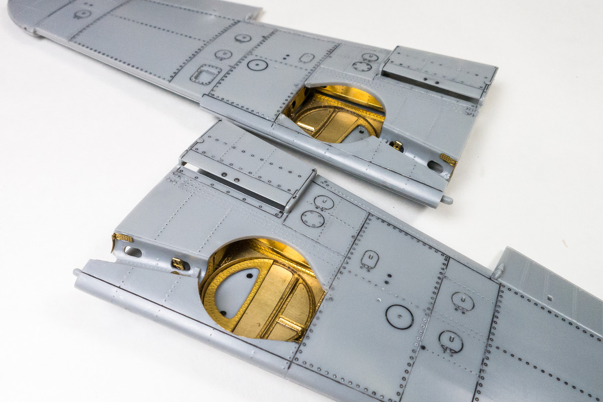

Once the fit is figured out, you can see how the new wheel wells look in place. I've elected to keep the u-shaped trough that houses the landing gear legs in plastic rather than using the brass piece. The oval openings were drilled out.
The PE set provides an optional canvas covering that you sometimes see in the wheel wells of the Bf109. I think I'm going to use them, if I can work them into place. There is some inconsistency with the fit of the rear wheel well wall that the canvas cover will conveniently hide.
