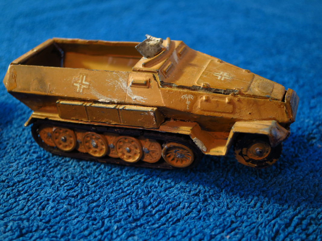

I have always liked the 251/1 but have not, since I was like 12 years old, built any. The one I built back in the 1980 was a Matchbox kit, scale the slightly odd 1/76. While visiting my parents Christmas 2012 I found some boxes with my old kits... And indeed, the Hanomag was also in the box....
I remember when I built it and glued the frontwheels in a turning angle. And my friends just kept on asking why the wheels are not straight forward.. :-)
It was painted, with Humbrol enamel colors to look like being part of the Africa Korps army... It broke couple of times, dropped on the floor etc and the fix was not that great...

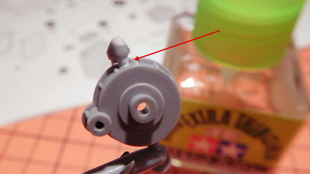

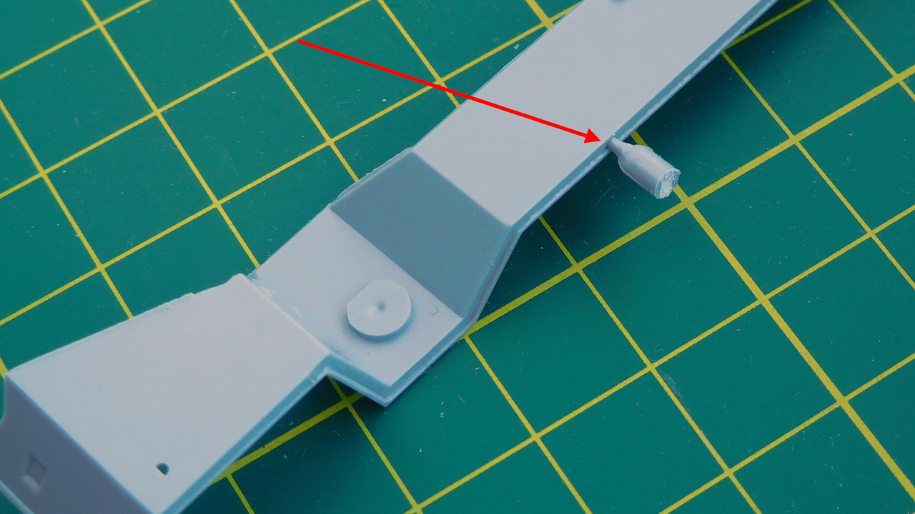

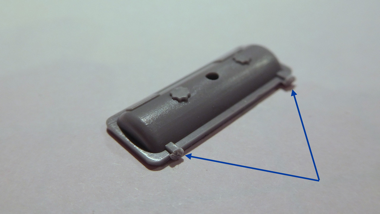

One thing that is though a little bit annoying with this kit, the spure gates are in a little bit awkward places..
Not a show stopper, just need to be careful with removing them, as the piece behind has different levels the sprue gate is touching..

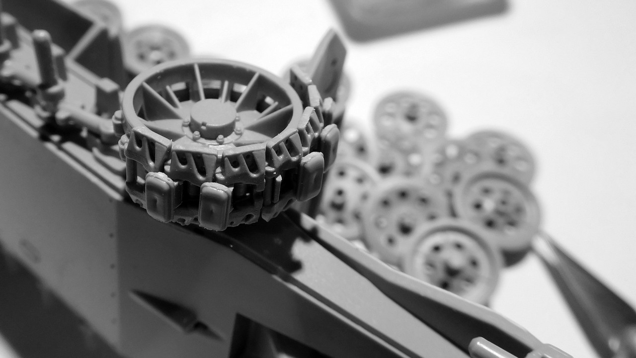

What I have been doing.. First of all, there are pretty many pieces that need to be removed and cleaned well. As I am not in a hurry, I do some cleanups during a day. For example, the wonderful tracks, I try to make two "sets of 3" every second day... Not to get bored in other words.. :-D

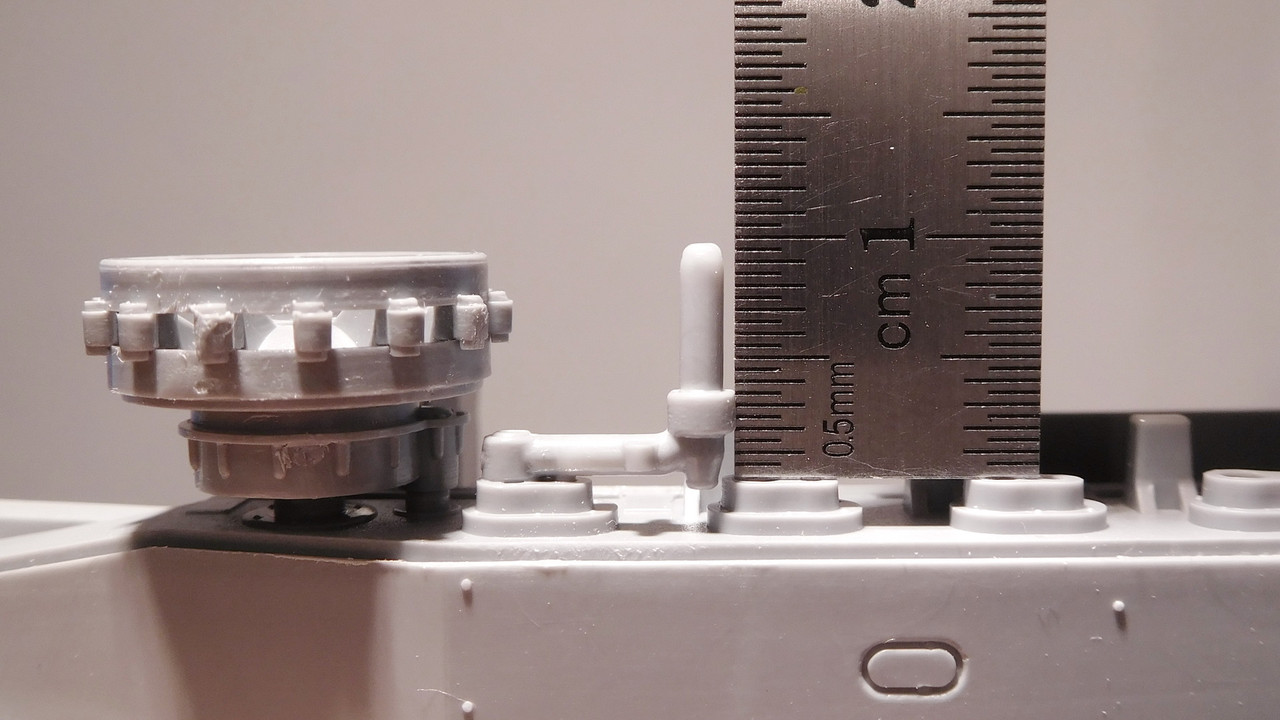

Today I continued the build, adding all the shafts.. Not that easy, as had to figure away how to make sure they would be in perfect horisontal angle.
A tideous work, but slowly and surely the work was done.

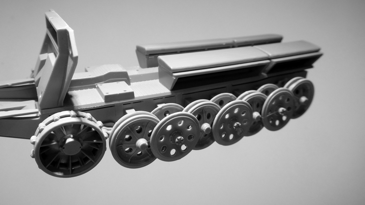

And finally the the work was done, tested to add the roadwheels, just to see how they fit... And they fitted very well!
Still work to do, and no hurry, no stress... slowly and surely....

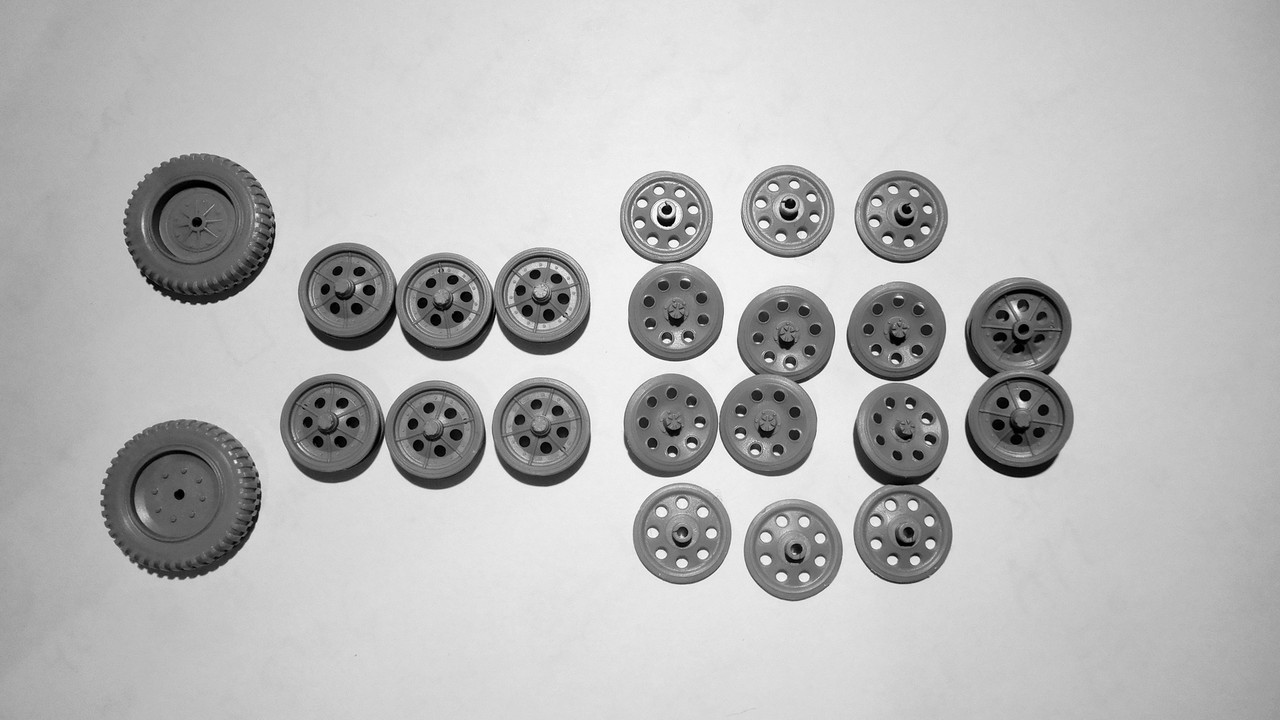

And group pic of the roadwheels...

Very nice! Those sprue attachment points look like they’ll need needle file work to clean up properly. But the detailing is worth it. A lovely looking build so far!

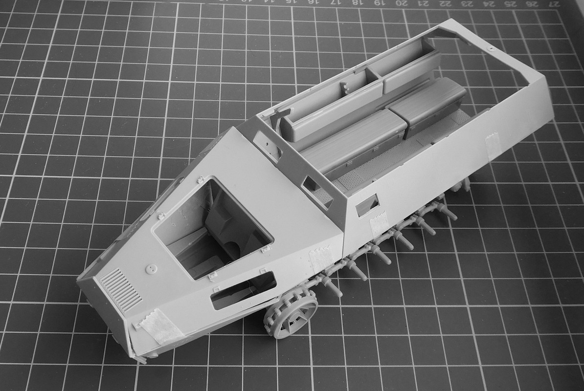

And brief update of testfitting...
(and from now on, until painting show starts, as b/w )
Here and there some white powder, residual that needs to go off.

Amazing photography, Kari—quite beautiful in black and white! What you wrote about the softness of plastic resonates. That is, indeed, similar to the Dragon! Each kit we build has a different substrate, and we have to adjust our working method accordingly!
I find that the trace markings of any sanding session must be sanded and not polished with the softer plastic surface being far more easily affected by every attempt to shape it. Carlos mentions needle files—I did find I had to use filing on edges and corners in exposed areas so far. I have only glued eight sides together.
The “nose” area looks a little tricky—the old “one side fits; the other doesn’t,” but this may be the result of taping the sides. One aspect of working with softer plastic I was wondering about would be what happens when steamed or heated gently in boiling water.

the nose area is tricky and needs to be glued in sections. There is also a bunch of masking tape inside, but the entire construction is really shaky.. took a minute or two to be able to keep it about the shape so I could take the pic.... But that is pretty far in the future, that I come this far...

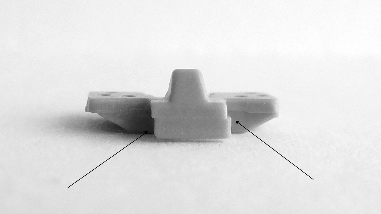

When I started to make the tracks, I noticed this...
A slight misalignment causing a that the track piece does not really fit in the other part...
So I need to sand every single piece.. checked on the other sprues and same misalignment exists in all sprues..

Zvezda—those tracks! Ugh, ugh, ugh! No good... so much more work for you, Kari. How will you cope with the missing section? I see yes you will be able to reduce one side, but what about the other? Will that affect the tracks?
