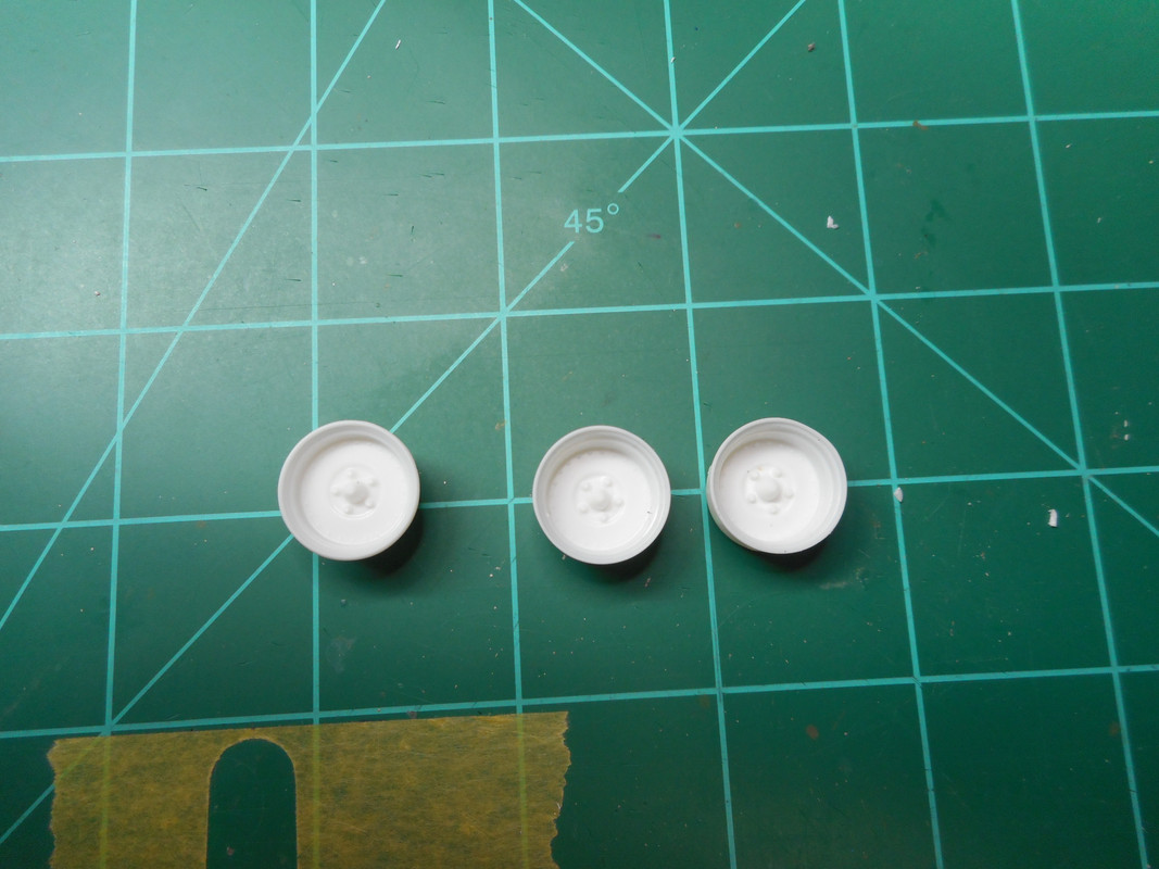

I came across the rims I think would look awesome for this '55 Bel Air - see box cover. Where did I find it? Why, they were in with the kit molded in white.

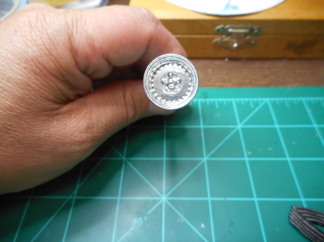

So, with not having Alclad on hand to go chrome, I used the Molotow Chrome pen.
Here's before painted chrome....
One rim painted using the Molotow Chrome pen... (Yes, it's still wet)

I'll be in on following this build Tom. I've heard and read a lot about this kit. Your Molotow application on the wheels looks good straight from the pen. Just so you know this stuff, when dispensed into a paint cup, goes on really smooth from an AB. Not being prone to handling after applying is one of Molotow's weaknesses but this has been addressed lately by the use of Spaztix Ultimate Chrome Clear that can be airbrushed on afterwards and it doesn't tarnish the Molotow. I'll see if I can find the article or a discussion thread if your interested.
I applied Molotow followed up with SUCC here on my rear wheels for my '56 Ford:
Straight Molotow Dispensed and shot thru AB:
After SUCC:

Lyle:If I’m not mistaken it’s alcohol based so it cleans up with Windex. No thinning necessary when shooting thru an AB. That’s not a pen in the picture. It’s a 30 ml refill bottle. Just shake ‘er up and dispense into the paint cup and you’re set.
