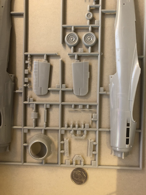

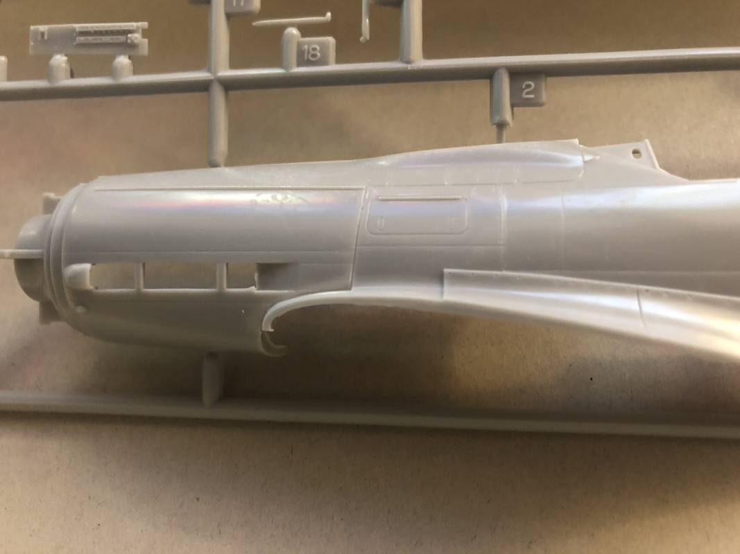

I have been working on the Ta152’s Jumo. But before we get into that, I’ll show you a sprue shot here:
The plastic is sturdy and the surface detail is very nice. Good panel lines. And note the dime down there, I put it there with the IP for a size comparison. To-date this will be the smallest IP I’ve done. It’s a little intimidating but I think it’ll be okay. The other cockpit parts are small too (obviously) but the detail is about as crisp I believe as you’d get it for the time during which this kit was manufactured.

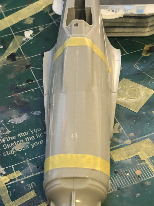

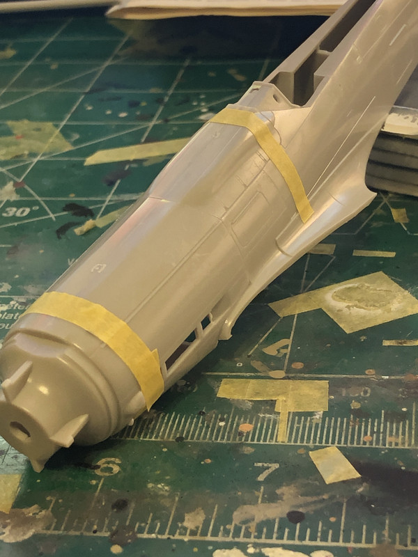

I mocked-up the fuselage, expecting for issues here and there, but I actually didn’t find any at all! Both sides meet up beautifully. I had to clean up a little bit of flash along with nubs from the sprue gate but no big deal at all.

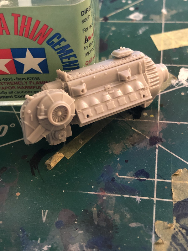

As to the Jumo, I’ve got it about half-way assembled:
I had trouble getting the plate that goes onto the bottom seated properly. The only place a positive fit was available was on the rear. What I ended up doing was cutting a piece of sprue, sanding both ends flat, and gluing it toward the front, with a shim glued on top. That gave me a little platform for to allow the plate to rest on. That worked pretty good!
I’m building out the Jumo before painting it up, because I’m anticipating fiddly for work when it comes time to attach it to the aircraft via the mounts. Those mounting pieces are made of metal. I anticipate having to perform surgery on the parts here and there in order to get them all fitting well, so I’m the interests of all the handling and dry-fitting and whatnot, I’m opting to build it first, test, fine-tune, etc. and then paint and detail it up. As you know, I dislike fiddling with parts which have already been painted and detailed -a sentiment further reenforced after super-detailing and mounting the Sakae 12 in my 1:32 Zeke).
So that’s where I’m at, at present! The next few days will see the completion of the engine, and the test fitting.
