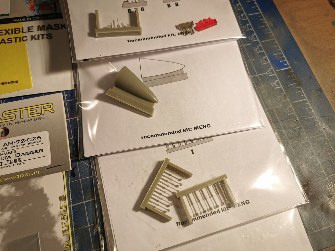

yesterday I started my first commission build ever. @speedgraflex asked me to build Meng's Convair F-102A Delta Dagger. We ordered the kit and a lot of goodies to improve the kit quality which is already pretty good. The Meng kit is supposed to be the best F-102 kit available in 1:72.

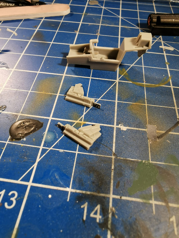

First assembly group is the cockpit. I prepared the main part for the pretty nice Eduard PEs and added some to the floor. Now the question is which ejection seat I wanna use. The one off the kit with PEs or the Pavla resin one? Or bashing both? Difficult, but the Pavla seems to have a body-in-white issue, fitting in height and width are suspect.

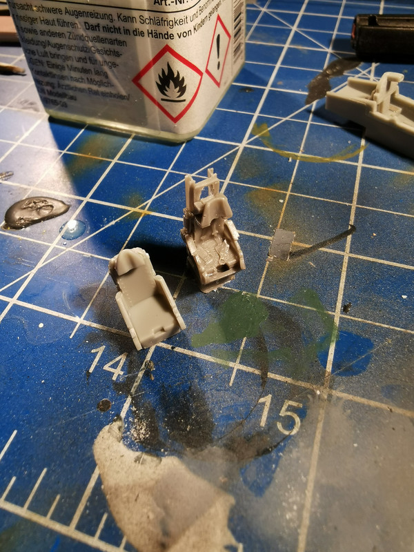

Yesterday I modified the headrests on both seats as there shape was too edgy.

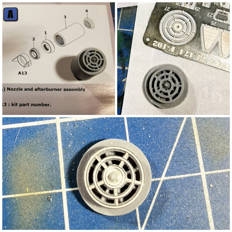

Also I combined the Wolfpack and Eduard engine parts.
Now some parts are ready for painting.
