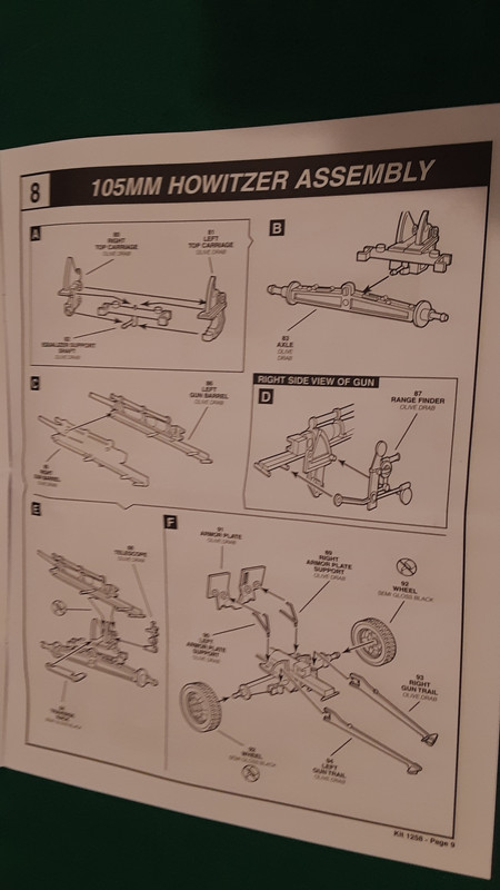

The instructions.

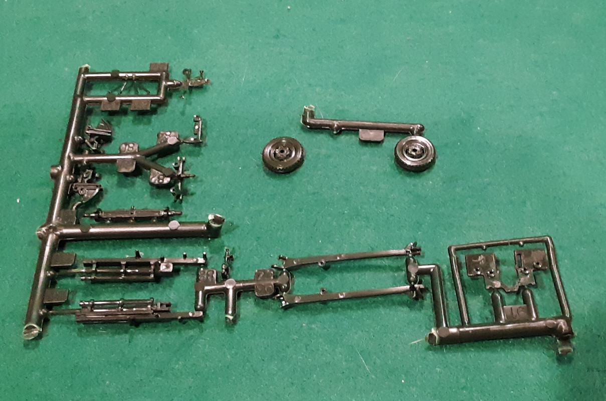

The parts, lots of flash to clean.

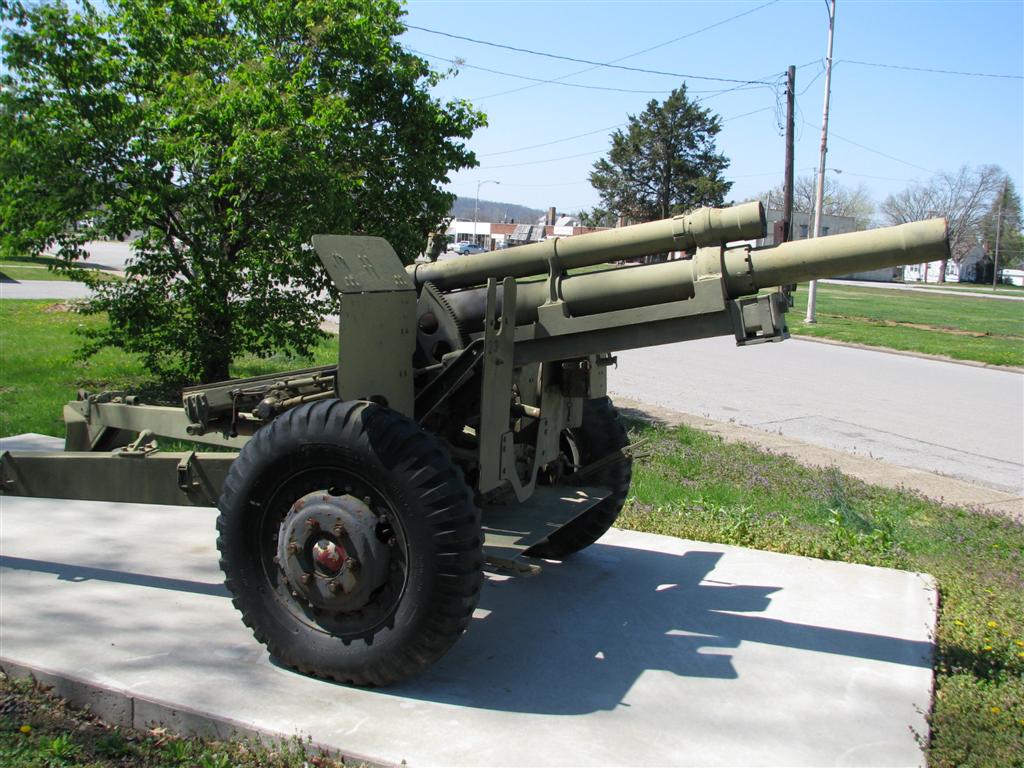

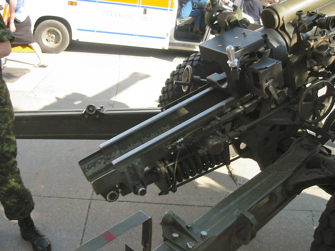

Here are photos for inspiration.

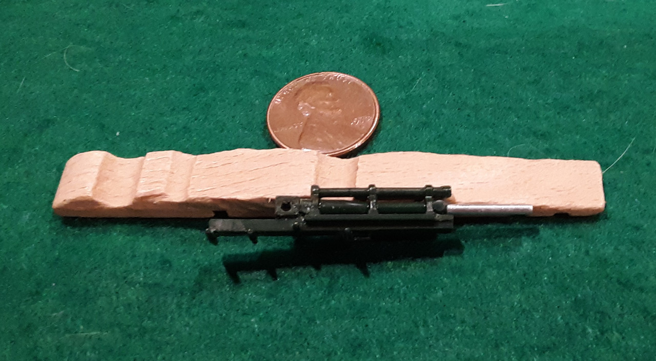

I have been working on the 105. I glued the two halves together and have been making adjustments and correcting some missing detail. I removed the kit barrel or at least the very end of it. Specs I found stated the barrel is 7'7" or 2.31 meters. At 1/72 scale that's 1.263 in. I cut 1/4 inch aluminum tube the correct length and drilled a hole in the slide where I removed the kit barrel. 105 mm scales out to be .057 inch but I enlarged the the hole to .040 and called it good.
