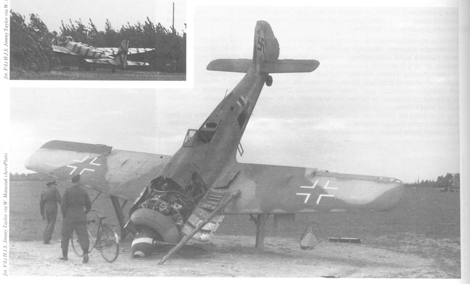

In other photos the tank is sitting on the ground a few meters from the fallen nose - and pointing toward the buried IED the Germans left behind for the Allies. The bomb did go off and kill members of a tow crew attempting to move the aircraft.
This... is a sobering photo when you take into consideration there is an unexploded bomb beneath these men and the photographer and whoever else was around.

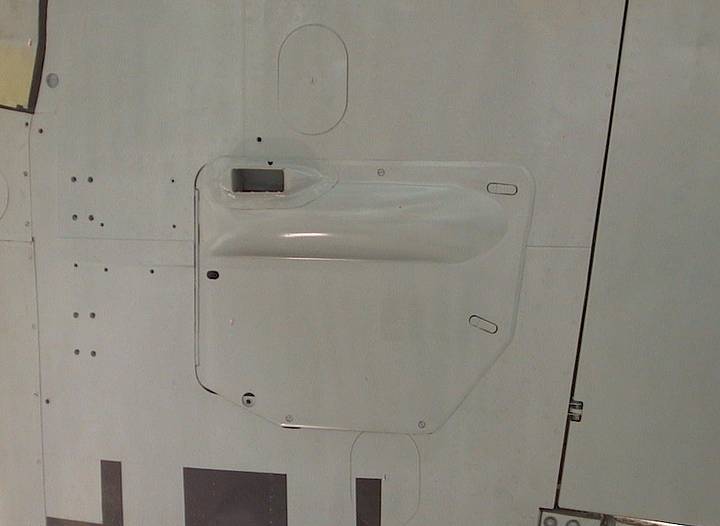

Thanks so much for your comments, John. Yes, I am planning to recreate the aircraft’s position. I’ll be looking for a small base to pull that off—initially I debated calling this a diorama and setting up in that category here. Ultimately I decided to keep this as an aircraft build and went forward from there. I agree it will be much easier to work around the fit issues. Looks to me like I will have to cut open an underwing panel. I assume that has something to do with removing the magazines or the machine guns? Any ideas? Thank you for letting me know about the riveting! Cheers!

The Doras and Ta152 did not have those outboard guns so I am unfamiliar with them. Actually... I'm not one to pose ANY access panel open so I tend to not pay much attention to those parts of the aircraft anyway. Don't know much about it but it appears to be the outboard gun hatch. Not even considering what is inside that space, just getting the hatch cut out and fashioning the funky-shaped panel with bulge and portruding ejector chute looks like trouble to me. So much so, that if it were my project, I would opt to keep the hatch closed and show the aircraft in its pre-salvaged condition. Definitely advanced level scratchbuilding required unless there is an aftermarket set available.

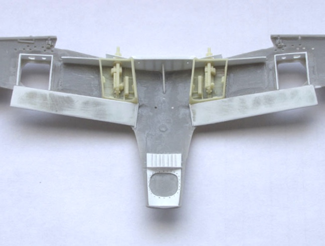

Thank you so much, John! Happy Father’s Day! I personally feel like you do that opening up the panels of an aircraft spoils the lines of the design in many cases. However, I think this is an important exception. I still would like to make the attempt to open the compartment, perhaps adding simple framing such as was done here with a 1/48 Trimaster kit:
You mention resin aftermarket and I think this is one way to go! Even though this was used in closed position, that certainly looks like CMK cream resin to me.
I just spent ten minutes on eBay looking for resin pieces without success. Perhaps I can scratch what is needed by taking part of the existing piece and attaching it to a new panel. Based on the walkaround views I think this would be possible.

New suggestion. Look for some Eduard overtrees for that kit. Get a second underwing panel if you can. Use one for the doors only, and on the other one cut out the door openings. You can combine the two together.
