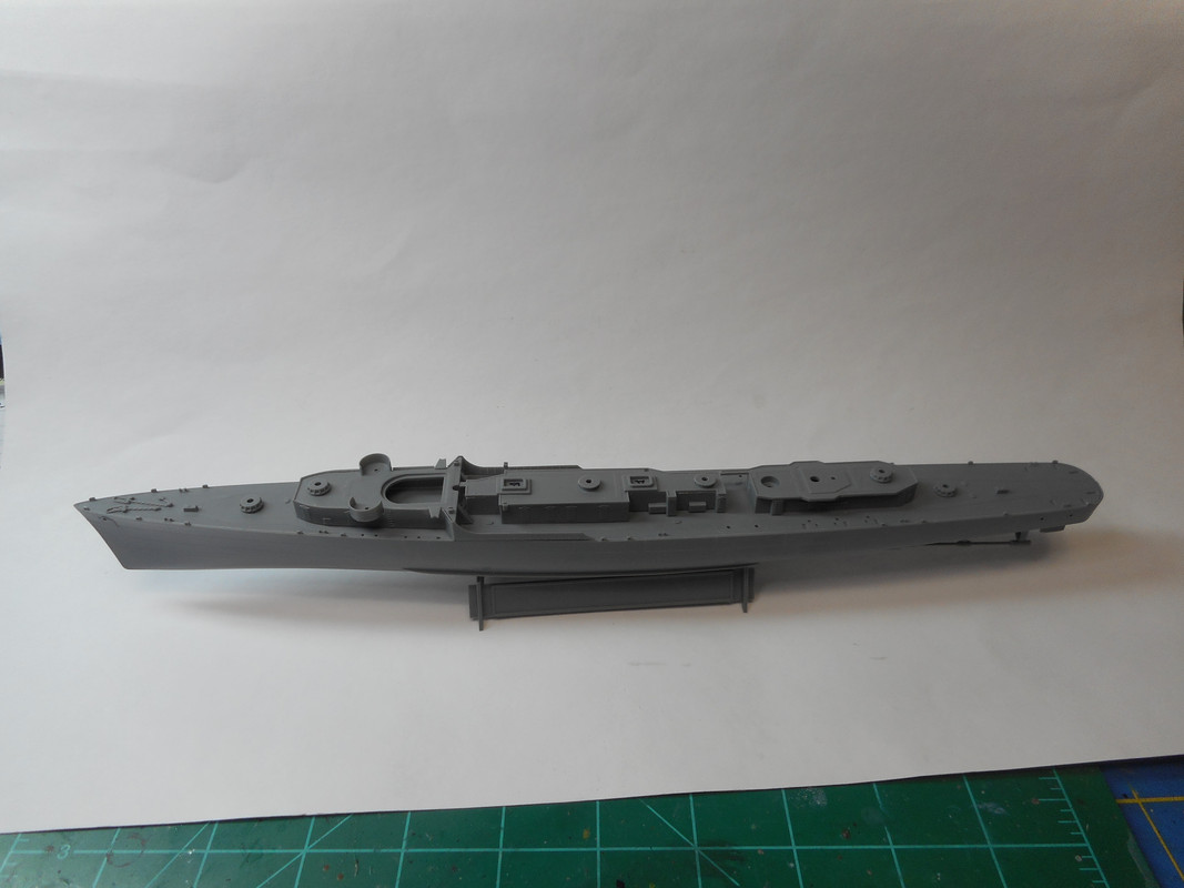

Deck to hull, all deckhouse sections assembled but not glued to deck - fore, main, and aft deckhouse, guns minus barrels, funnels, radar pod to main bridge and depth charge racks.
The aft gun platform (on left) is incorrect for the Wadleigh.
