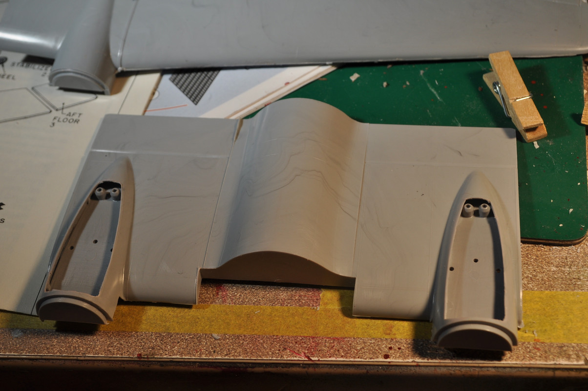

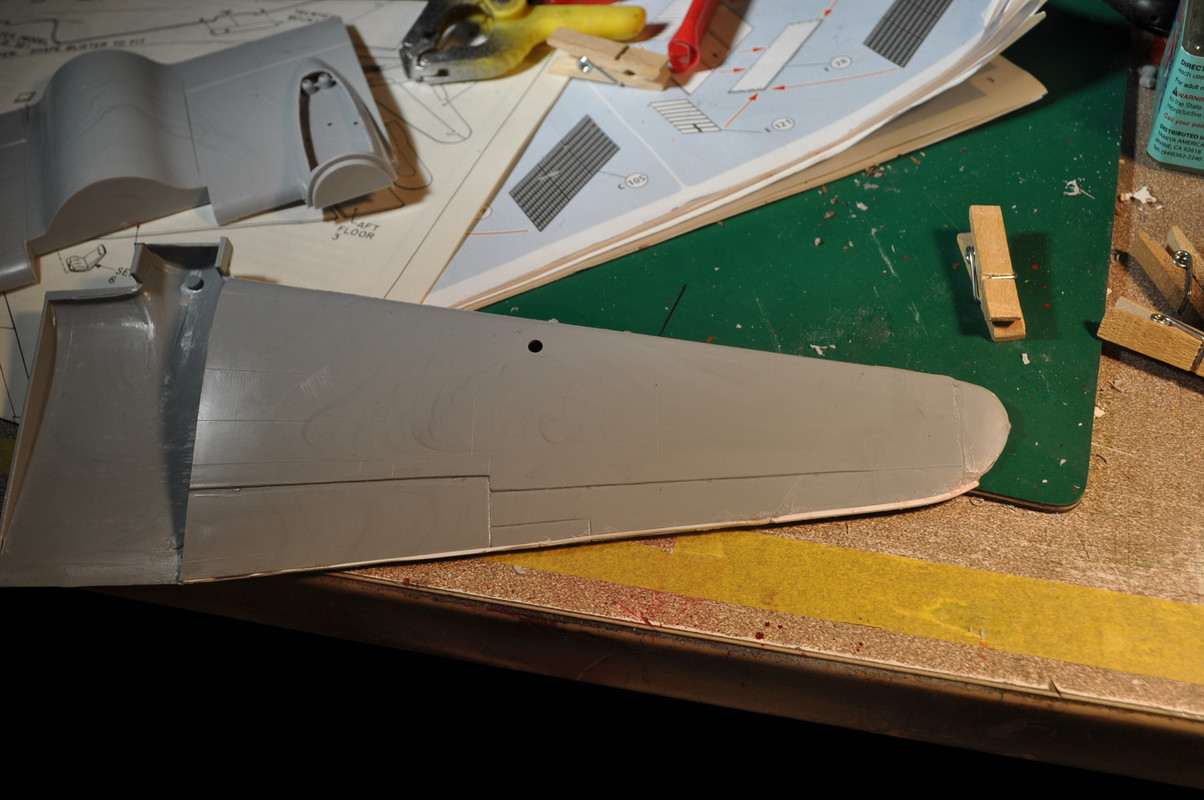

So far, I've managed to cut out the gear doors and get a wing half together.

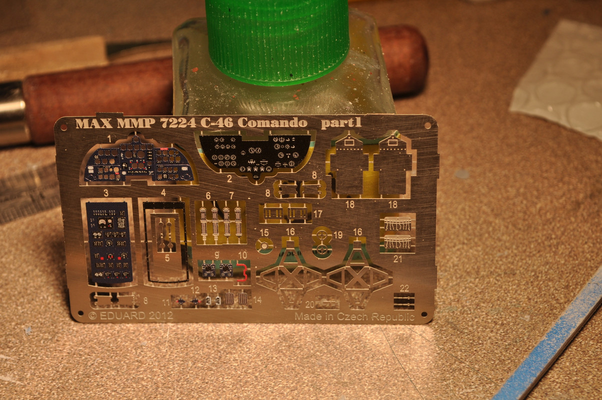

....and, if it being a Williams Brothers kit wasn't enough.... we have photo etch! Yay for me..

It's best to make a new cargo floor, the kit parts don't fit well. Also, I spread the fuselage on the bottom behind the wing to get a better fit, and to keep the proper contour in the side view. The PE is a nice addition.
