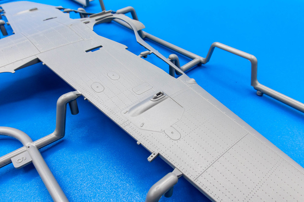

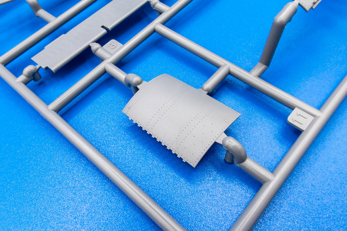

Let's take a look at the sprues. It's as educational to me as it is to you and helps me get acquainted with the kit parts.  First up is the wing sprue.
I was interested in this kit when I first saw the sprue shots. I was really impressed with the crispness of the moldings. And that's been verified now that I have the kit in hand. Very impressive molding.
Note the underwing gun bulges that are specific to the A-6 variant. If you look at the photos of Nowotny's machine, there is no evidence of these outboard guns. The A-5 outer gun panels are a little different than the A-6 but still feature bulges, which I do not see in the photograph of Double Chevron.

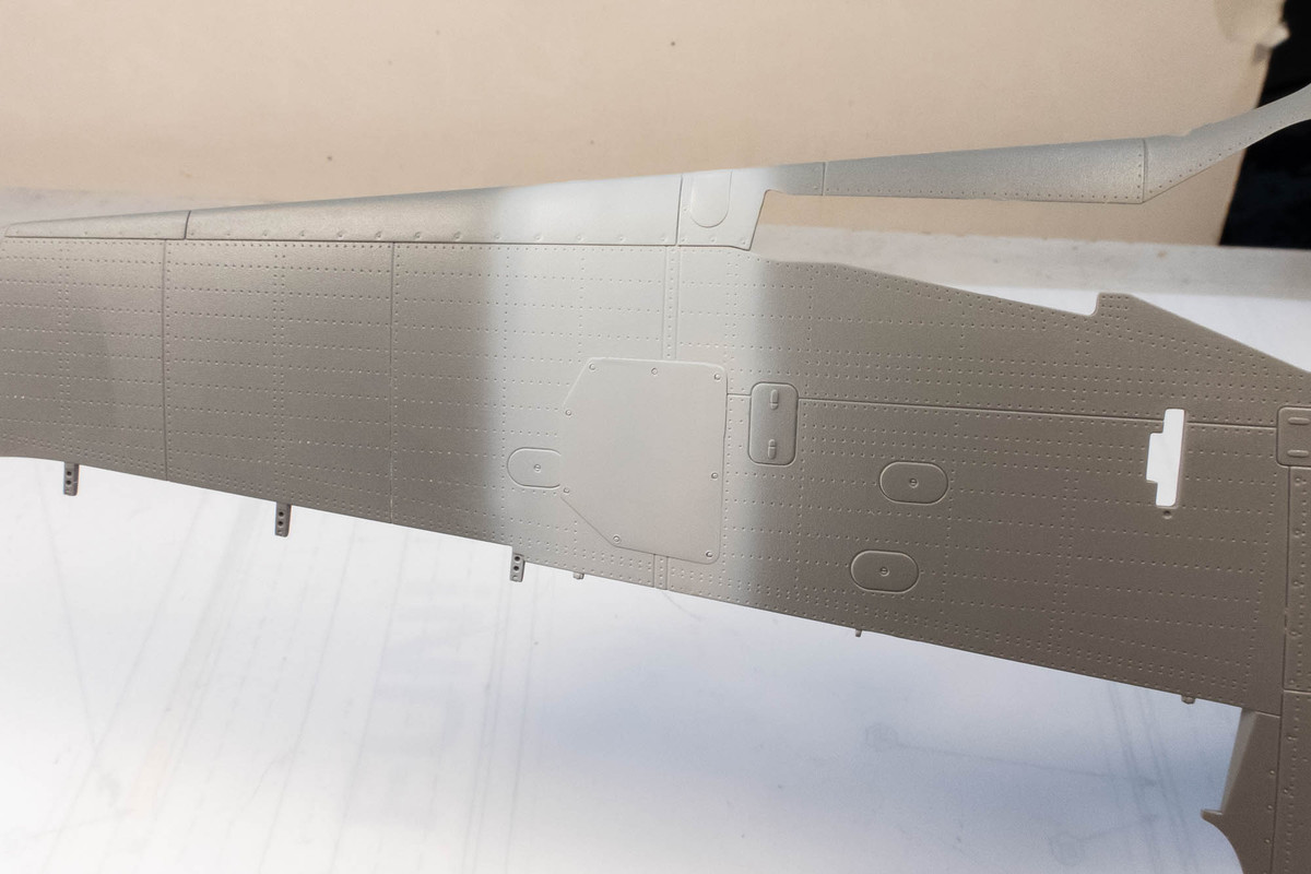

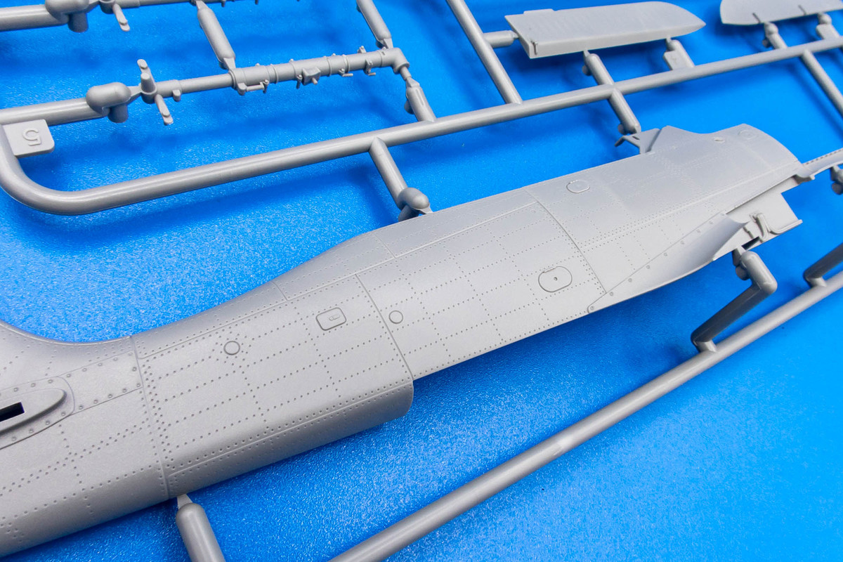

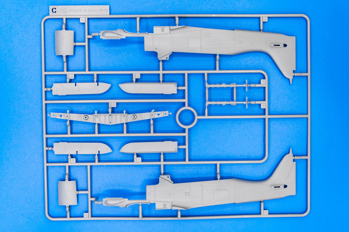

This sprue, C, holds the fuselage halves.
Panel lines are recessed and rivets have been molded, indicating kindship with its Trumpeter and Hobby Boss brethren. However, the rivet detail is noticeably finer than what I found on the Trumpeter P-47D kit.
Molding is super crisp throughout, with super sharp edges everywhere, which will make painting that much easier

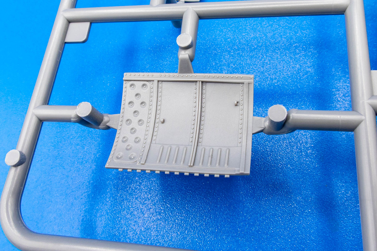

The engine cowling has molded detail on both the outer and inner surfaces.

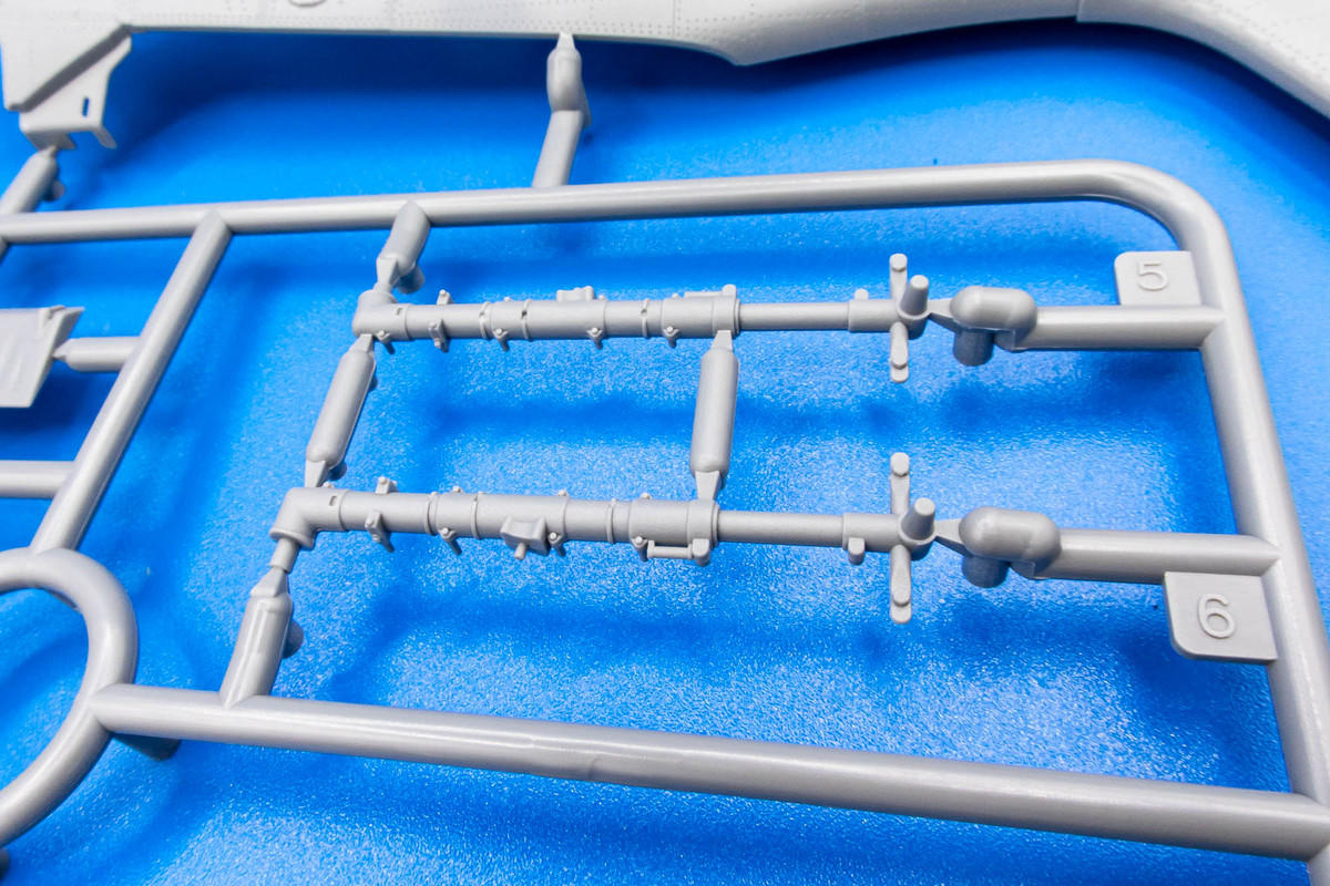

The landing gear legs look good. The Border plastic is on the softer side so I hope that these skinny legs will be sturdy enough.

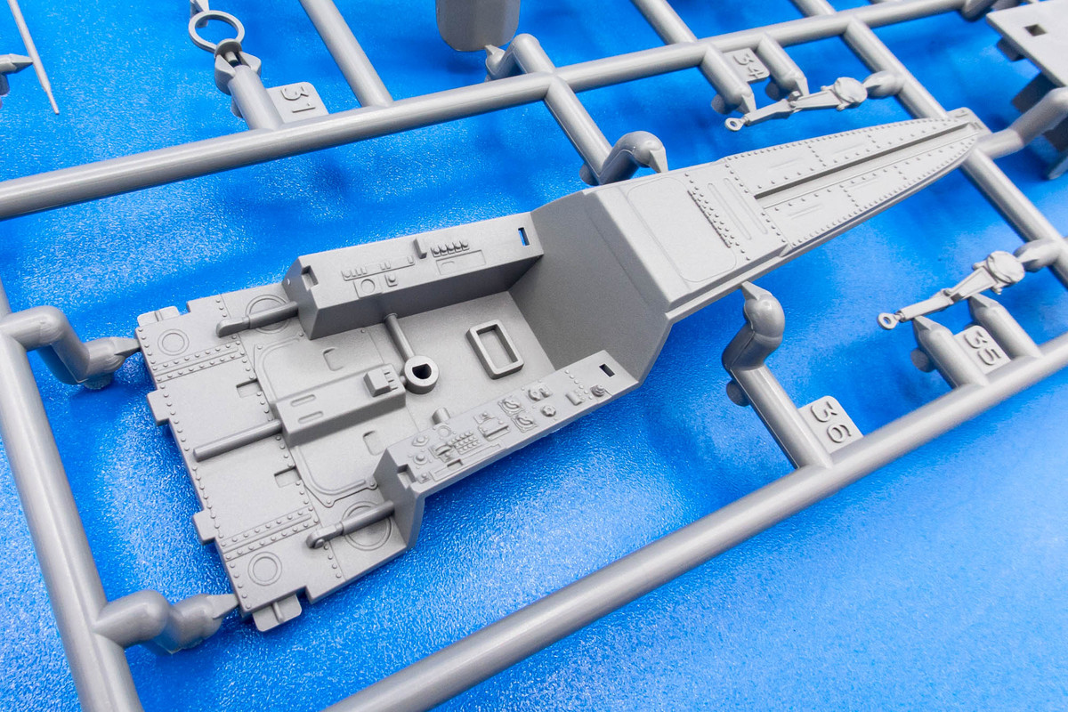

Sprue G has cockpit components and some exterior stuff like the one-piece prop.
Great detail on the prop hub!
Details on the cockpit tub are excellent too.

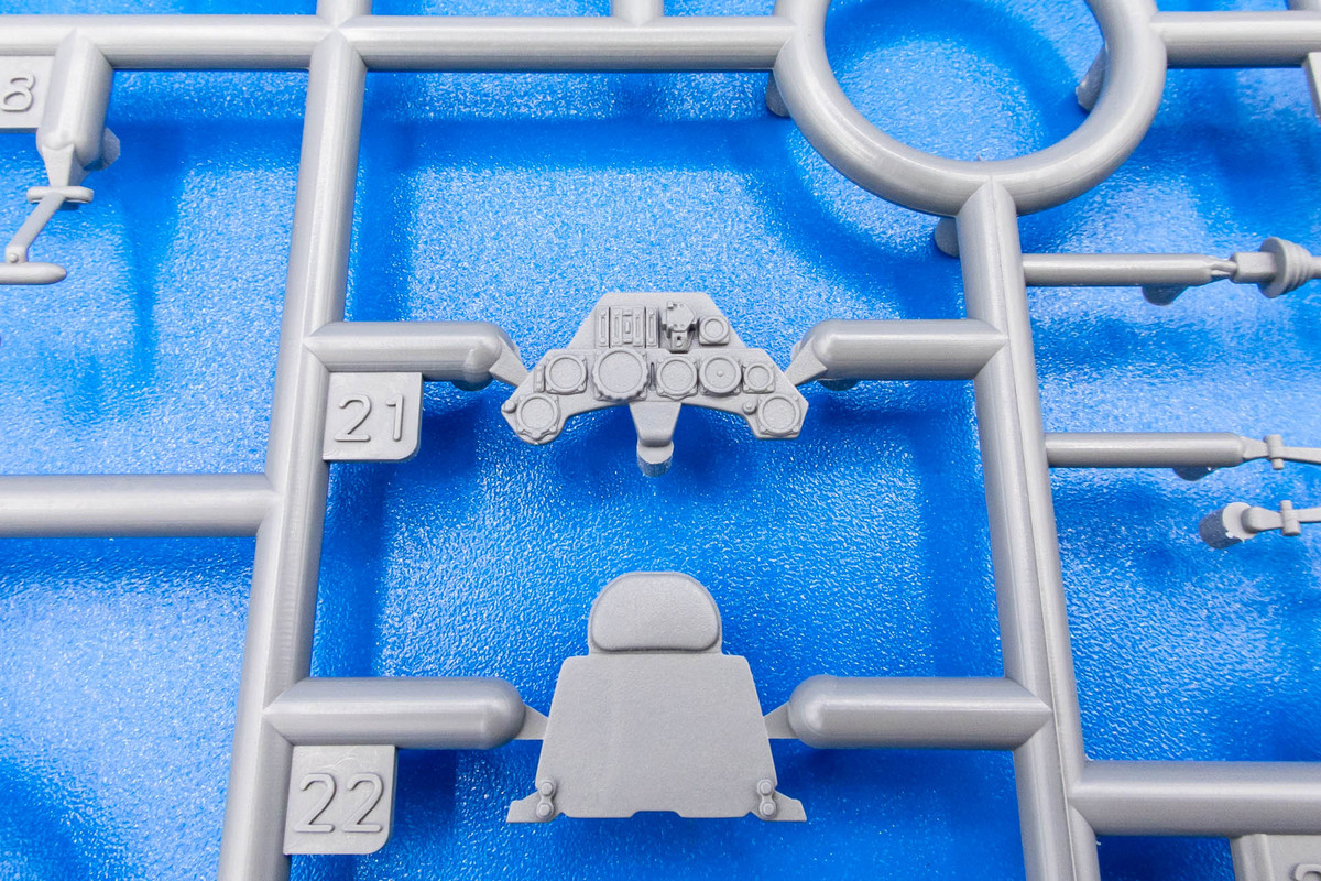

I really like how Border molded the upper instrument panel.
Better than the noticeably softer version that Zoukei Mura provide on their 1/32 Ta152 kits.

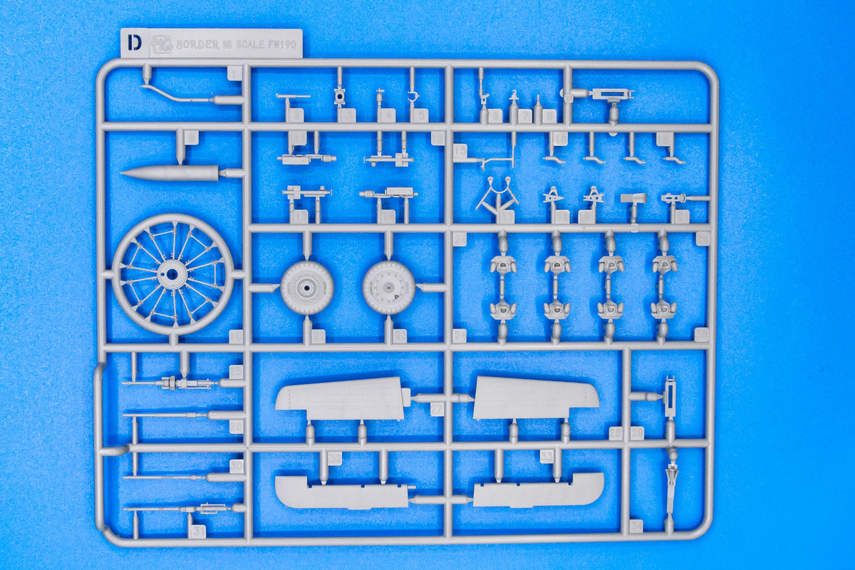

Two copies of Sprue D are provided.
I love the extra detailing on the engine parts.
Only one style of wheel/tire is provided.

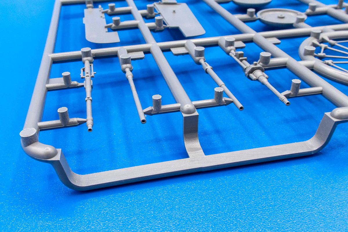

Due to the slide molding technique used, the gun barrels are round in cross-section and have hollowed out ends.

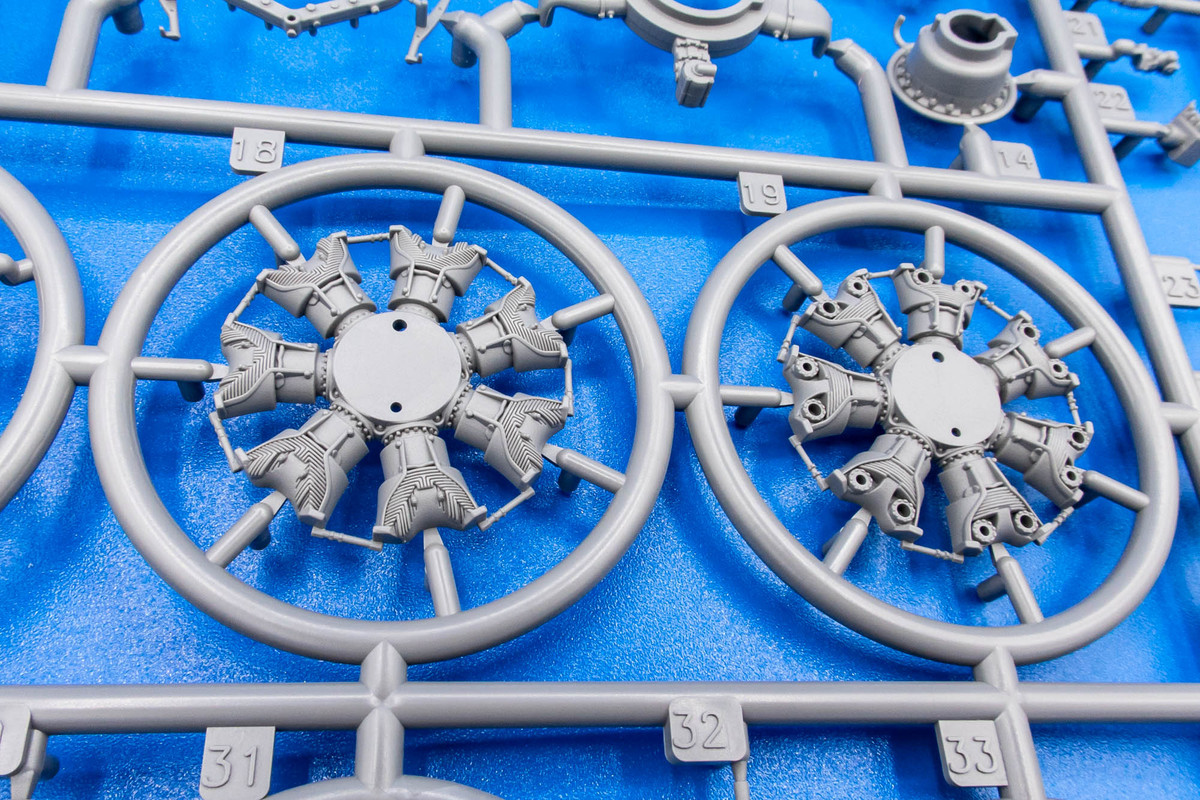

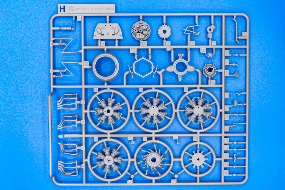

Sprue H has most of the engine components.
The BMW 801D is beautifully rendered.
Unlike previous Fw 190A kits, there is considerable engine detail behind the cylinders.

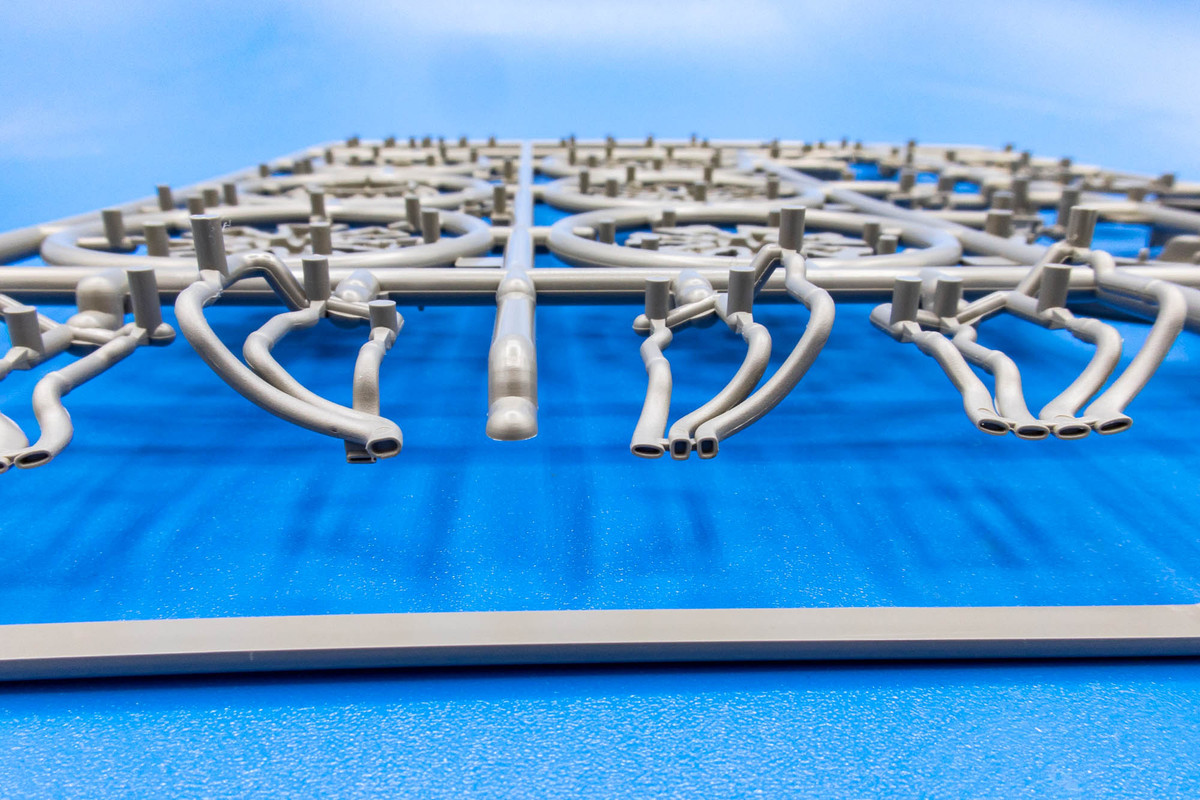

Another example of using slide molding to add hollow tips to the exhausts.

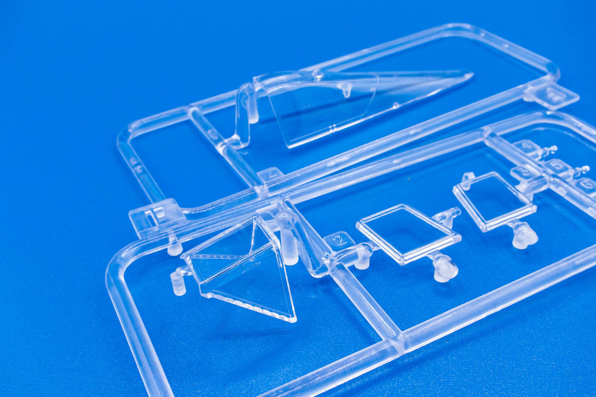

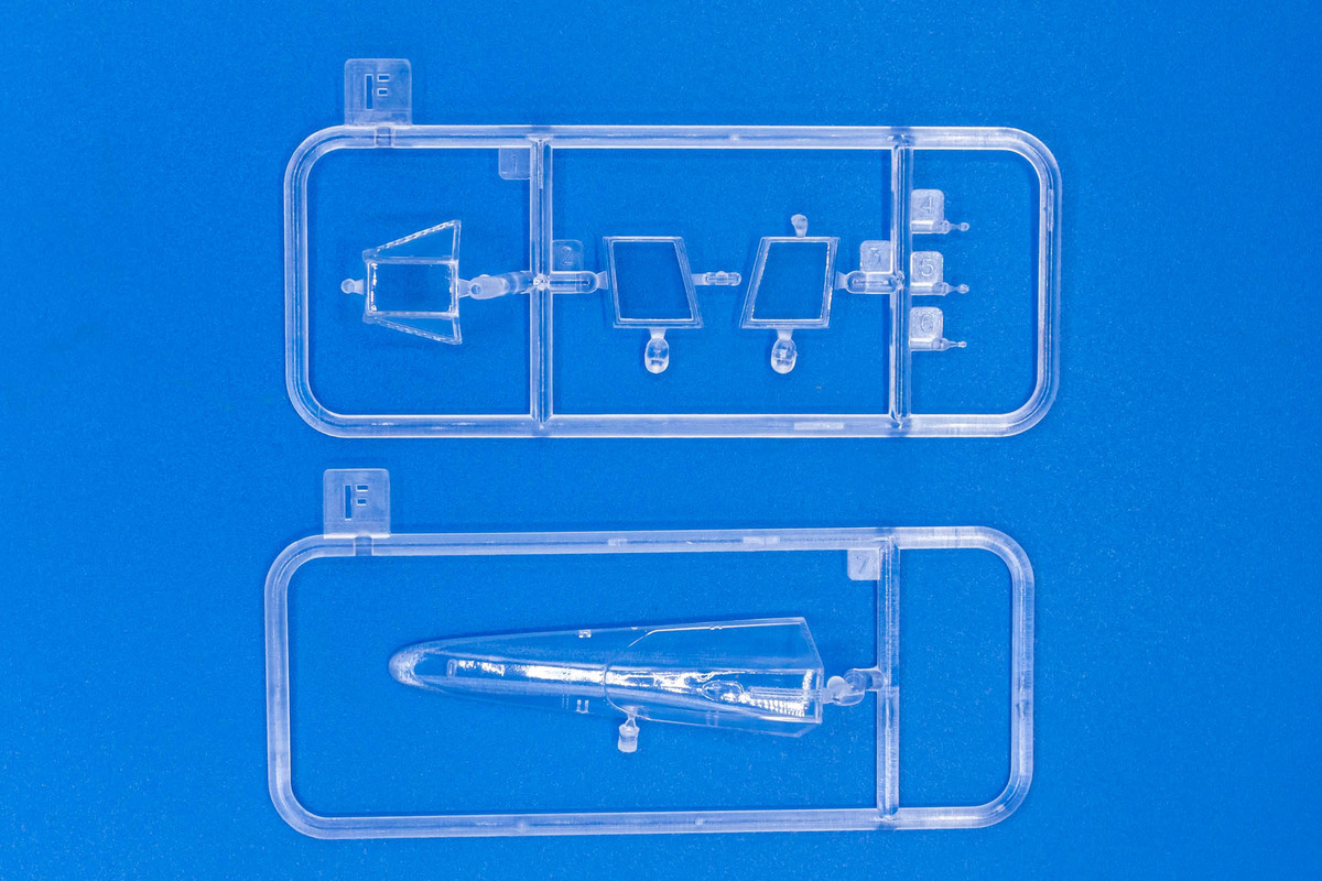

The clear parts are thankfully clear, which didn't seem to be the case on some early production samples.

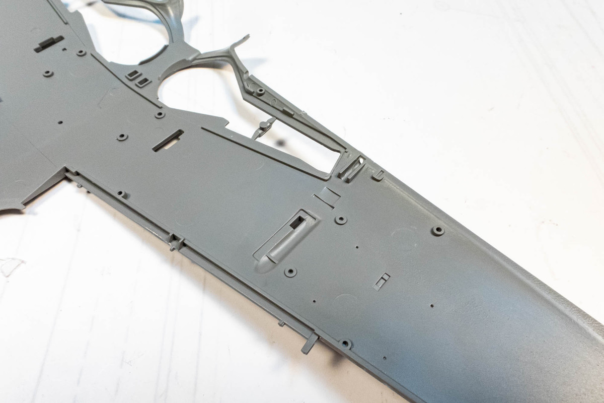

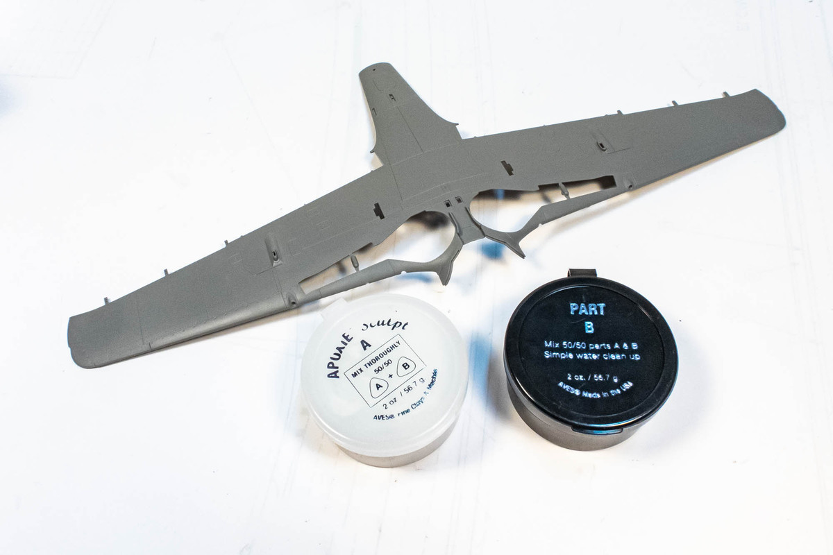

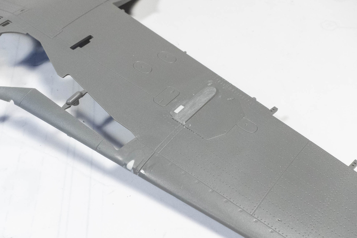

With the sprue tour out of the way, I can show you what I've started on. As I mentioned before, Nowtony's Double Chevron does not appear to have the outer guns. And I don't see any indication of the bulges that would be associated with either the A-5 or A-6 wing. The Border kit has the outer guns with the A-6 type covers with bulges on the wing bottom.
My approach, right or wrong, will be to remove the outer guns, flattening both the wing panel and the barrel fairing on the leading edge. So first, I'm going to fill in the recesses with putty. I couldn't find Milliput at my local hobby store so I opted for Apoxie Sculpt, which is a similar 2-part epoxy.
The depressions for the wing bulge and leading edge fairing were filled from the inside with putty. Once this is dry, I will begin grinding the bulge and fairing down. Of particular note on these photos is the visible grain of the plastic. The surface of the parts has a subtle but distinct pebbly grain to it. It is not perfectly smooth. I don't think this will be an issue after a few coats of paint but it's worth noting.

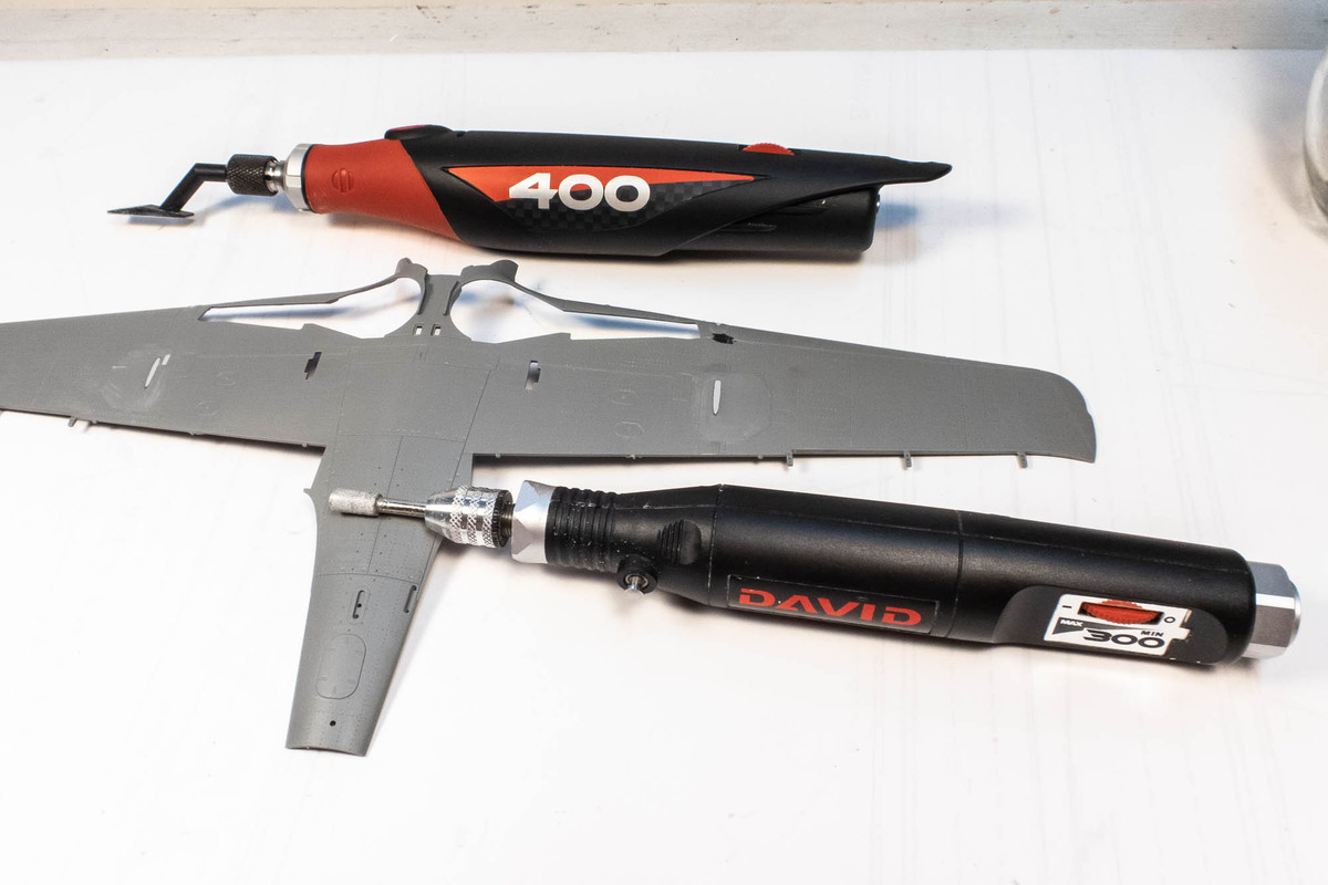

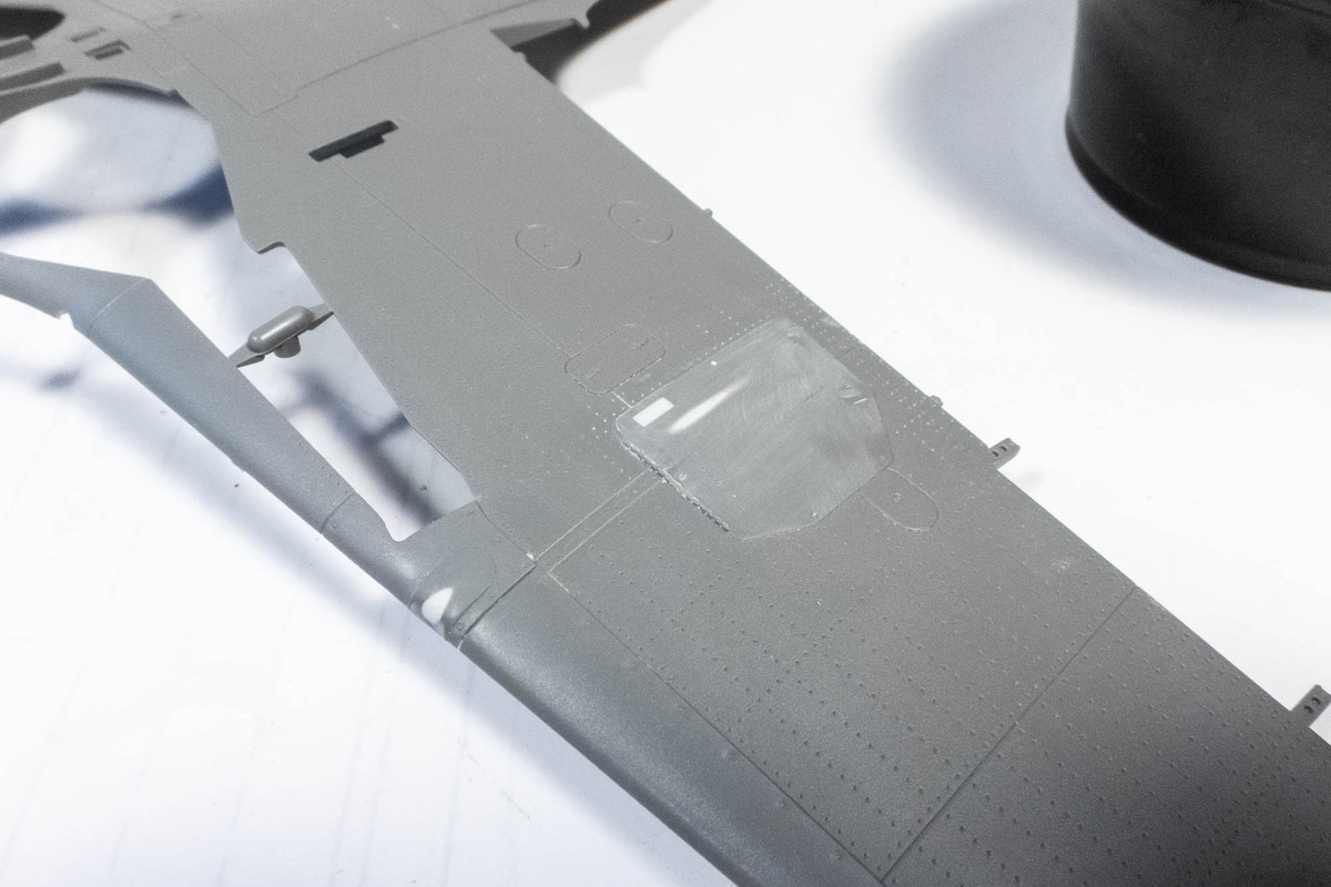

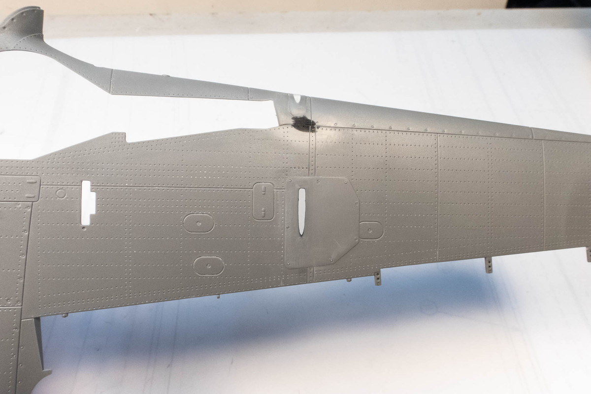

After the Apoxie Sculpt has cured, I can start grinding down the gun opening fairing and gun panel bulge using a rotary tool and power sander.
I took it nice and slow and tried to be careful but still managed to gouge out a small area behind the gun fairing inadvertently.
So I had to fill that area with Black CA, sand and re-scribe.
For this type of work, it helps to have the right tools. The David Union D300 rotary tool quickens the grinding process and the D400 sander helps keep the work surface nice and flat.
Here are the two wing gun positions after the grinding/sanding process.
A light spray of Mr Primer Surfacer 1000 to check my work.
