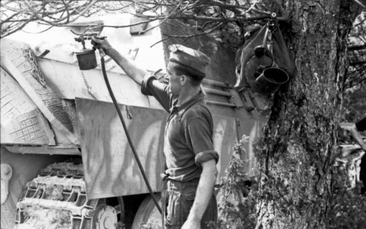

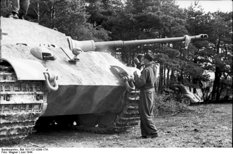

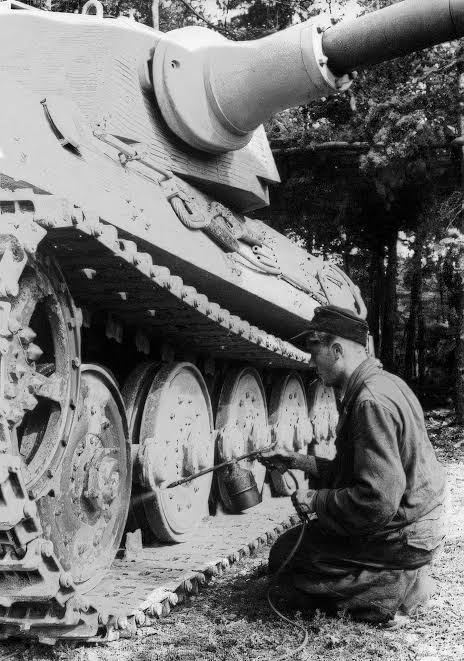

Panther D’s & A’s were painted by the crews in field conditions. The camo was usually sprayed on using compressors and in whatever manner that worked for the situation. Unless you’re doing a field applied brushed on scheme, there is no need for a hard edge or masking. It wasn’t until later when the Panther G variant was in production that hard edge factory applied patterns began to be applied in Autumn of ‘44

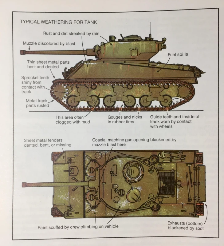

Here is a guide for basic armor weathering
Re: Panzerkampfwagen V Panther Ausf. A
Great reference pics on scuff marks.
Not going with hard edges but I will experiment with a sponge on spare turrent. Don’t have special weather stuff for oil/fuel spills.Then again, there are Zimmerits on hull sides. I imagine one can concoct something using paint thinned down to water. Don’t have anything to stimulate mud on lower hull behind road wheels, so I’m not going to worry about that too much. Shiny spots on sprockets and teeth I can do.
I’ll see what I can do and skip on. Not going to go crazy being anal about weathering to extremes. I’ll keep it simple to my liking.
