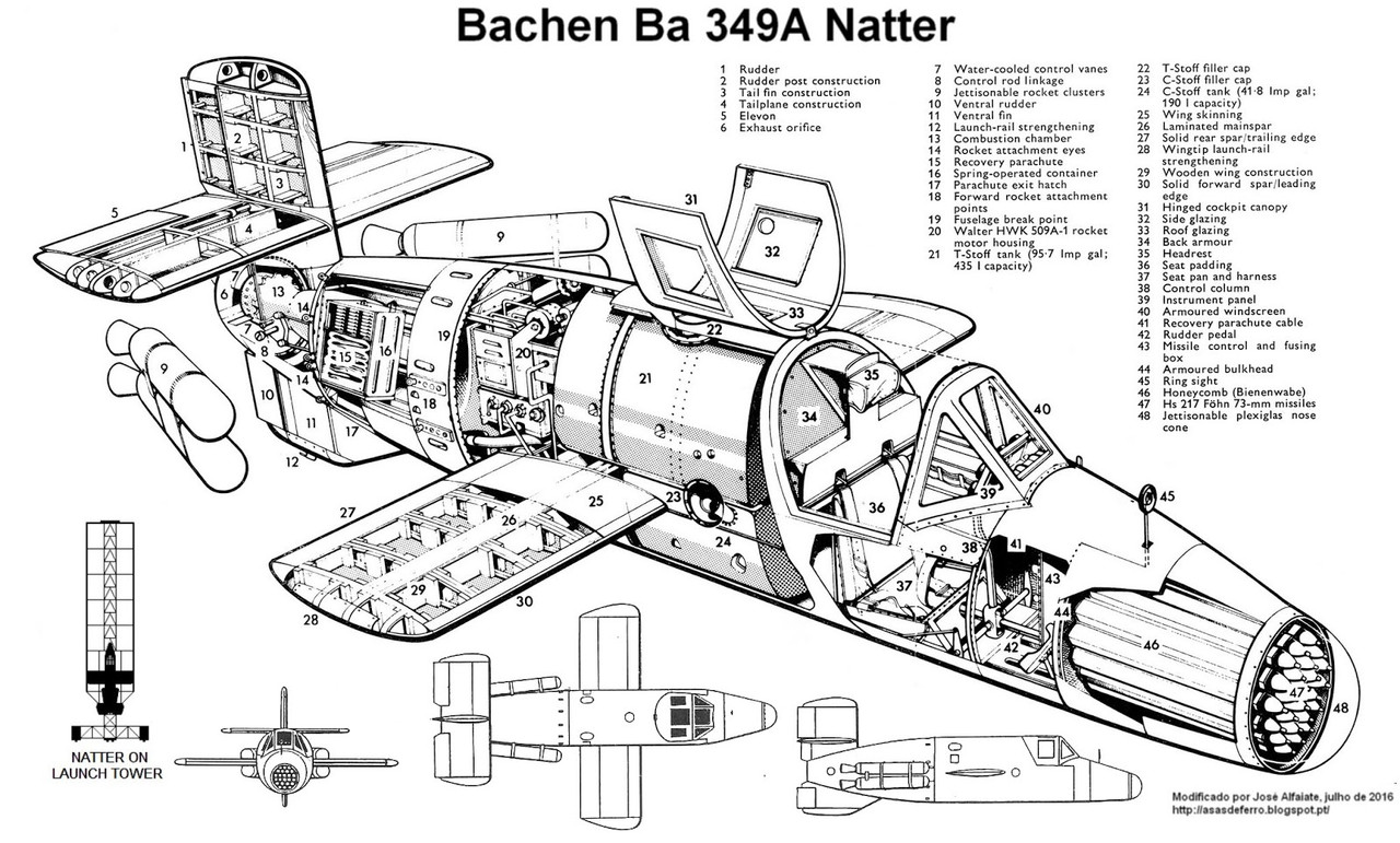

Your work is beautiful! I wanted to ask why there are no rocket clusters (9 on the illustration)? Is this perhaps the difference between 349A and 349?
Thanks in advance! Looking forward to the diorama elements next. And thank you very much for your wonderful photographs!

speedgraflex wrote:Your work is beautiful! I wanted to ask why there are no rocket clusters (9 on the illustration)? Is this perhaps the difference between 349A and 349?
The only reason this Natter has no boosters is because I haven't modeled them yet! They're up next so watch this space!
