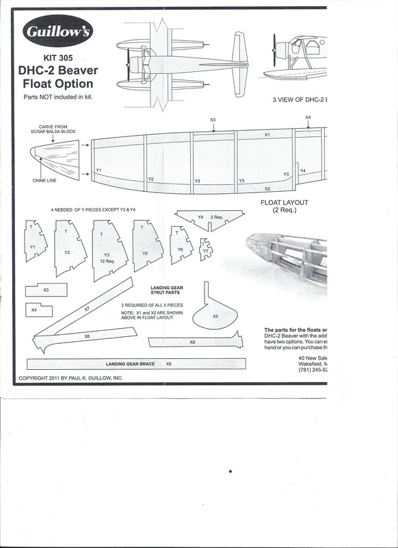

speedgraflex wrote:I did a quick internet peek to see if this was a known issue (dihedral) with the kit and it is. Usually what happens to modelers is one wing is higher than the other which Is not the case here. My instinct based on watching your prior builds is to advise you not to monkey around with this on the airframe but do a test with a good CA debonder on scraps of balsa to see if it is possible to release the areas affecting dihedral. If the debonder releases the CA hold easily you may have a solution. Still I advise caution here. Show the parts you have to carve for the float tips. I am curious to see those. Did you try Tower Hobbies for spare parts? Thanks in advance.
here you go....I cut the wing struts loose with and was able to get them in a much better position. Think that will be good enough. Float plan is below!
