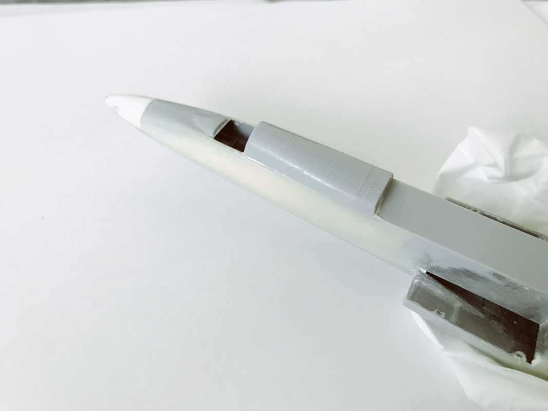

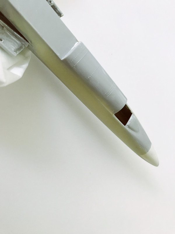

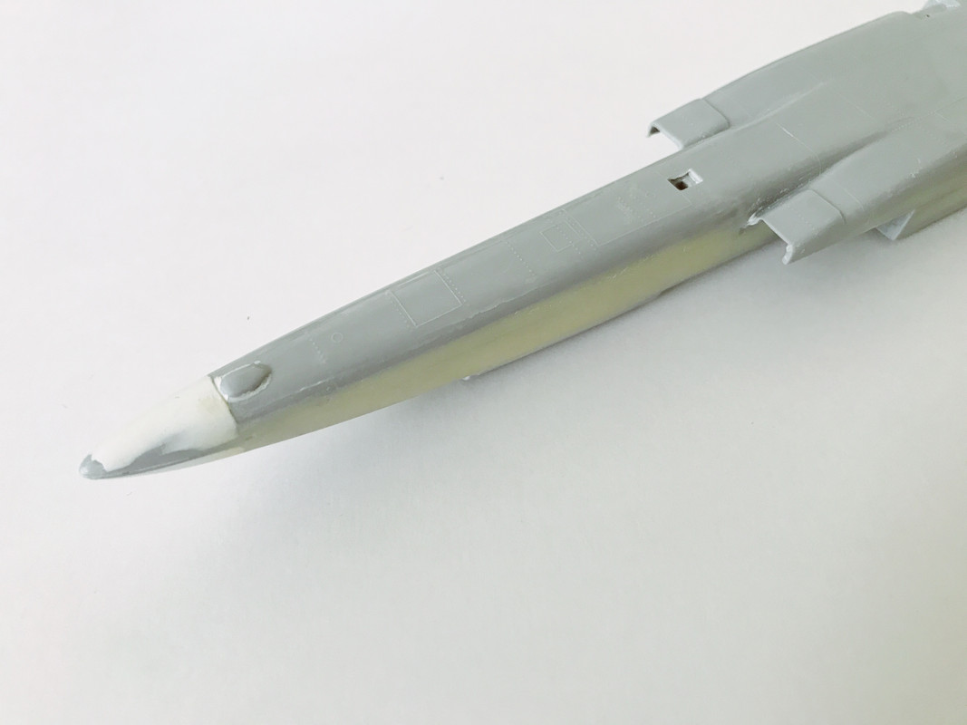

Thank you, Gents—and welcome aboard Mustang Joe. I am pushing to get this one out the door right quick—and perhaps pushing too hard. Shortly after I took the shot I took apart the wings and tail, to start working on some scribing. There was just enough pressure in my grip to launch the fuselage into the air and against the wall. Nothing cool like stabbed into the wall by the point end, but I definitely broke the seal between the top and bottom halves and knocked the sculpted base I made for the pitot tube off completely. Fortunately this accident caused a clean enough break so I sanded and redid the shape, glued and puttied the sides—with the caveat that I would probably do pencil scribing and not sharpened point engraving. This took my Sunday evening to complete, but I believe I am 90 percent back in business. Maybe 95 percent.

The seam lines are faired in together perfectly.
