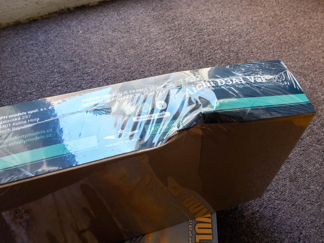

I ordered this kit from the new Squadron mail order company. Good to see them back in the game.
The kit box had a nasty crease in it but I didn't see any damage within.

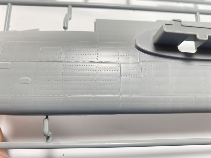

The panels lines are recessed. The rivets are represented as small holes but in addition to the holes, the rows in which the rivets reside are subtly depressed furrows. It's not apparent from all angles but when visible, the pin-cushion effect reminds me of a bed mattress.

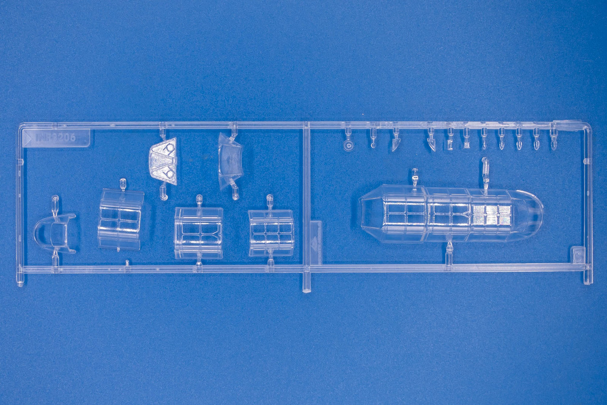

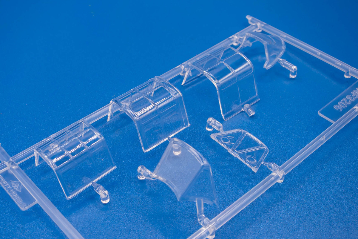

C stands for clear and the two canopy versions (open and closed) are represented here.

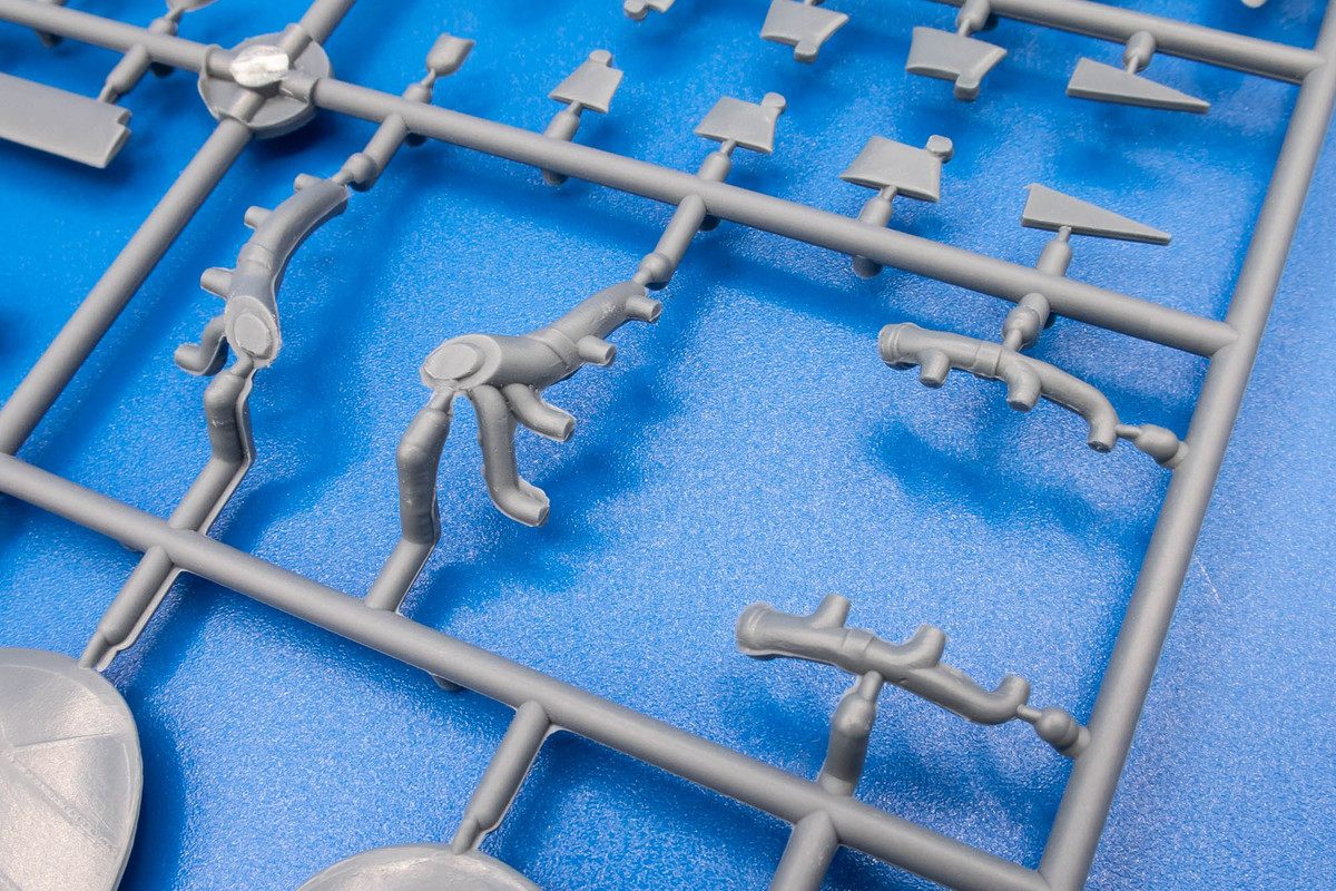

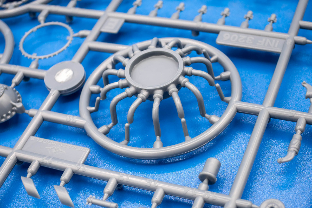

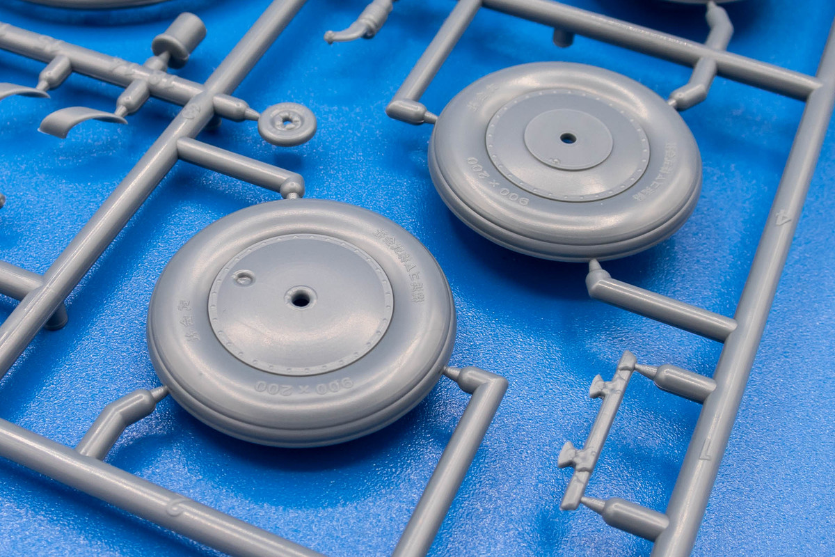

Moving on with the sprue tour... Sprue E holds the bigger engine parts as well as the wheels.
Again, the molding looks sharp but there is also some flash evident. The wheels are unweighted but they have molded sidewall detail and the hub separation is very definite.

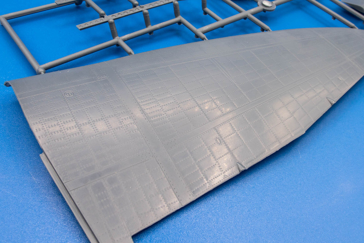

The final two sprues, H and I, hold the wing parts.
The oil-canning effect is very evident on the wings.
It's just a matter preference and not all manufacturers are choosing to show this type of effect. Case in point is the new 1/35 scale Fw 190A-6 by Border. Border has chosen to depict the flush riveting as small holes but without the oil-canning.

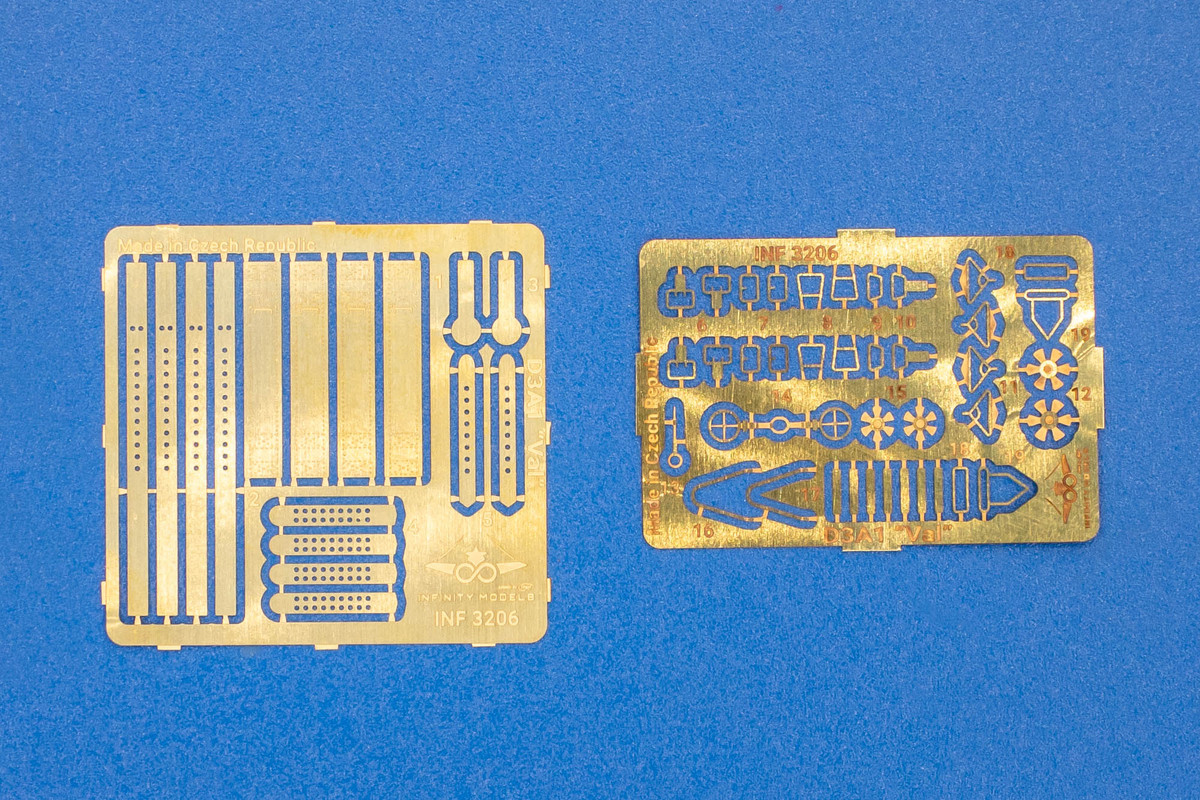

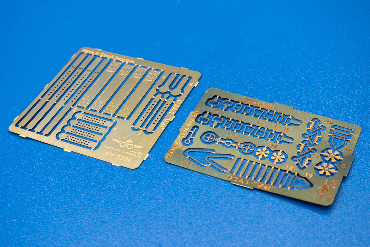

Infinity provides couple of small PE frets for the seat harnesses and other small details.

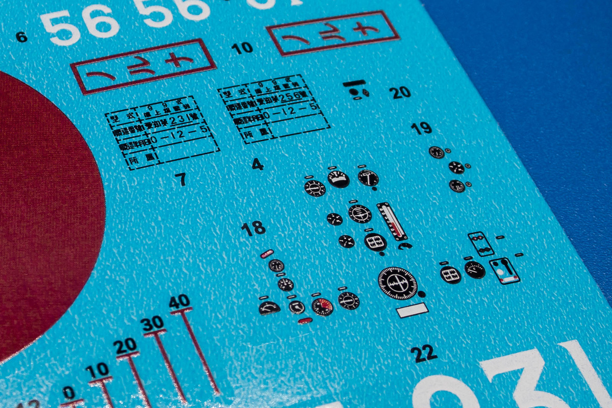

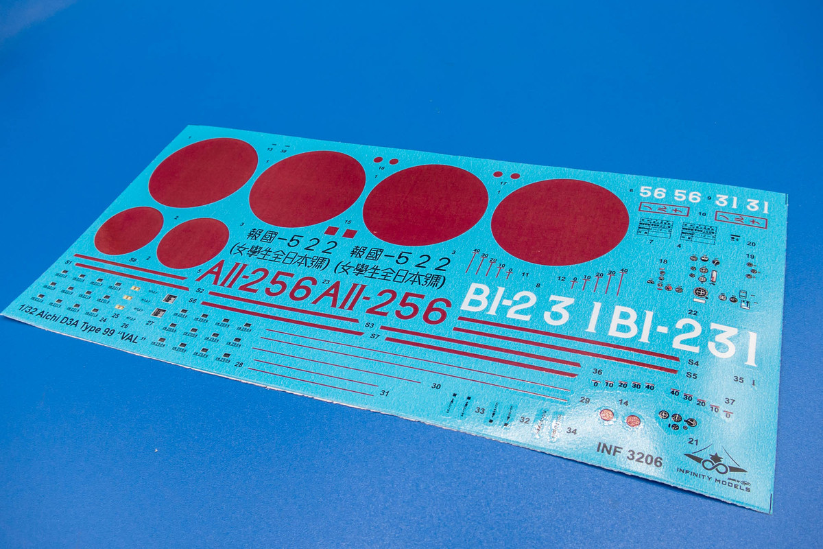

Two marking choices are provided on the decal sheet, both from the Pearl Harbor attack.
A close-up of the instrument panel decals show good details and registration. Might be able to get a good result with these.

Oil-canning refers to the distortion of metal panels on real aircraft. Stressed skin is another term for it. Certain manufacturers are starting to incorporate this effect into their models. A recent example include the Border (formerly Wingnut Wings) Lancaster kit.
Presumably to mimic the effect seen on the restored Lancasters still in existence.
The new HK A-20G kit also has it.
I don't have either of those kits in hand and won't give my opinion on them but I thought Infinity Model's attempt on the D3A1 kit is too heavy-handed. Too regular. There are uniform depressions along each rivet row and to me, it just looks like upholstery or furniture cushions. My opinion only.
I personally don't like the effect and I am going to see what it looks like if I remove the effect.

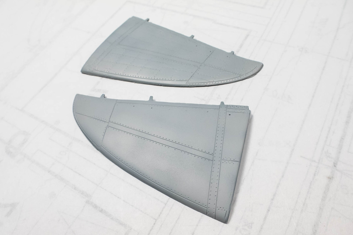

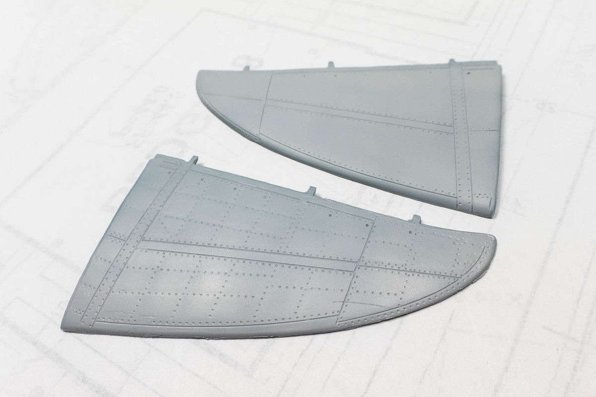

Initial test of the rivet-removal procedure on the horizontal stabilizer. The rivets are filled with black CA glue and then sanded. I chose to leave the rivet rows closest to the panel lines intact. Just for some additional surface detail and to help prevent me from sanding the panel lines away.
Can't really tell what the difference is until a coat of primer (Mr Primer Surfacer 1000) is sprayed on both parts. This tells me that a coat of paint on the kit parts will reduce the oil-can effect somewhat but not enough for my tastes so I'm going to keep on this track.

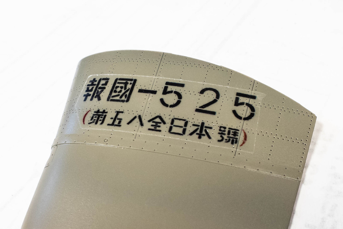

I've also made an attempt at printing my own decals. This might be handy for markings that are too fine to mask. Since my Color Laserjet printer cannot print white, I can only do certain types of markings. I picked up a couple of sheets of clear Experts-Choice decal film from Bare Metal Foil. Using a JPEG image of the markings I found on the internet and scaling them to approximate size, I printed them. The decals were sealed with a couple of light coats of Tamiya Lacquer Clear (LP-9)
The decal is cut from the sheet. Reminder to self... use a sharp x-acto as you do not want the cut edges to be wrinkled, which can happen if you use a dull blade.
The decal is then applied normally. I used Micro Set underneath and Micro Sol on top.
The decal conforms nicely after the Micro Sol step.
Decal after a flat coat. There is a bit of raised edge along the clear carrier but I think I can reduce that in the future by cutting the decal more carefully. Overall... I think this will be a useful technique to have in my back pocket.
