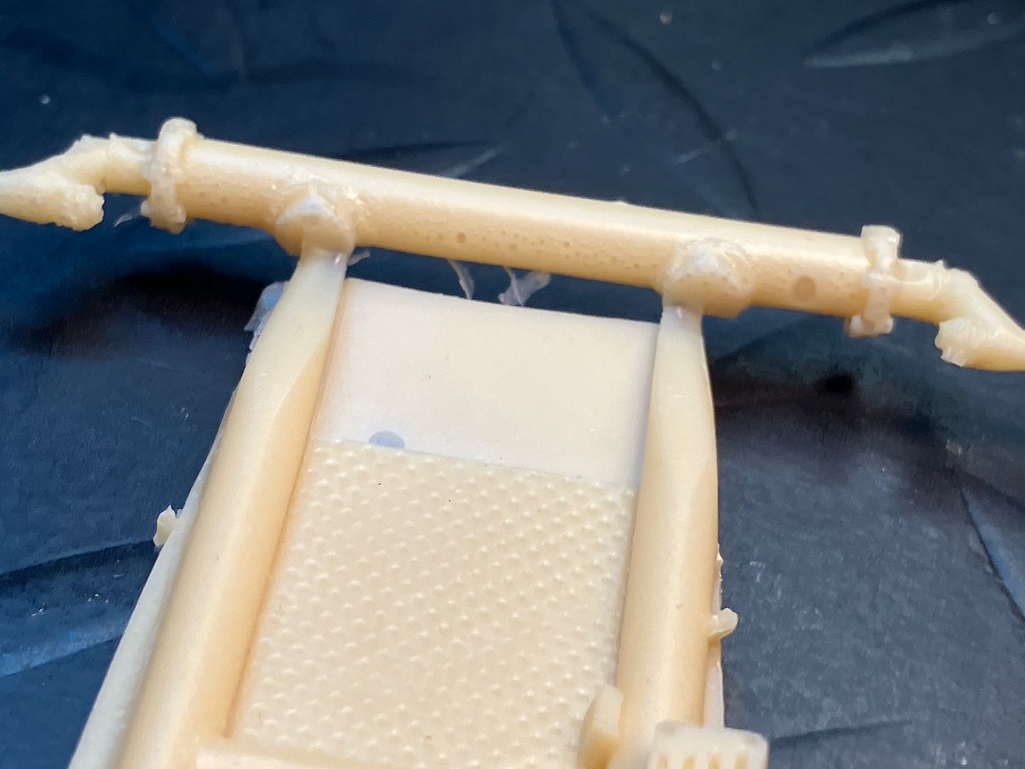

Some shots of the body sections. One can see a lot of flash in some places; I need to wear a dust mask when sanding or grinding that resin, correct?

The assorted small parts all have thin flash around them. What is the best way to cut those parts away from the sheet surrounding them? I suspect they are quite fragile, but I'd like to avoid beginner's mistakes if possible.
The V16 engine is fairly well detailed, with those very cool metal pushrod-tubes cast into it. The Roots-type supercharger and carb aren't that great but I think they'll be okay. The exhaust headers are cast together, for each side, and will need drilling out. Again, I have to ask, how do I clean up those exhausts pipes without breaking them?!?

The seat: you'll notice two "sink-holes" at the top. Can I use any sort of filler, like Bondo or Mr. Surfacer, on resin parts?

I would use a respirator, not just a particle mask. Seem like I saw/read that somewhere. Resin dust is bad ju-ju.

For those wafer thin sections I score them with an exacto knife and crack them off. A JLC saw with the very thin blade is also useful. It takes a light touch with those fine parts, As much as possible I score and scrape instead of sanding. For thick pour blocks I use the band saw. This kit is from the earlier generation of resins and will be more work than a more recent kit.
