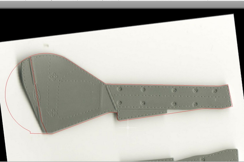

And here's a scan of the Border 190A wheel wells.

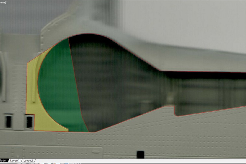

Looking closely at the Border landing gear covers, you can deduce what happened when the inner doors were deleted. The covers were slightly extended. Placing the outline of the wheel well opening onto the landing gear cover and highlighting the line between the old gear cover and extended version, I have rough mock-up of the inner landing gear door IF the wheel well openings were not modified.
Looking at the restored A-6, we can see that rear edge of the wheel well is straight as it approaches the inner doors, presumably all the way to the ammo chute. Incorporating this information onto my scan of the wheel opening, we can define the approximate limits of removal in yellow. Yellow area + green area gives us the shape of the inner door that approximates the shape I see in the Airframe and Miniature plan view.
Obviously, this would be simpler if I had caught this before assembly but now I have to consider what's already in place and work around those limitations. The straight cut at the back edge of the wheel well to the ammo chute looks relatively simple, with no major obstacles.
But modifications to the front edge of the wheel well opening will be restricted by the wheel well cover so I probably won't be messing with any major cuts there.

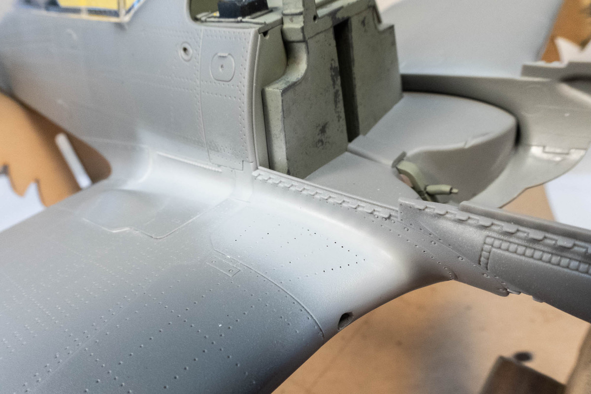

Prior to discovering the inner cover issue, I had glued on the horizontal stabilizers as well as the wing ailerons.
Iterative applications of Mr Primer Surfacer 1000 to fill the multiple seams in this area. There are some subtle "ghost" seams that still need to be addressed but the majority of the fill work is done.

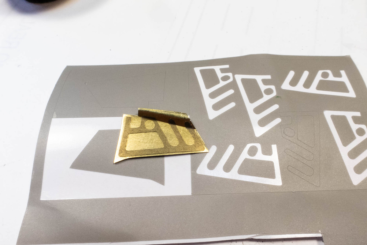

At this time, I decided to try a mock-up of the inner gear door using brass sheet and Oramask 810 masking material. The drawings I showed in my previous post were used to create a mask of the door outline. The mask was placed on a sheet of brass and sprayed with Mr Primer Surfacer 1000. I now have an outline of the door and is easily cut to shape using a pair of scissors.
I rolled the base edge of the brass door on a toothpick to get the curvature. The internal detail on the interior of the gear door was replicated in CAD and multiple masks of this pattern were printed out. I used two copies of the mask, exactly on top of one another to create the raised detail.
The door was sprayed with Mr Primer Surfacer 1000 and then RLM 02 Green Grey. This proves to me that I can make an acceptable door but I'm going to play around with this a bit. The brass prevents me from adding rivet detail to match the rest of the model so preferrably, I'd like to use sheet styrene.

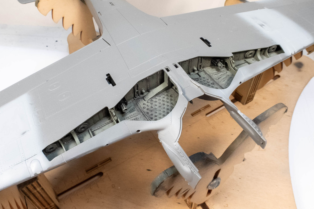

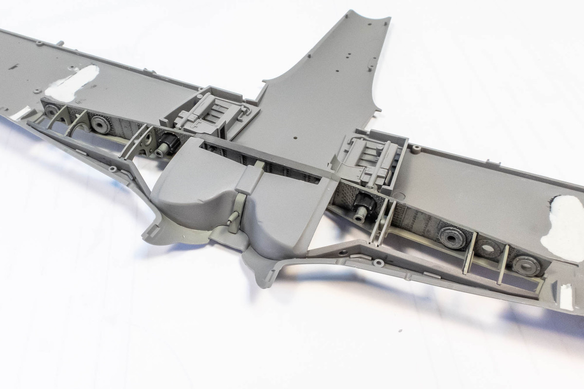

Since I'm pretty confident that the doors are do-able, I've gone ahead with the surgery on the wheel well openings. Due to interference from other internal parts, I had to stop short of my planned cuts. But I think the major visual cues are present and that's about the best I can do.
The main landing gear covers have been cut along the extension line.
